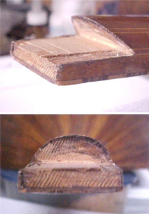

Surviving lutes from the 16th/17th C have necks with a core of light but strong and stable wood (usually Poplar but also Lime wood, Spruce or Fir)
veneered with a hard wood such as Ebony. As far as I know ouds were once made the same way. A solid neck is of course easier and cheaper to make so is
likely to be the modern standard among many oud makers.
Lutes were also made with the fingerboard thicker at the nut end than at the neck joint - to allow the fingerboard to be shaved down for action
adjustments. This adjustment can also be achieved by removing the finger board, shaving down the neck and then re-fitting the fingerboard. I have used
both methods.
The attached images show the neck construction of an old Egyptian oud (late 19th/ early 20th C?) that I own. The neck core is a softwood - Spruce or
Fir (?) - veneered with the same woods used for the bowl. Veneer thickness is about
2 mm +. The fingerboard thickness tapers from about 2.5 mm at the neck joint to about 1.5 mm at the nut - indicating that at one time in the past the
action may have been adjusted by shaving down the fingerboard.

or main point of reference. That should be a straight line, even if the face dips down in that area.
So if that area is a straight line, what should the ideal neck angle be?
Please note, this is obviously not to scale!
Posts: 3404
I like this subject very much. I am willing to pitch in my 2 cents.
I think there will be a range of acceptable combinations here. We can discuss their theorical feasability but in the end we also need to use our
experince in playing this instrument and rule out the combinations that, yes may work on paper, but wouldnt be comfortable to play or would put to
much stress on the materials used ( a 10cm high bridge is out of the question, right? RIGHT?)
Some questions remain though,
- What is the ideal string height on the bridge? Here again there is a range of acceptal combinations (between 0.7 cm to 2 cm)???
Of these potential string heights on the bridge what height provides the optimal playability and optimal sound production? I am not a physician but I
think the tension / torque on the soundboard goes up as we move the strings higher on the bridge.
With that ideal bridge height a constant, we can determine the rest of the ideal configurations for the string scale we are using say (60 cm) we know
the neck is 30 cm and we can then determine the combination of angles on the neck which will give us a neck action between (2mm to 4mm)
Now who is good in trigonometry?
Posts: 763
By the way. I have come across ouds in which the necks bend under tension. This depends on neck thickness and the grain orientation.
Posts: 763
Also, another factor that changes the angle aspect is the bridge platform lifting due to string pressure (mostly in fixed bridges).
The top can lift up maybe as much as 1mm-2.5mm as far as I've seen.
