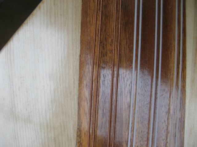

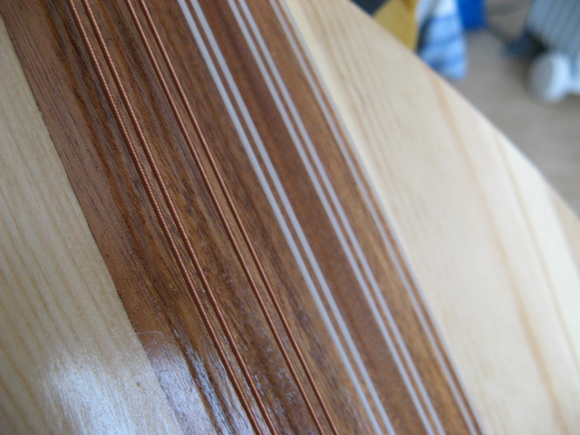

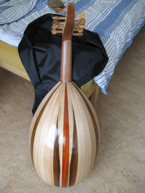

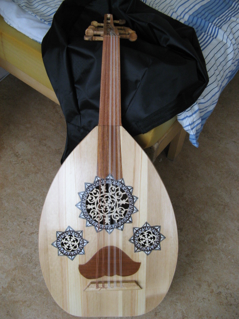

Pictures and Soundfile.
Thank our for your reply Aymara!
I just received my Oud. It is bought from Egypt as mentioned on my first post. It has double strings. I have no musical or instrument experience at all. So I have no idea what strings it has...
I have included pictures in this post. Also an audio recording with open strings.
My question is.. is this a "real oud" or is it meant for decoration? For me the sound is OK but more towards a guitar sound.. It is probably tuned wrong (need help with that too). And is this oud suitable as an beginnner oud? Did I get it for good price? (with soft case).

[*] posted on 2-18-2010 at 03:21 AM
difficult to say how 'good' it is, but it looks reasonable as a beginners oud. you can definitely use it to practice your intonation and risha techinque. once you get into playing and start getting to know the sound of the oud you will probably something a little bit better. but for now - just have fun and mess about with it!

Aymara
Posts: 1162
Registered: 10-14-2009
[*] posted on 2-18-2010 at 04:05 AM
Hi again!
Like every oud ;)
To be precise, the double strings are called courses and arabic ouds usually have 5 courses and a single deep bass string. Egyptian ouds often have only the 5 courses without the single bass string.
For further information about different tunings, check THIS page. Also check the rest of that website for further basic oud information.
Then you will definitely need an oud teacher. Where are you located? Depending on the country, it might be nearly impossible to find one.
Such cheap ouds usually ship with horrible strings. I would recommend ordering good strings like e.g. Pyramid for example, but take care ... you need strings for arabic not Turkish ouds!
That's hard to tell from a few photos and an MP3 file of a totally detuned oud ;) But I'm very sceptic.
I would recommend trying good strings first. And you should take care of the tuning pegs ... cheap ouds usually have problems staying in tune.
This problem can often be solved with peg compound (violin soap) for violins. When you change the strings, you put this compound on the pegs where they contact the peg box. If this doesn't solve the detuning problem, you could put a bit of chalk above the compound on the peg. The soap makes the pegs turn smoothly and the chalk prevents them from slipping. Peg compound usally is hard dry soap without any parfume, which also inherits a bit of chalk.
But you should also keep in mind, that fresh strings need several days to settle, that means, it's normal that they detune fast. But after one week (minimum 2 days) this problem should be gone. If detuning is still a problem then, it's caused by the pegs.
And your oud has a further problem, I often saw on cheap ouds ... the fingerboard is varnished, which will wear out soon, will look ugly and might result in "flat" sounding strings, when gripped (not played open).
But your main problem now is, that you are a totally beginner, who might even need help in changing the strings and tuning the oud correctly ... btw ... I would recommend the most common arabic tuning for the beginning: C-FF-AA-dd-gg-cc (the big C is the mentioned single bass string). And you will need a TUNER and a microphone ... or buy a handheld tuner with integrated mic.
Do you have a friend, who plays guitar? He might be of great help for this first tasks.

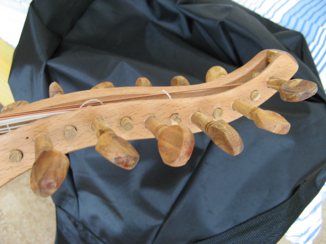

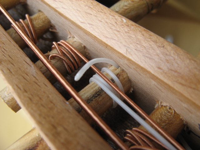

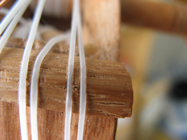

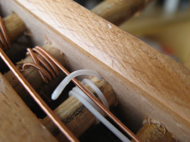

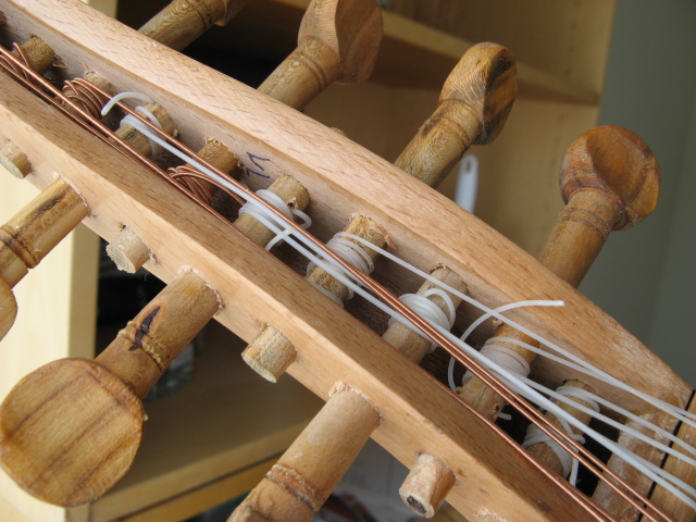

Pegs problem and question about tabs
Hi! I've been reading alot, general about the oud and also some basic music theory (there are good youtube videos for this). And I've also been watching guitar lessons for beginners.
The problem I'm facing right now is not with myself, but with the Oud I have itself. Its cheap and not good quality I know that.. but as a student I can not afford a better oud or oud lessons. But I think its better this why, because I learn about the mechanism of the oud and I'm interested in this as well.
So the problem is that it keeps detuning after a while, and I believe its because two things: bad strings and bad pegs. But it is still possible to tune it and practice notes on it, altough there is an physical obstacle which I noticed very early in getting to know this oud: One of the pegs is prevented from being "screwed in" in order to tighten the string, because of the whole that the string is in the peg (see pictures). So I can not tighten it too much it will get damaged.. problem is that its a bit loose and it doesnt work physically. What can I do ?
I had a question earlier regarding the nut and that "the c-string has gone through the nut a little bit in depth" And was wondering if that was normal so I took a picture on that as well, see last one.
I've been practing to hit some notes and I use the APtuner and fingerboard pdf which was posted in this thread in order to hit the right notes. Its going well and I really take my time and am patient. Whilst I learn music theory.. I have been looking at some Oud Tabs I found on this site: http://sites.google.com/site/oudguitare/lestablatures/listetabs
They seem to work fine with my tuning according to the author of the website. The song I'm focusing on right now in learning, is the very intro of Oum kalthooms "enta omri". But the intro on these Oud tabs doesnt seem to mimic the intro on http://www.youtube.com/watch?v=YeoF74Vu180 which I figured out is started by open strings A and then followed by open string G and then A3 (G-string second fret). But the Oud tabs on http://dc162.4shared.com/download/123377502/f1f59c73/Enta_Omri_02.p... doesnt seem to mimic these notes.
Hope you understand what I mean.

Aymara
Posts: 1162
[*] posted on 2-21-2010 at 05:20 AM
What can I do ?
Consult a violin luthier and ask him to replace this piece of junk called nut ;) ... he also can help you with the peg problem ... he drills a new hole for the string and then you can push it further in.
Also ... as stated clearly several times ... buy good strings! ... and peg compound.
Let's wait for further answers here ... I don't play arabic music, sorry.
Greetings from Germany
Chris
[*] posted on 2-22-2010 at 03:23 AM
If you are handy with tools, and especially if you intend to have it worked on by a pro ANYWAY, take care of it as best you can now. Take out pegs one at a time so you don't mix them up, and very lightly sand them just to smooth them, mainly so you feel better about them and so they are grateful to you. Don't they look nicer now? Drill a new hole for the string on that one. Clean up the pegbox with some fine sandpaper and steel wool. Run a little white very very dry soap and a line of chalk where they meet the pegbox and try to get the pegs to turn and hold, to settle in. It's hard to be sure but they look like olivewood. That's not bad. If you smooth them and work with them, lube very lightly with soap and chalk , you can probably get them to work much better. Are those the original strings? REPLACE FACTORY STRINGS.
http://www.ostriemusicsupplies.com/marioud-ar.htm
It takes a week or so for good strings to stop stretching. It takes weeks for factory type strings to settle, they stretch until they hit the garbage pail.
With the nut as long as the strings stay in place, don't mess with it. One C string a hair lower than the other? If that's the magnitude of your worries, mate, I'd say you're doing fine. It's not a wood-shop beauty contest, as long as it does the job, it's fine for now.
