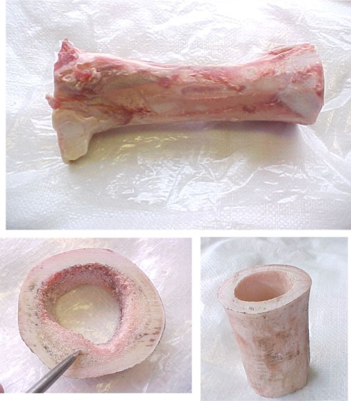

A piece of cattle leg bone was purchased from the local butcher (soup bone) with the large knuckle ends cut off to leave a short relatively straight
section of bone. (I know nothing about bones so was a bit surprised that a leg bone would have been so short in length - perhaps from a young animal?
- however it is a start).
The knuckle ends look promising but are comprised mostly of low density, 'spongy' porous bone structure - no good for making nuts. Furthermore this
part of the bone structure contains a lot of fatty material that must be completely removed if the bone is to be used for instrument work. Even very
small amounts of fat if left in the bone will eventually leach out years later causing damage to the wood of an instrument.
The bone as received from the butcher was frozen hard. However, it was left in a refrigerator for a few days before I could get around to processing
it so the small amounts of flesh attached to the bone were soft and more difficult to remove.
The first step is to scrape off as much of the flesh as possible with a sharp knife then to dig out all of the marrow from the centre of the bone
(soft and easily removed).
I had to cut more material from both ends of the bone to completely remove some remaining pink coloured porous bone matter. I used a metal cutting
bandsaw for this but cutting it by hand using a hacksaw would do just as well.

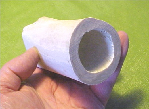

This has left me with a clean, relatively short section of bone
9 cm long by about 5 cm in diameter (3.5 inches X 2 inches). Not much material to work with but sufficient to make quite a few nut blanks.

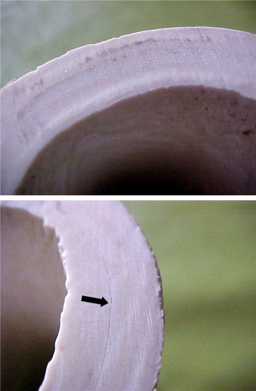

After drying overnight in a warm kitchen at about 50% Relative Humidity a small circumferential crack was noticed on one end of the bone - that I take
to be a shrinkage crack - so the bone has been moved to a cooler place to dry. This makes me wonder if the bone is going to be too soft - immature
bone from a young animal perhaps? The bone cross section seems to consist of 3 layers with a softer layer (?) in the middle, perhaps another
indication that it is immature bone - but I am not sure how cattle bone develops in the living animal. I imagine in a mature beast the bone stops
growing and develops the kind of density and hardness required?
More trials with an alternative bone sample may be required.

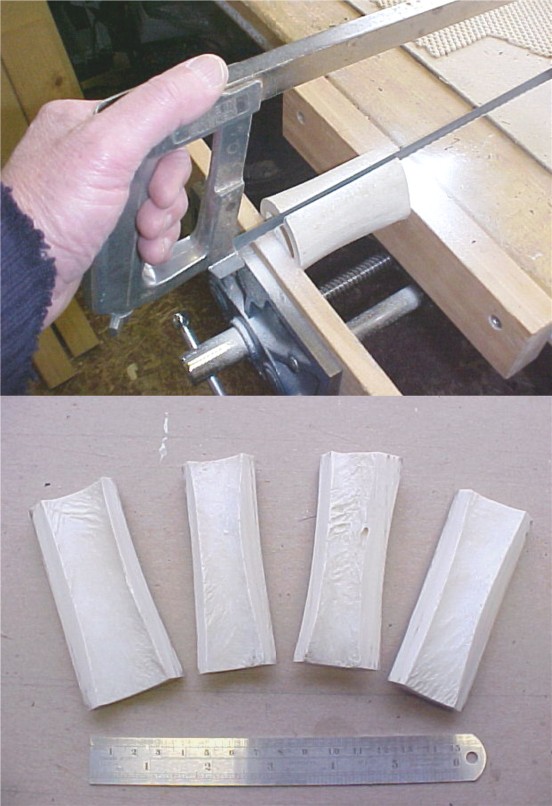

The bone has first been cut into four sections using a metal cutting hacksaw (as the bone is quite hard). The wall thickness of the bone varies from
about 7 mm to 10 mm.

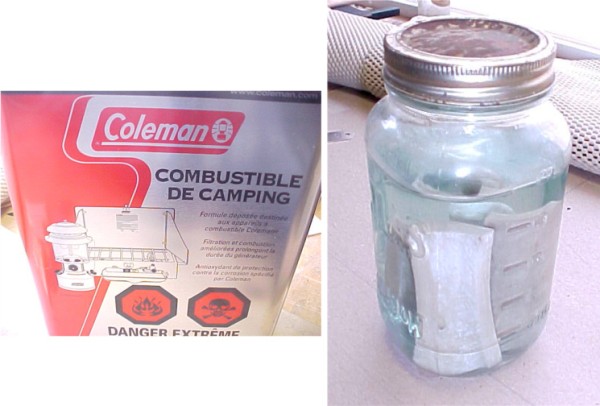

To degrease the bone, the pieces will be immersed in purified gasoline for about three weeks. Purified gasoline or 'white gas' is the fuel used in
'Coleman' camping stoves (no - it is not kerosene!). I use it a lot for degreasing machine parts etc. This is probably the cheapest and safest
(relatively) of the degreasing fluids to use. Ether or Trichlorethylene etc might do as well but are much too hazardous to safely handle around the
home even in small quantities.

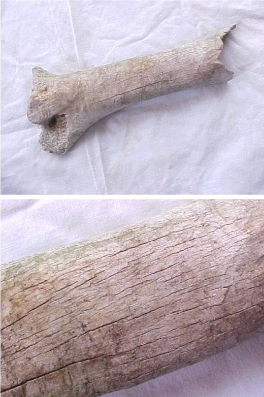

Spring conditions have arrived early in these parts and most of the snow cover has gone.
A quick search at the back of our old farm property resulted in finding three animal leg bones - partly buried in the soil and covered in moss. They
had been there, I would guess, for 50 years or more.
However, on closer inspection, it is clear that these bones are useless for making nuts as the attached image shows. Nature, over time, has taken its
course and the bones are now in a state of deterioration - split and with extensive surface cracking.
So, in order to process bone suitable for luthier material it can now be concluded that the bone should be fresh at the outset.
The freshly prepared bone has been soaking in the de-greasing fluid for 4 weeks so has been removed and cut into 8 narrower pieces. I did this by
hand using a hacksaw with a coarse 18 t.p.i blade. This is safer than using a power bandsaw and eliminates any risk of burning the bone due to
excessive heat generation during cutting.

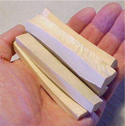

The bone pieces are irregularly shaped but should be sufficient for about a dozen oud nuts with some material to spare for inlays etc. Material cost
for bone, de-greasing fluid etc (but not counting my labour!) - less than $5.
The bone pieces have a thin yellow coloured layer just below the outer surface. Not sure what this is but in case it might be absorbed fat, the pieces
will be immersed in the de-greasing fluid for another week or two.

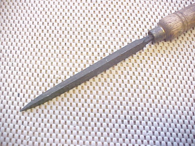

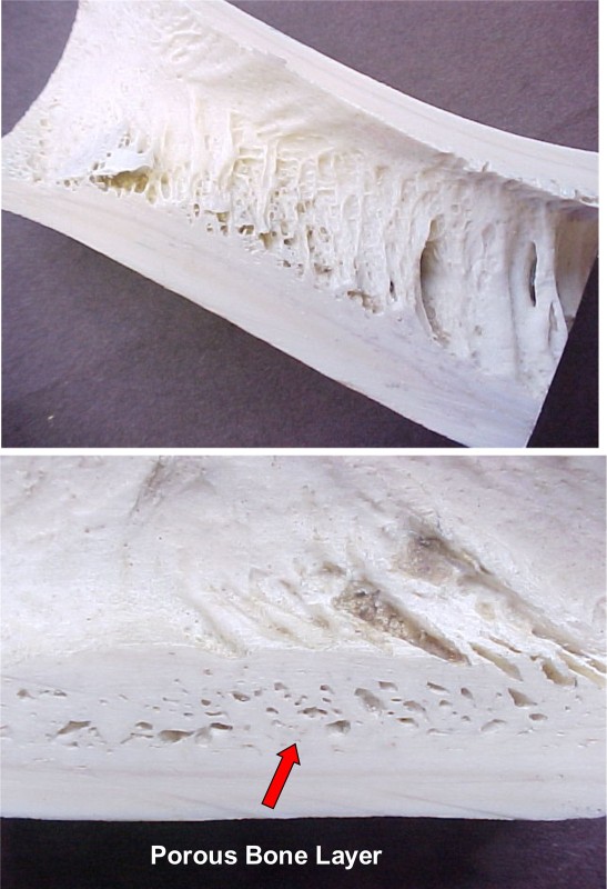

A good tool for cleaning out the central bone marrow and for scraping away tissue from the surface of the bone is a sharpened machinists triangular
scraper. (An old triangular file with the teeth ground off would serve just as well).
Once the bone has been cleaned manually it should be cut open lengthwise with a hack saw. Any spongy, porous bone should then be scraped away as this
contains fat that can soak into the bone and cause problems later. The porous bone can extend quite a way into the straight bone from the knuckle
joint - as can be seen in the attached image. This particular piece of bone has been de-greased but is unlikely to be of much use due to the extent
and depth of the porosity. Unfortunately it is not possible to determine if there is a potential problem with porous bone until the bone has been
cleaned and cut open. (however, at a cost of about a dollar for each piece of bone, the material cost in minimal).

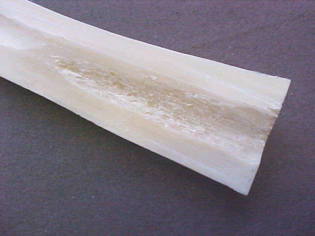

The second image is another example of bone that - after boiling in detergent and water for an hour - was then cut open to reveal a section containing
porous bone. The porous bone has been cut away but some discolouration can be seen due to residual fat. This sample has now been boiled in an Ammonia
solution (household ammonia and water) for an additional 30 minutes to remove as much of the absorbed fat as possible. After drying for a few days,
the sample will be degreased in purified gasoline (camping gas) for 3 or 4 weeks. Time will tell if this procedure will succeed in completely removing
the absorbed fat.
