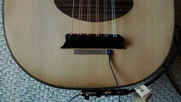

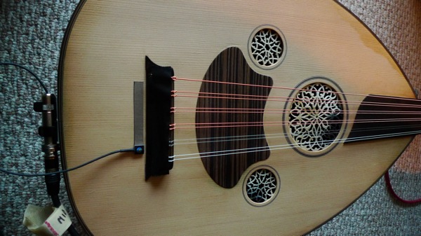

After considerable experimentation, I found a pickup placement which I believe works best with this particular technology (at least, the best for external mounting - subtly different results might result from internal mounting) on my Ramazan Calay oud. I've made recordings of the pickup straight into a Grace Audio 101 preamp (through the DI input), the pickup into the PUTW Line Driver into the Grace DI, and for comparison, the oud recorded with a Josephson C42 small diaphragm condenser mic placed 1 foot away from the oud. Unfortunately, I couldn't make all 3 at the same time, but the mic recording and the sound of the PUTW Line Driver feeding the Grace DI were tracked at the same time.
Here are pictures showing the placement of the pickup on the oud:
oudpickup1.jpg - 61kB
oudpickup2.jpg - 74kB

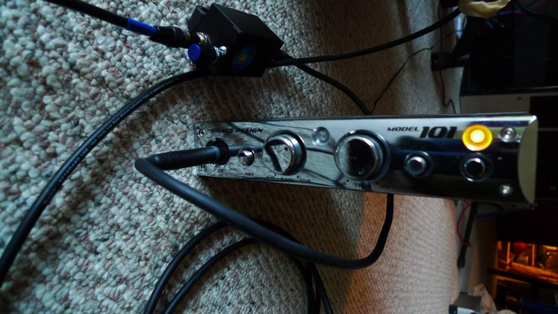

And a picture of the Grace preamp and the PUTW Line Driver
oudpickup3.jpg - 106kB

1. PUTW oud pickup-->Monster Cable 500 series (10') guitar cable-->Grace 101 preamp (50dB gain)-->Mogami cable-->Lynx 2 soundcard (24 bit, 44.1khz)

2. PUTW oud pickup-->Monster Cable 500 series (10') guitar cable-->PUTW Line Driver-->Planet Waves guitar cable (2')-->Grace 101 preamp (35dB gain)-->Mogami balanced cable-->Lynx 2 soundcard (24 bit, 44.1khz)
