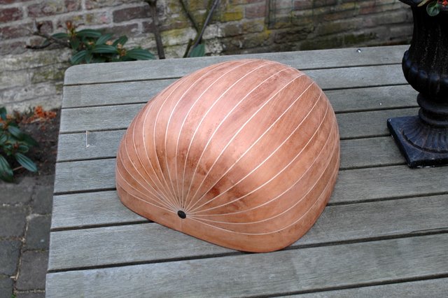

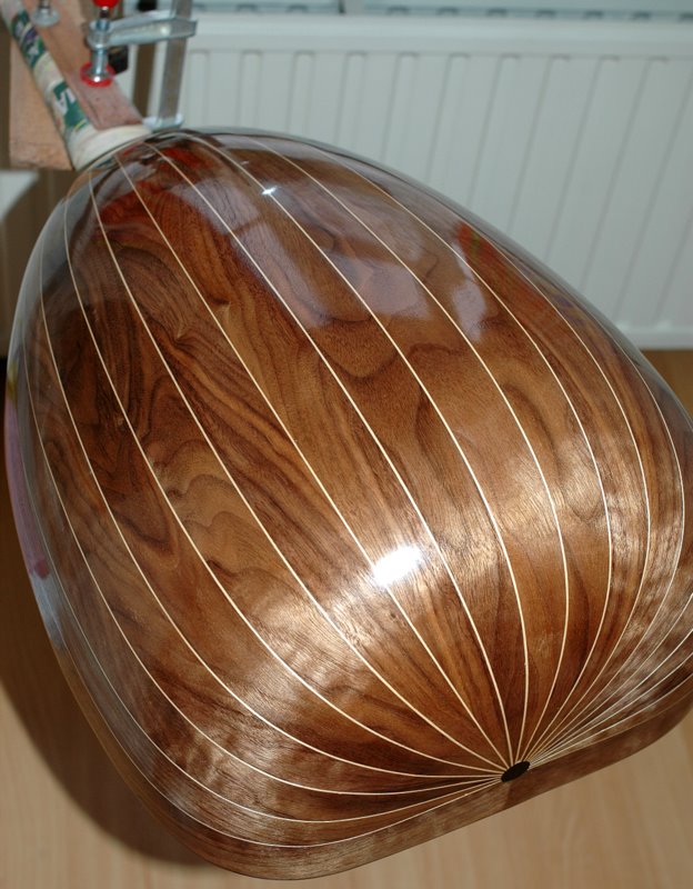

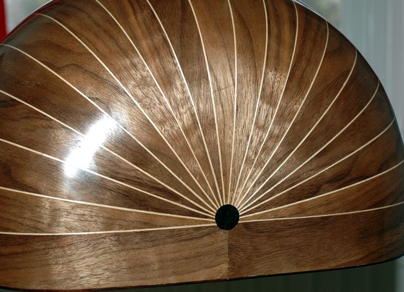

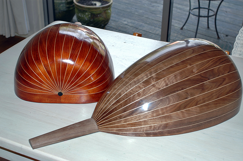

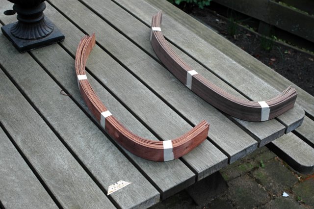

I'm building 4 new ouds from different type of beautiful wood. another (5th) Oud is being build for me in Morocco by My friend majid Atik. it will be (and yes) Brazilian Rosewood.
the first I'm working on is made from Hunduran Mahogany, very rich wood known for its tonality. This oud is for Mavrothi because the oud I sent him before was broken during shipement. the oud has one soundhole, 49cm long and 36 wide and Sitka spruce soundboard. I will post more pictures in the coming days
The second one is made from Amercian Silky Walnut, beautiful patterns and swirls. difficult to work with such wood but the results are worth it. I have also purchased some beautiful flamed walnut that I will build some day.
number 3 and 4 are bent and I will start this week making the bowls, number 3 is Indian rosewood, 4 is Honduran Rosewood: strikingly beautiful.
Enjoy the projects.
DSC_8607-1.JPG - 109kB walnut DSC_8608.JPG - 121kB walnut DSC_8624.JPG - 74kB Honduran and Indian Rosewood ribs
DSC_8619.JPG - 60kB Honduran Mahogany DSC_8613.JPG - 69kB Honduran Mahogany

Hi Samir,
The bowl looks really beautiful. Again, I really appreciate that you are building this oud for me, and so quickly also.
Thank you, I really look forward to playing it.

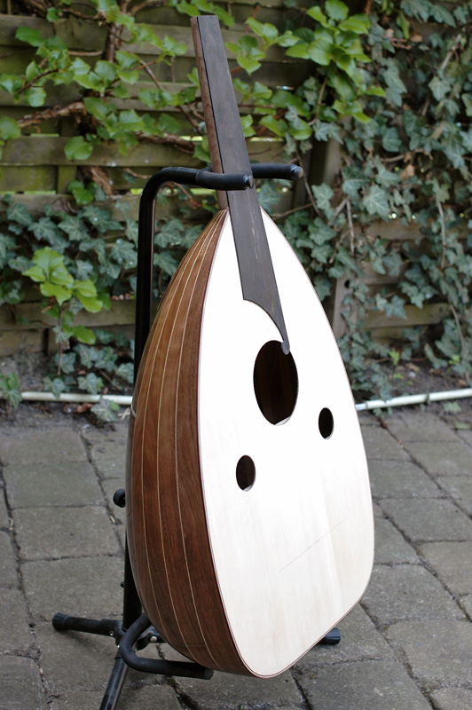

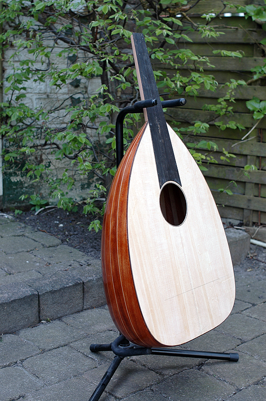

here are some new pictures. the pegboxes will be next and later the bridge. Almost there:)
your oud came out very beautiful,
both.jpg - 502kB honduran mahogany.jpg - 565kB walnut.jpg - 385kB

Quick question. Are the fingerboards on these glued onto the soundboard or inset into a cutout in the soundboard ? How thick a fingerboard do you think can be glued on without affecting the vibration of the soundboard?
sabbassi
Posts: 570
Registered: 4-28-2008
Location: Morocoo
Mood: happy
[*] posted on 4-17-2010 at 11:58 AM
Helo Fernandraynaud,
the fingerboards are glued onto the soundboard and are about 1,7m thick.
this part of the oud does not affect much the sound of the board as the back part does.
by the way a solid ebony fingerboard will add some enforcement (a little but it's there) to the neck to hold his place when pressure is made by the strings.

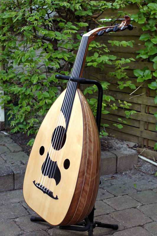

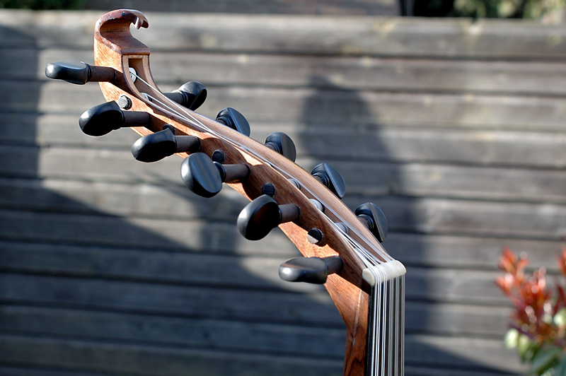

final .
Thank you Yaron and everyone for the nice posts.

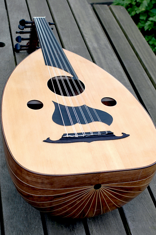

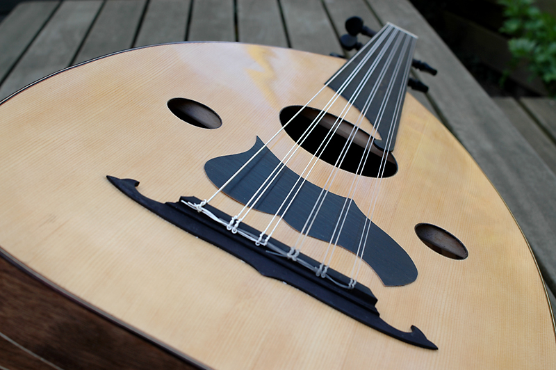

Today I have mounted the strings on the new oud, it is already promissing. I 'have used Labella Arabic tuning:
ff,cc,gg,dd,aa,f
the oud have low playing action. 2,3 at the neck join and buzz free on all strings.
I have used some wild imagination and put a cobra head with 2 black eyes at the top of the peg box :)
I will put a video soon.
Mav: yours is next, I hope to finish it this week.
tanks
samir
soundboard.jpg - 342kB walnut oud.jpg - 494kB

... put a cobra head with 2 black eyes at the top of the peg box :)
Nice ... but the low action is even better :applause:

Thanks chris,
yes indeed it plays very smooth.

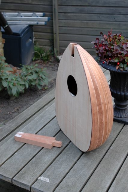

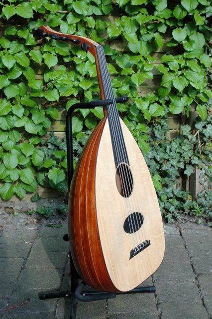

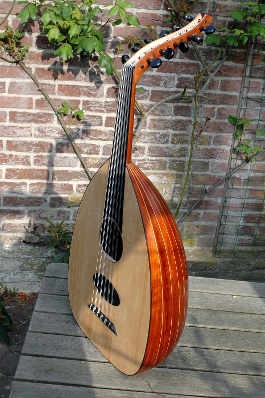

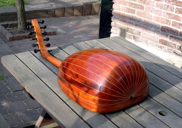

Honduran Mahogany finished
Mav,
this is your oud at his final stage. I will try to ship it this week. it is light weight one , less than 1 kilogram.
the bridge is from Walnut and the the pickguard is pear, both stained black.
the soundboard is Canadian bearclaw spruce, not varnished but waxed for minimal wood protection.
soundhole purfling: pear, berk and wenge
soundboard purfling, rosewood
strings: Labella Arabic Tuning .
(will be shipped this week.)
hope you will enjoy it,.

Nice bowl for sure. I'm not into flat bottom ouds, but thats my preference. Great work!

The flat bottom might not be as common, but it is surprisingly very comfortable to hold. It also helps when you can set your oud down for a moment on its end and it stands by itself! Obviously, not to leave overnight somewhere, but if you need to do something quickly.

yes that is very true. 2 important reasons mav.
and that's why we sometimes say: different people, different tastes :)

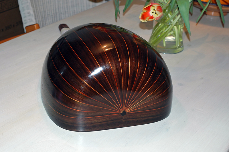

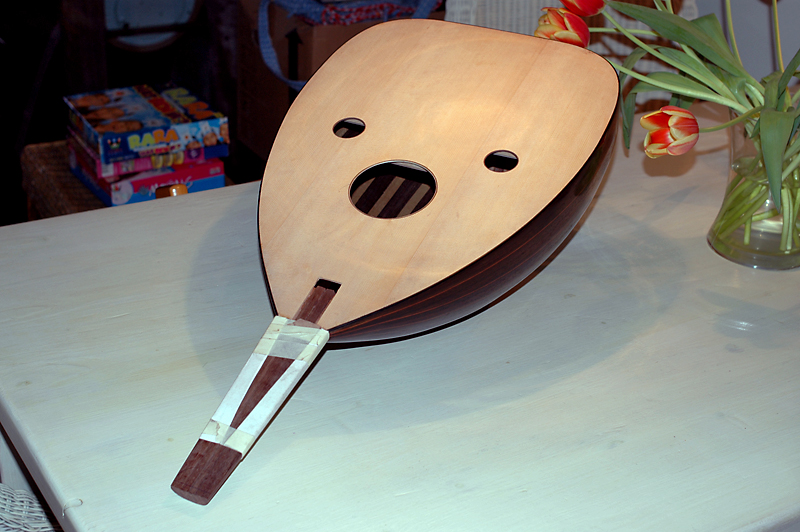

And here is number 3, the indian rosewood.
the oud has high grade indian rosewood ribs, for the bowl with solomon paduk purlfling in between. Epecia soundboad with Eeony purfling around it.
the neck is solid rosewood,
I will try to mound the peg box and the bridge this days.
the bridge is will be Rio rosewood or , Indian Rosewood. I'm not sure yet.
enjoy
Reg
Samir
