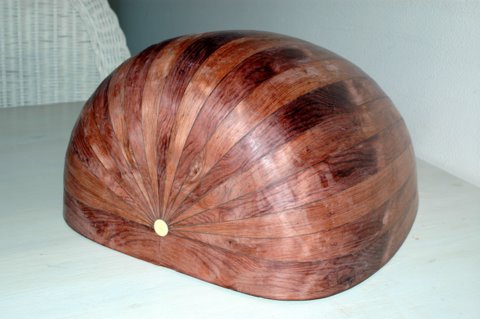

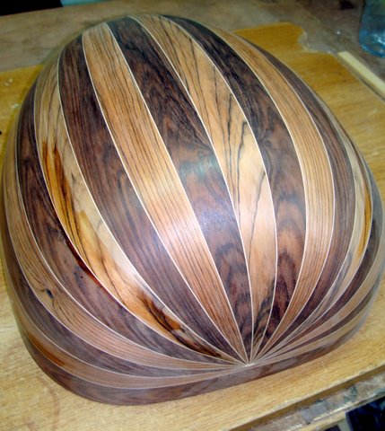

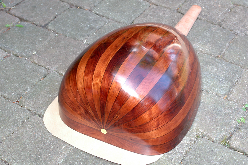

3 rosewood oud

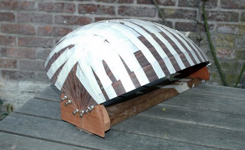

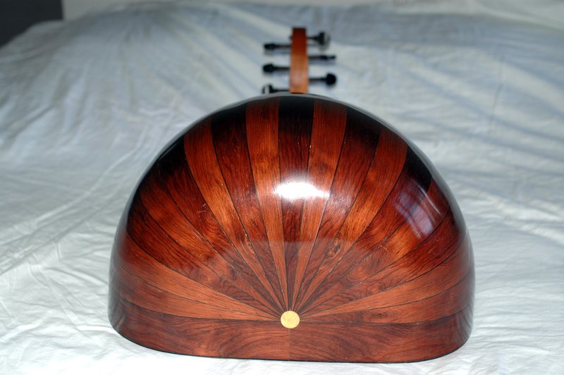

I'm in the process of building 2 new ouds myself, the other one is being made by my friend Majid Atik in Morocco
the first one is Honduran Rosewood (Dalbergia Stevensonii)
beautiful patterns and I have bookmatched the ribs for the esthetic look. still need lot of scraping and sanding for the bowl.

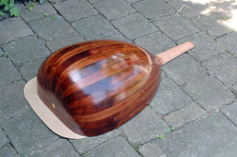

number 2 is Indian Rosewood, high grade, straight grain.
this one is known to most of the guys here at mikeouds.com
number 3 is Rio Rosewood(Dalbergia nigra). this one will be finished sometimes in Jully.
I will keep this post updated as I progress:

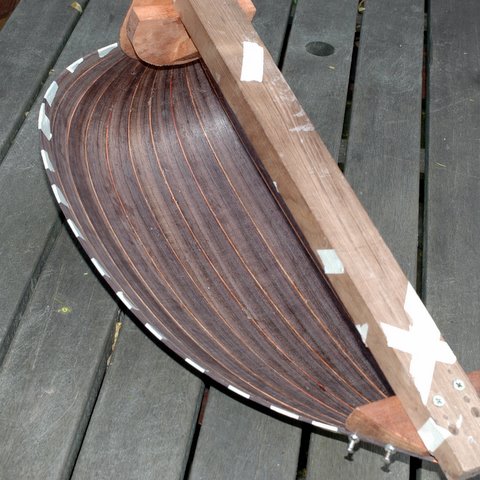

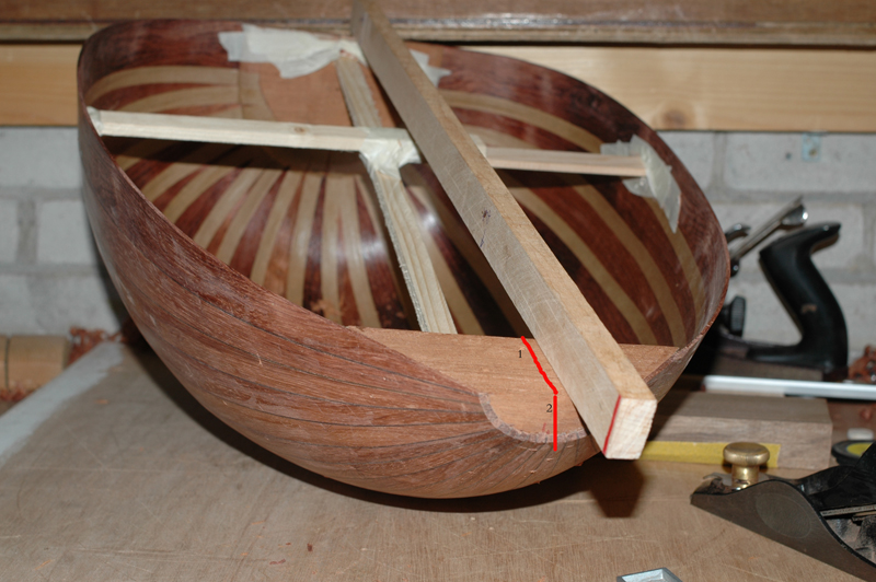

update
I always check how horizontal the neck is. it should be 100% flat and project horizontaly to the back of the oud. this way , when the sound board is in place, it shoul be flush to the back and the neck.
line number 1 and number 2 should be exactly 90 degree for accurate placement of the fingerboard later.
DSC_8714.jpg - 314kB

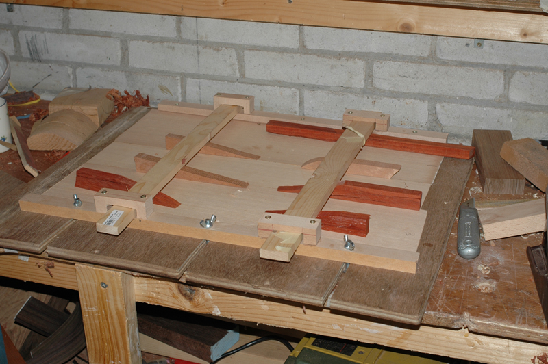

sound board parts are joined using a home made tool...
DSC_8716.jpg - 381kB

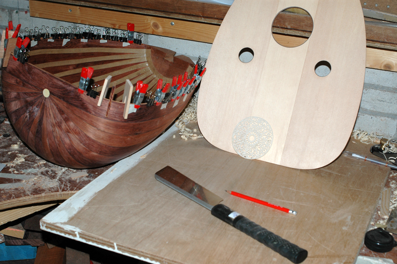

[*] posted on 5-11-2010 at 08:23 AM
rosette
the rosette, soundboard are ready.
usualy the rosette is placed as the last part. but this time I have put it inside the oud and used a masking tape to hold it inside. this way when I finish, I pul it up and glue it to the face from inside.
DSC_8721.jpg - 415kB

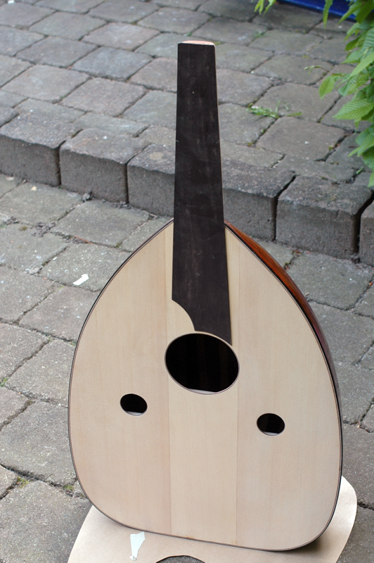

update
purfling around the sound board is
4 strokes: \EbonyTulip\Weng\pear\
ebony fingerboard
will post more later
enjoy
Samir
DSC_8723.jpg - 454kB DSC_8725.jpg - 474kB DSC_8726.jpg - 351kB
That's a neat jig you have made Samir, great idea!

How do you make sure that the paper you use to enforce the ribs with doesn't wrinkle when you glue it?

[*] posted on 5-12-2010 at 01:43 AM
Ibrahim,
I use a small sponge, wet both the wood and the paper (with hot glue) before glueing it. when the paper is glued, stroke it couple of times with the sponge to push it to the wood. easy beezy , japanezy..
regards,
Samir

Thanks Samir, I will try that and will let you know, my previous attempts have all failed.
I have about 10 strips of paper that are not very smooth and I ended up trimming the bumps. I still have to add 10 more. I even tried two of them with titebond instead of hide glue and they ended up being worse.
Hopefully I will do it right this time.

Ibrahim,
Never use titebond for the paper or inside the bowl. it will swallow the sound... stik to hide glue...
you can use titebond to join the ribs, but not the paper...
reg,
Samir

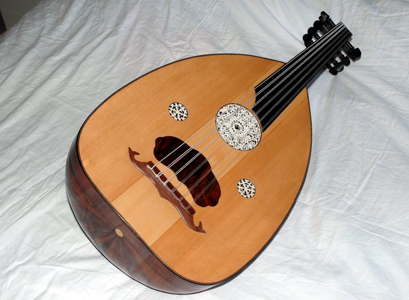

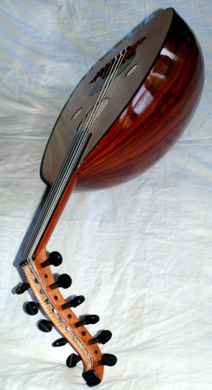

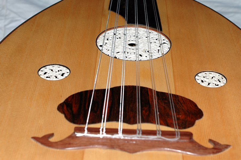

[*] posted on 5-17-2010 at 11:48 PM

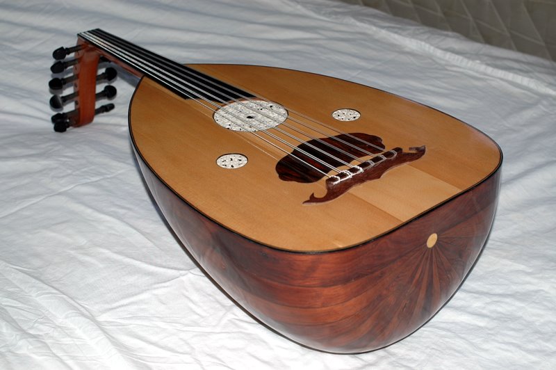

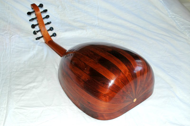

Honduran rosewood complete
after many hours of meticulous work, the honduran rosewood oud is finaly completed . I will post a sound sample sometimes next week.
characteristics
bowl: Honduran rosewood tonewood, width 36cm, long 49,
aged european spruce top
58,5 string lenght
Brazilian rosewood pickguard
Indian rosewood bridge
ebony fingerboard
Mahogany neck
flamed maple/mahogany pegbox
Mock Ivory rosettes (hand made)
ebony pegs
DSC_8739.JPG - 78kB DSC_8742.JPG - 90kB DSC_8751.JPG - 98kB DSC_8764.JPG - 69kB DSC_8768.JPG - 62kB DSC_8771.JPG - 70kB

[*] posted on 5-18-2010 at 04:22 PM
I like the racing-stripe in the soundboard, looks nice.

Wonderfull oud, what are the strings on it? very nice work it's getting better and better Sabassi, congrats
sabbassi
Posts: 570
Registered: 4-28-2008
Location: Morocoo
Mood: happy
[*] posted on 5-18-2010 at 11:02 PM
thanks guys
these are Labella strings FCGDAF (arabic tuning), therse string have higher tension than the normal tuning, which gives the oud more dynamic sound. bashir style
