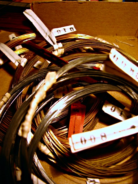

The harpsichord strings shown below do not use overwinding. They cover 5 octaves, with .006" strings in the treble to .022" in the bass. The heaviest
bass strings are 90% red copper, the mid strings are yellow brass, and the treble strings are the lightest, iron. In addition, the "scale length"
ranges from 3 inches in the treble to 60 inches in the bass.
Quite a different set of limitations. The total tension on an authentic harpsichord is a tiny fraction of that found on a modern piano. A fine
harpsichord is like an oud, light and resonant. In Venice during the Renaissance, Oud players must have rubbed shoulders in the Piazza San Marco with
players of the Lute, the Clavichord and the Harpsichord, and instrument-makers influenced each other. An entire Italian harpsichord, taken out of its
outer case, can be carried under one's arm, weighing barely 8 Kg. When ignorant early 20th century "specialists" tried to re-string old instruments
with piano strings, parts went flying and many fine instruments were ruined.

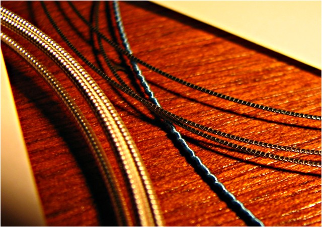

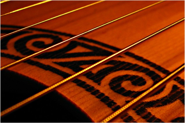

At the other end of the spectrum, with modern materials, if we want to look at some exotic strings (even more exotic than the AC110s Aymara introduced
me to for acoustic guitar), strings that do NOT have the same properties as average strings, look at these! The cores are a woven jeweler's steel
chain (or "rope"), and the windings are nylon flat-tape for the trebles, and silver-plated copper flat-wire for the basses --THAT's different. These
are Thomastic's S KR116 strings for classical guitar! What they provide is a very low tension (6Kg on Spanish guitar) with extremely long sustain and
no finger-noise. The correct gauge strings from this set could be used on an oud for a different timbre, or just an adventure! I'll be doing the math
-- which ones might fit where on the oud, as long as the math checks out, there is no possibility of exceeding safe limits -- but note that these
strings are more expensive than fishing line.
Thomastic steel rope guitar flatwounds from KR116 set. The blue stuff is binding at the end of strings. The thin string on the right is a 0.016"
flatwound nylon tape high E string, replacing a plain nylon .028", the silver one of the left is a flatwound silverplate 0.039" low E string,
replacing the typical roundwound 0.043" silvered copper over nylon.
The Thomastik AC110s are so pretty, I had to show them too They are polished
bronze flatwounds, the top two being just bronze-plated steel, starting with a 0.010". Normal tensions on a Western guitar with normal extra light
strings are uneven, ranging from 8 -14 Kg. The AC110 offer a very consistent tension around 7-7.5 Kg.
