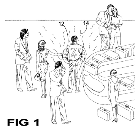

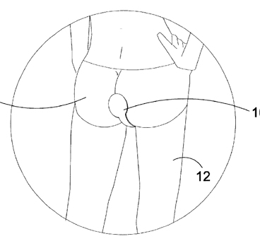

Dear mr mrkmni: 1) this is not a Sukar oud, I noted it was "of unknown make". Sukar ouds have a nice smell of fresh wood. 2) Ouds do fine in hot and dry, yes. Tropical and humid, no. People have all sorts of problems in high humidity. Mr Powell, for instance had his "muy complexo sarouditar" come unglued in Cairo. He's lucky the papier-maché didn't clump into a gump.
Seeking "remedios para tragedia malodorata", I have so far only found "desodorante para flatulencias", under "inventos absurdos", which (as my dictionary is not yet unpacked) I believe means "inventory of our absolutely [best]".
desodoranteFalt.jpg - 45kB desodoranteFlatulencia.jpg - 112kB
