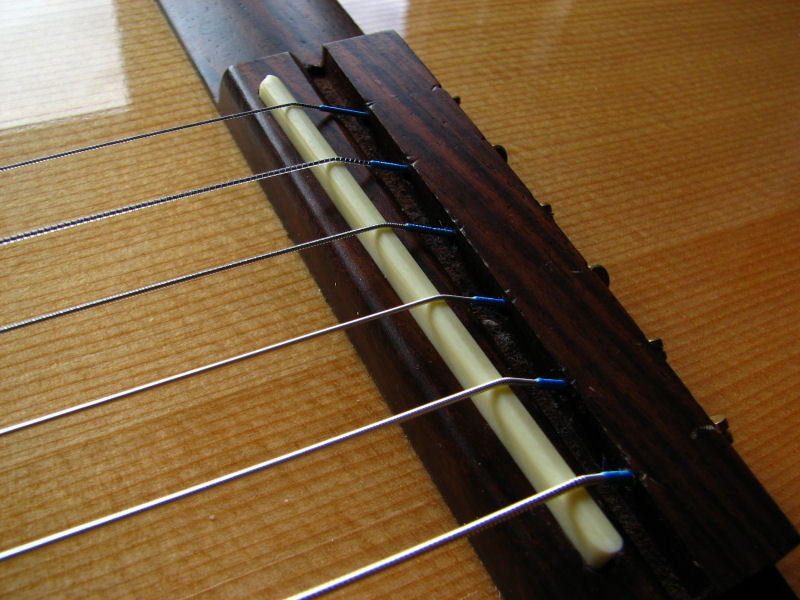

Thomastik KR116
The most "exotic" strings I've ever had. These are installed on a Spanish guitar at the moment, but I tried a couple on a Sukar 615 mm scale oud. The sound was so different that I decided against getting two sets and stringing an oud with them, at the moment, but if someone is looking for a new sound, these are it. One of these days, I'll give it a try.
The trebles are flatwound nylon on a "rope" core, the basses are flatwound silvered copper on rope. They look and feel Rolls Royce. For instance the 0.039" bass string is so flexible, it's like spaghetti al dente. The tensions work out to 2.8 to 3.4 kg, with the 0.016" c course a bit over 4 kg, lighter than 0.54" PVF.
It's a bright sound, on a Spanish guitar. The flatwound nylons sound a lot like PVF, but with amazing sustain. So smooth! You can slide more silently on the basses than on normal oud strings. There is no change in timbre at the Bass-Treble break. The strings don't even stretch a hair after you put them on; they stay in tune right away! Amazing quality and attention to detail all around.
On the oud, the basses I tried gave a zingier sound than the typical oud strings. I never had a course doubled, it might sound divine, or it might just sound odd.
In any case, there is no danger, even the tightest 4.1Kg for the cc on a long scale is within reason. The ball ends can be worked into the loop, or cut off, but careful, the bass strings are not overly long.
These sets sell for $18 at the moment from JustStrings.com, so two sets would add up into the "lute strings" price tag, not cheap, but not impossible.

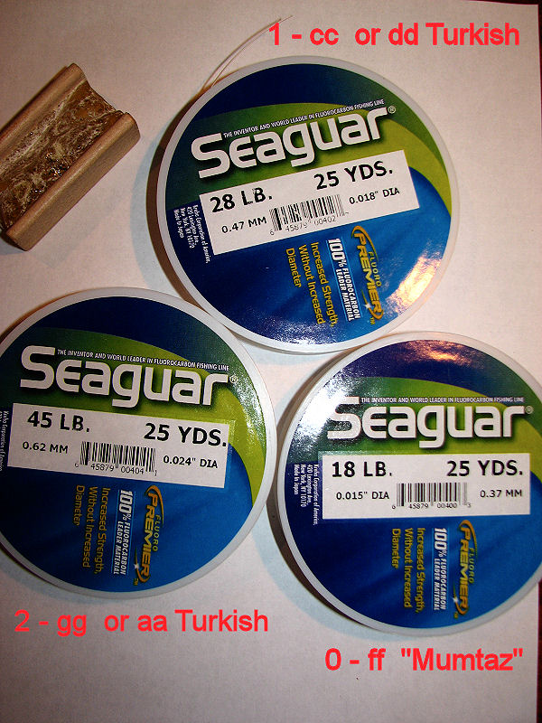

thumbup.gif posted on 7-27-2010 at 11:32 PM
Seaguar Premier Leader
ok. The Seaguar Premier Leader arrived Fedex Ground.
The gauges are correct and the tensions feel like what I had calculated, which is to say a nice even 3.0-3.3 Kg on the cc and gg courses, depending on scale, good match for the Daniel Mari basses. I installed them on a 615 mm scale oud. They sound bright and live. Big range of timbres with different rishas and pluck points. Can't tell if they are the same material as what Musicaravan offers.
I have not tried the ff "mumtaz" course yet, but I rather expect them to work. We want a slightly higher tension on the ff strings, and the 0.37 mm gauge does that. I think Kuerschner has trouble getting 0.37 mm PVF as he only offers Nylon for the ff course, Musicaravan too.
If you want to calculate tensions in Arto's String Calculator, the density of this stuff is around 1800 Kg/ cubic meter.
Seaguar Fluoro Premier Leader
The gauges (with tensions on 615, 600 and 585 mm scale) are:
18 lb 0.015" 0.37 mm for course 0 (ff) (3.6, 3.5 and 3.3 kg)
28 lb 0.018" 0.47 mm for course 1 (cc) (3.3, 3.1 and 3.0 Kg)
45 lb 0.024" 0.62 mm for course 2 (gg) (3.2, 3.1 and 2.9 kg)
Prices vary, but my total order with shipping and tax for the 3 25 yard rolls as above was under $50. At normal prices the standard cc and gg treble courses work out to about $3.60 for the 2 pairs in 40" length, or $4.70 for 3 treble pairs for ff tuning.
I add $8.00 for a set of Daniel Mari basses (and set aside the nylon trebles). Mari Arabic and Turkish sets are identical. The gauges are .022p .028p .024w .030w .035w 041w. Their Nylon ff course is .020p and costs $0.75.
The complete sets then come to:
Mari Arabic Long set with Nylon trebles $7.99
Mari Arabic Long set with Nylon trebles and Nylon ff course $8.74
Mari Arabic Long set with PVF Trebles $11.59
Mari Arabic Long set with PVF Trebles and Nylon ff course $12.24
Mari Arabic Long set with PVF Trebles and PVF ff course $12.69
$11.59 for a PVF set is not bad, beats 30 Euros :D.
The Melton part numbers are:
838300 SEAGUAR FLURO PREMIER-18FP25
838302 SEAGUAR FLURO PREMIER-28FP25
838304 SEAGUAR FLURO PREMIER-45FP25
This looks like very solid stuff, I don't expect "delamination" or other problems. I'll post after I've played them a while.
A useful trick for PVF is to rub the last 2 inches of both ends on violin bow rosin before stringing. PVF is very slippery, and this stops slippage on both the bridge loops and the tuning pin, more effective than melting the tips, which hardly does anything.

[*] posted on 8-3-2010 at 06:56 AM
It's been a week with the PVF trebles. They are still settling a bit overnight, like 5-10 cents, but with less reaction to humidity, NET they drift less than nylons. No sign of "delamination".
I understand that on some ouds some players may find them too bright. That has been reported on classical guitar as well: some people just prefer the more muted nylon. Nylon sounds dead to me, but PVF can be "zingy". This is pretty subjective stuff, on different days the same oud & material sounds surprisingly different. I too have noticed this "magic".
A heavier gauge than 0.47 mm for the cc course seems to sounds less metallic. But the 0.546 that Musicaravan provides has a tension over 4 kg. The logical gauge to try if 0.47 mm seems too light or too bright would be the 0.52 mm, the 0.020" 35 lb Seaguar Premier 35FP25. It is what Freya is using.
There's a strange thing going on with Seaguar Premier Leader gauges, where they are changing the "pound test" ratings, making it hard to know what is what. It might also be that the 0.52mm gauge will no longer be available. But nobody said the "Premier Leader" is the only usable PVF for oud strings, there are other Seaguar leaders, some also made with "double extrusion", and cheaper. And we don't even know if the "double extrusion" is desirable. I'm supposed to talk to the chemical engineer tomorrow, and will post the findings.
I wonder if using nylon for one string and PVF for the other is a useful option.

Except on very zingy days, when even nylons sound bright, I like the PVF strings just the way they are. On a 615 mm oud, using Seaguar Premier, the gg course is perfect at 0.62 mm, it would also work on shorter scale, either Arabic or Turkish tuned. For the cc course the 0.47 mm is a hair light, and this translates to "maybe a bit metallic". Especially on a shorter scale, I'd go with a 0.52 mm for the cc without question.
The ideal PVF material and gauge is open to experiment. These are not prohibitively expensive, $8-$25 for 25 meters, more people should experiment, we can surely find an inexpensive ideal material in bulk. There are even 100 meter rolls, once you're sure, and you have a big family, too many ouds, and lots of friends :D
In the Seaguar leader alone, there are 3 different types, that differ in details of extrusion and resins used. It happens that 0.52 will no longer be available in Premier, but the Blue is very similar, also 2 resin, and the Red is cheaper, single resin. I hope to know more soon. I found a fishing shop (Bay Tackle) where they KNOW people use this stuff on ouds! Another research project, Sigh!
