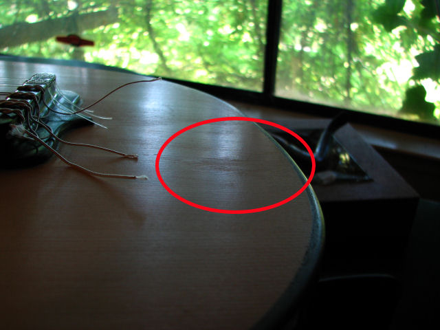

[*] posted on 8-17-2010 at 02:44 PM
What I can contribute is that I am certain that my egg white is NOT waterproof. I applied 4 coats of plain unwhipped albumen, sanding between coats. If the albumen builds up thicker, it polishes to a nice (but fragile) satin gloss. Or you can sand it down further and the spruce looks almost untreated. I did one soundboard more glossy, and one more matte. The "dust" on the plastic steel wool has a white flaky appearance.
It happens that I literally drooled a drop on the more glossy soundboard, undoubtedly from a sense of awe. The saliva penetrated, dissolved in the albumen; there was nothing to blot up. The next day it was difficult to buff it back to its previous state, as the top glossy layer had been reduced on the area, presumably wicked into the wood. If it had been wine or coffee, I believe the water would have transported an ugly stain deep into the wood. John, I would be surprised if your "distillate" somehow became water-resistant by evaporation. I can believe that albumen would make labels adhere by occupying the gap and not "floating away" even if wet.
My question was simply what to use on soundboards. One value of egg-white coating is that it's a bit of a barrier to dirt; if nothing else you can make a pass with fine steel wool and clean the soundboard that way, maybe reapply some egg white. It doesn't impart a yellowish hue. But compared to shellac, which is both waterproof and resistant to lipids, I'd say it's vastly inferior as a soundboard coating. I'm very curious what you will come up with.

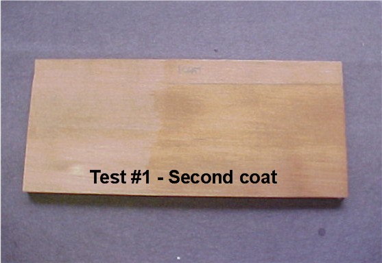

[*] posted on 8-22-2010 at 07:38 AM

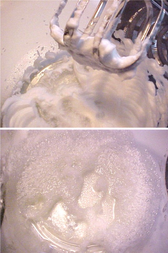

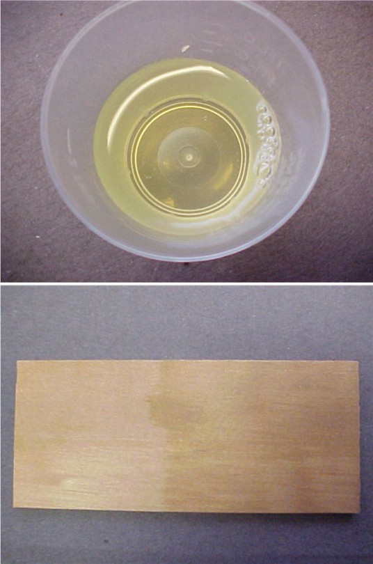

There has been a brief drop in humidity levels so the opportunity was taken to prepare batch #1 of egg white foam distillate for testing.
Two large Omega 3 (low cholesterol yokes) were selected and the egg whites were separated from the yokes into a grease free bowl while still at refrigerator temperature (easier to separate than at room temperature).
Unfortunately the yolk on the second egg broke and a small amount spilled into the separated egg white. This was removed with a clean spoon but as it is not certain that every trace of yolk was removed the test will be repeated at a later date with another batch of egg white.
The egg whites were beaten for 7 minutes with an electric powered whisk running at half speed. This was sufficient to form a stiff foam which was then left overnight. After 14 hours the foam had become lighter in texture (more like a detergent foam) and 15 ml of 'distillate' had collected in the bottom of the bowl. This is batch #1
Conditions when egg white beaten - temp. 22 Celsius, 63% RH
Conditions after 14 hours - temp 20 Celsius, 69% RH.
The distillate was clear with slight yellow tint and viscosity like that of water. The alkalinity was measured at between pH 9 and pH 10 using litmus test papers (this agrees with the findings of other researchers). The alkalinity of the raw egg white prior to beating was not tested.
A test piece of fine grained quarter sawn silver spruce, planed smooth, was then coated with the distillate - applied with a soft brush - until the surface of the test piece was 'flooded'. The distillate was immediately absorbed by the test piece which was then left to dry for 24 hours.
Test 1 - Foam (538 x 812).jpg - 106kB Test 1 distillate comp (536 x 810).jpg - 80kB

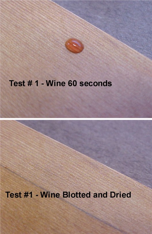

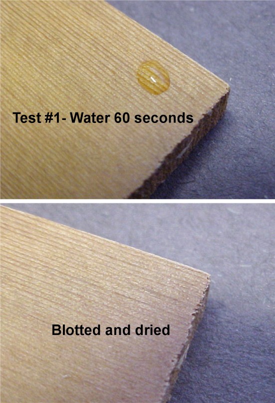

[*] posted on 8-22-2010 at 09:08 AM
The dried test piece surface was then 'polished' to a light sheen with a piece of fine cotton cloth.
To test the dried 'distillate' for fluid resistance, a drop of water was allowed to remain on the surface for 60 seconds, then blotted with a paper towel and allowed to air dry. There was no obvious sign that the dried distillate had dissolved or allowed the water to penetrate the wood surface.
The test was repeated using a drop of red wine. Again none of the fluid was seen to have penetrated or stained the surface.
So from these two tests it would appear that a single coat of distillate - once dried - offers at least some level of water resistance and protection from staining.
This should be sufficient time for a conscientious oud owner to immediately mop up any accidental fluid spills from a sound board to avoid any residual marks or staining. Of course drinking and oud playing together is a practice not to be recommended!
Now to run a more extended test with water.
Test 1 Water 60 secs comp (551 x 806).jpg - 111kB Test #1 - Wine 60 seconds comp (528 x 812).jpg - 93kB

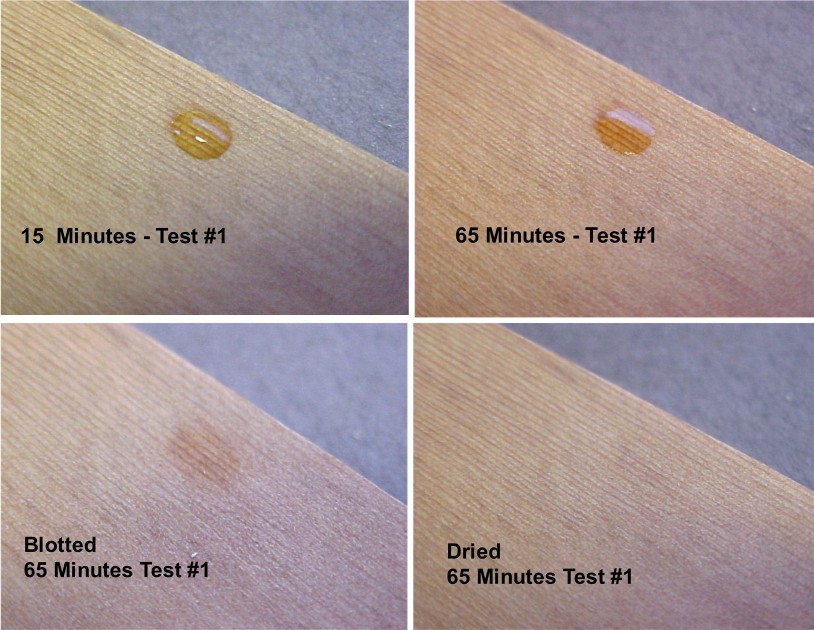

[*] posted on 8-22-2010 at 09:37 AM
This time the drop of water was allowed to remain on the surface for over an hour (65 minutes to be exact) before being blotted and allowed to air dry. Note that after an hour the water droplet has diminished in size but has not spread in area - indicating that some surface evaporation of the water has taken place.
Under magnification (10X) a very faint white outline of part of the water droplet edge could be seen on the surface of the test piece. However, this could be polished away with a cotton cloth becoming invisible - indicating that there perhaps may have been some slight dissolving of the 'distillate' sealer. On the other hand, the water droplet was tap water that in this area is 'hard' containing calcium - so the 'white outline' may just be traces of calcium deposits remaining after the water had evaporated and dried?
The test piece has now been given a second coat of 'distillate' over the first. The second coat appears to have been absorbed by the test piece and so will be allowed to dry for 24 hours before repeating the droplet test.
Note the darkening of the surface of the test piece following application and drying of the 'distillate.
Egg White Foam Distillate - Test #1 One Coat comp (814 x 630).jpg - 129kB Test #1 Second Coat text.jpg - 39kB

If you want to determine how egg white foam distillate reacts with the dried raw egg white coating on your ouds why don't you just go ahead and prepare some 'distillate' as demonstrated earlier in this thread, run some tests yourself and report the results on your thread "Finishing the face with Egg White"? You might then also end up with some first hand experience about preparing the distillate that could be of enough interest and relevance to report on this thread.
When you ask "if the distillate is still fully water-miscible" I take it that you mean compared to raw egg white (both being in the liquid state)?
If I add water to the distillate a small quantity of a white sticky film forms on the surface - an indication perhaps that the distillate is not fully water-miscible.
However, as Cennini makes no mention of diluting the distillate with water prior to its application then this is of little interest here.
Nevertheless, I am interested as to whether or not the dried residue of the distillate is soluble in water so currently have a small sample - set aside two days ago - to air dry (slow).
On the question of the porosity of the wood sample, I previously reported that the first application of the distillate was immediately absorbed into the wood.
The sample is very fine grained, quarter sawn 'Silver Spruce' set aside about 20 years ago as a promising looking sound board wood. 'Silver Spruce' is a generic term used by the timber industry that might apply to any of the North American spruce varieties such as Sitka Spruce, Engelman Spruce, Colorado Spruce etc.
For information and comparison the attached image shows the appearance of absorption of a water droplet on the untreated surface of the 'Silver Spruce' sample as well as on a sample of 'Sitka Spruce' sound board material - after about a minute.
Sound board Water Absorption Test comp (396 x 600).jpg - 61kB

It is apparent from tests carried out so far that egg white foam distillate is quite different from raw egg white - although I do not pretend to understand what has happened in the transformation at a molecular level or what the chemical analysis of the distillate might be.
I had eggs for breakfast so was able to test the pH level of the albumen before it was denatured by heat (i.e. cooked). An indicator strip showed a pH value of 8 which agrees with values given in tables recording the pH values of common household materials (pH range for egg whites 7.6 to 8.0).
The pH scale is logarithmic (base 10) with neutral value (pure water) of 7.0.
So if the indicated pH value of 10 for the distillate that was measured the other day is representative, that means the distillate is 100 times more alkaline than raw egg white.
When the distillate is applied to the test piece it is absorbed by the wood more quickly than water indicating that the distillate has a lower viscosity (and surface tension?) than plain water.
Also the distillate which is quite transparent - when dried - permanently darkens the wood whereas plain water does not.
Cennini notes that his distillate not only gives work (wood, stone, paintings) the appearance of being varnished (darkened surface?) but also gives the work added strength. This all suggests that there may be some kind of chemical reaction occurring between the distillate and the wood itself.
Tests carried out on hardwoods some time ago on this forum (see the 'marinated' wood topic) indicate that alkali solutions (such as diluted household ammonia) react chemically with the wood cell structure as well as dissolving extractives within the cells (dependent upon the length of time wood is immersed in the alkali solution). Softwoods were not tested as part of that investigation, however.
Household ammonia has a pH value of about 11.0 so is 10X more alkaline than the egg white foam distillate. To investigate if alkaline solutions do react with softwood - perhaps partially dissolving the resins in the wood - a preliminary trial will be to 'varnish' the untreated surface of the test piece with dilute ammonia, allow to dry and then compare the results with those already obtained for the distillate coating.
A further investigative step will then be to immerse a sample of softwood in the distillate for an extended period of time - just to see what happens.
The sample of distillate that has already been set aside to dry into a solid residue (for solubility testing) will be regularly checked for pH value as it (slowly) dries up and becomes more concentrated. So far there has been no detectable increase in alkalinity - although the pH test strips only measure in unit steps so can only give an approximate indication of pH value.
