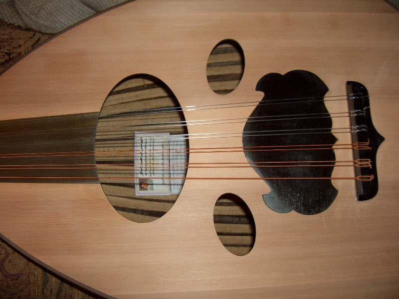

I have just recently purchased a Sukar 212 and am delighted with it. I'm wondering if anyone knows which type of strings the Sukars are shipped with, as I like them very much and would like to purchase more sets. I include a picture here (3 courses of copper wound and 3 courses of nylon). The strings look like Aquila strings to me, but I can't find anywhere to purchase such a set with 3 courses of nylon.
Secondly, I very much like the sound of the raw Sukar soundboard but am wondering if anything should be done to it to preserve the board over time, or if it will be fine as is.

The treble strings are ordinary nylon, though it's a bit unusual to use 3 nylon courses for standard tuning. You can see the first course was added on the back pegs to a 5 course stringing. The bass strings are very different from the usual oud strings. The winding wire is thin unplated copper.
A typical 0.045" bass string has a winding of silver-plated copper alloy about 0.013" in diameter, leaving 0.045 - 0.013 - 0.013 = 0.019 " for the nylon fluff inner core. The Sukar factory bass string uses pure copper wire about 0.008" thick. Thus the nylon fluff core of such a string is 0.045 - 0.008 - 0.008 = 0.029", meaning the weight of such a string is a lot less, and thus the tension lower. Another way to look at it is that a 0.045" string like that is not equivalent to a 0.045" string in D'Addario or Mari or LaBella, but to a thinner one, maybe a 0.041"' which is what these sets use. This is important, not to replace a 0.045 copper wound with a 0.045" from a different maker.
Another "feature" of these strings is that they are not well made. Loosely wound copper is used because it's softer and easier to work with, and doesn't require high tech machines. These are local inexpensively made strings used as a factory set on many Syrian and Egyptian ouds. My experience is that the windings break if you put more tension on them, and where the risha hits, and unravel rather quickly, the intonation is poor due to uneven thickness, and all in all the set falls apart within a few weeks, whereas a normal oud set can last for many months if not a year or more.
The subject of face protection has been treated here many times. It's a matter of opinion, but I don't like a grubby soundboard and I don't see any degradation in sound from using a very thin coating of a brittle finish like shellac or egg white. I just did a 212 in egg white, look it up in the forum, i think it looks much nicer than the raw wood, and the only question is how it can be made more waterproof, so I'm experimenting, as is Jdowning. I just realized that my French Polished model 1 that looked a little uneven needed a buffing pass, and it looks fantastic after a session with 0000 plastic steel wool. THAT is a more effective protection against stains, though more work than egg white.
Those are (the only?) two treatments that are known not to turn the soundboard into a limp slice of bologna. Oils and urethane and varnish are deadly as they dampen the resonance. The purists insist only untreated wood sounds good, but they are in the minority, even among perfectionists. Sukar delivers a great instrument at a moderate price. He saves labor and leaves you the option of finishing the face, or not. On the most expensive ouds many makers finish the face with French Polishing but some do not.

anyway those strings are such a cheap and low quality strings, i have 2 sets of them (from 2 ouds i recently bought from sukar, immediately changed them with pyramid and D'adario) n i would present them to you if i could visit you!!! anyway u can ask M.sukar where to buy it. its really strange for me that u like those strings :D
in the first year always keep the oud in its nylon bag an hard case when you dont play it. specially if u live in a place drier than syria. its a good idea to use a humidity gauge n check the humidity and control it with humidifier or silica gel.
