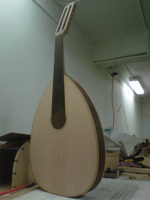

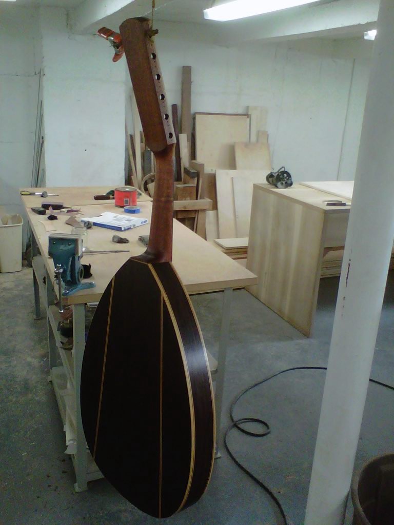

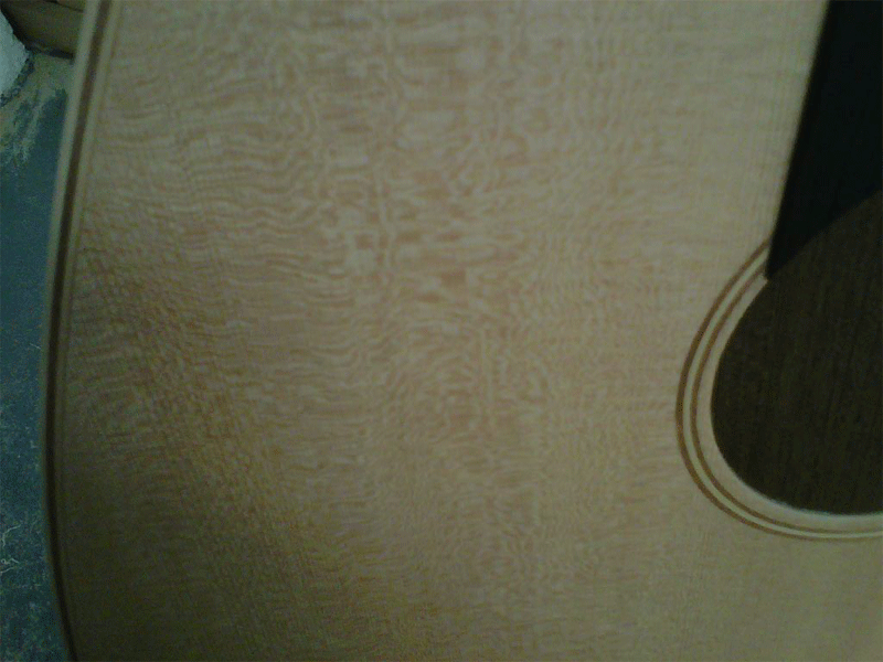

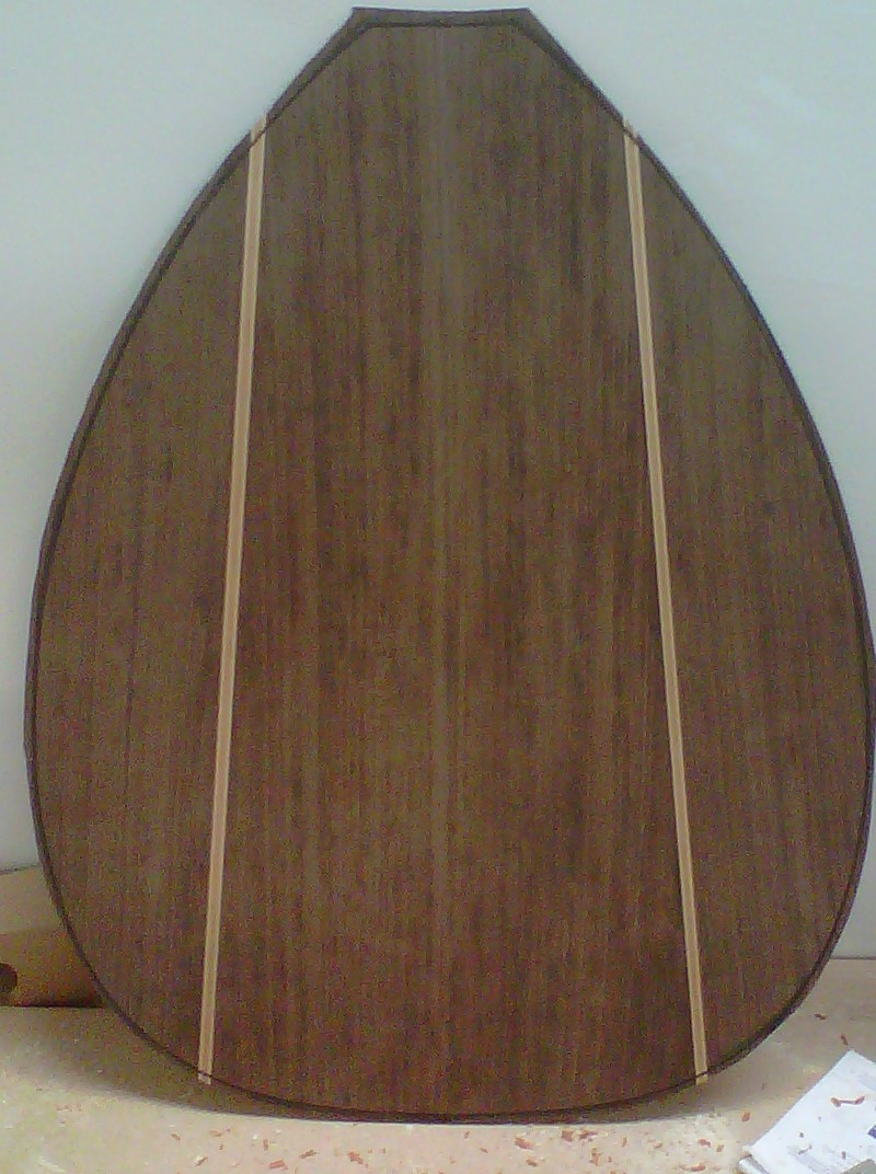

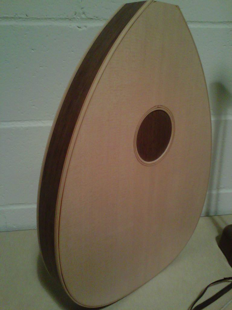

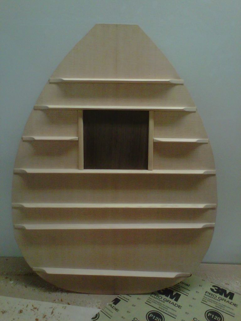

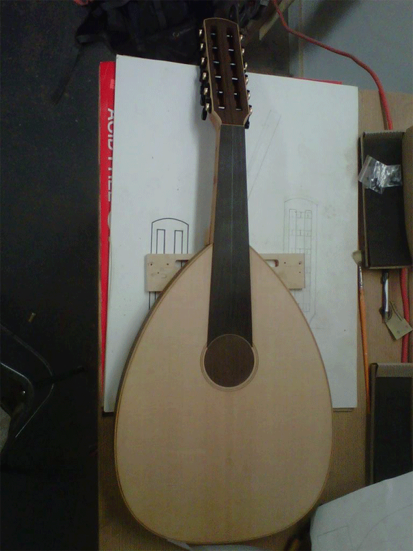

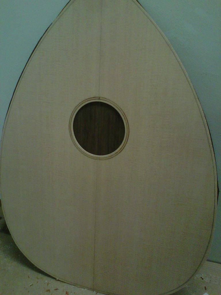

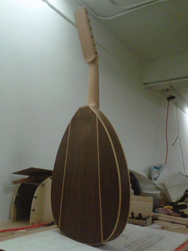

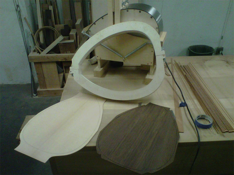

And this is a new experimental electric oud from my friend Andrew Bradshaw, who makes really gorgeous acoustic and electric guitars.
I was telling him how an acoustic oud often can't handle higher volume situations without feeding back, while a solid body electric often doesn't sound or react enough like an acoustic instrument.
He suggested we try a hollow body acoustic with no soundhole and see how it turns out. Even without the soundhole, the oud has very decent volume, especially for practicing alone, and plugged in sounds just like an amplified acoustic oud, but with more feedback tolerance. Right now I have simple K&K pickups installed, but down the road I may experiment with higher end pickups.

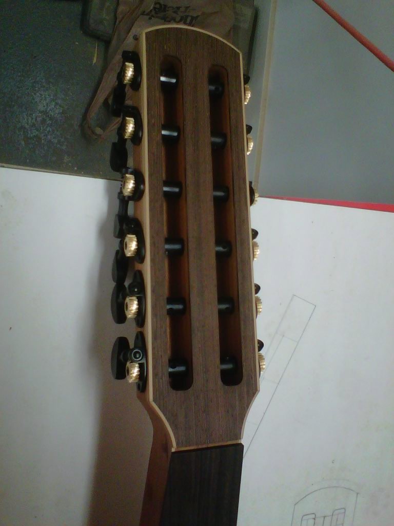

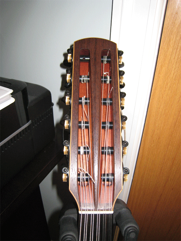

I know many of you won't like the guitar headstock on this oud, but it is truly a work of art, and for future electrics can be replaced with the traditional pegbox and peghed pegs.
2 back plate.jpeg - 232kB 4 top with sound hole.jpeg - 105kB 5 bracing.jpg - 111kB 6 body and face glued.jpg - 317kB 7 headstock.jpg - 116kB 14 Back with finish.jpeg - 131kB 15 Front with finish.jpeg - 143kB

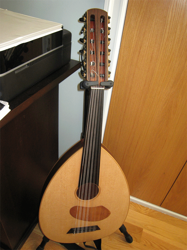

Right now all I have is the K&K twin spot internal. The best sounding preamp I have is a presonus model, which combines tube and solid state sound.
The pickup I want, but is out of my price range right now is this one:http://tranceaudio.com/
I can't afford it right now, but a friend of mine has it in his guitar and it really is a great pickup.
I've plugged in the electric oud directly into an amp, and it sounds nice. It basically acts like an acoustic oud, but doesn't feedback as easily.
What I never liked about the solid body electrics is not just the sound of the pickups, but also that the notes did not decay fast enough, like on an acoustic. They run into each other, which is fine if you are not really going for a typical oud sound (I might even try for a steel string electric some day with humbucker pickups or something), but for simple amplified oud sound, it didn't work for me.
I highly recommend my friend Andrew's work. His treatment of the woods is just gorgeous, and I need to upload more pictures for you to see the detail better - the headstock in the photo above is still unfinished.

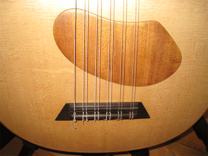

Also, if you notice the bridge has a saddle, but not huge like on a classical. It works very well, and is great for better control of the action.

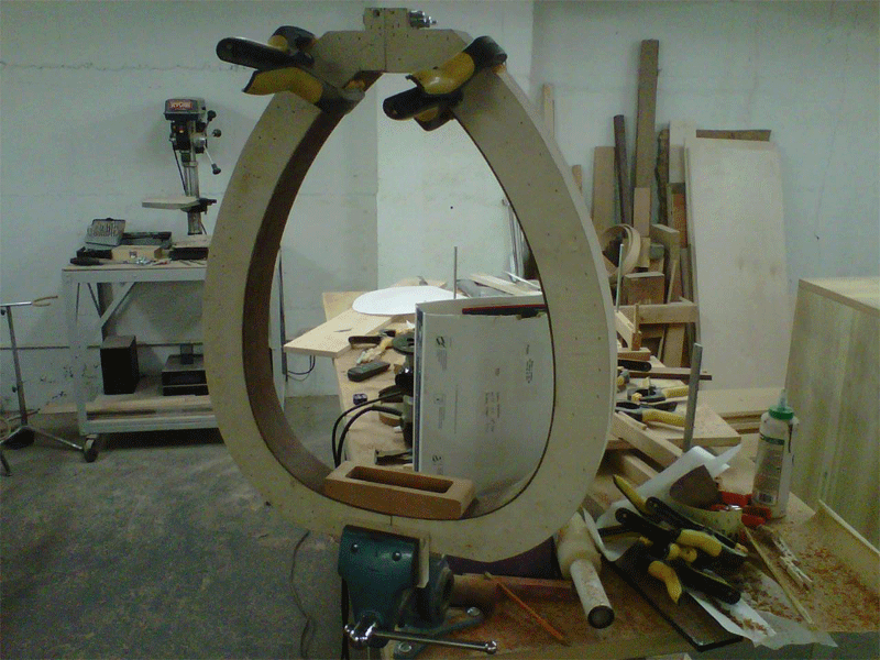

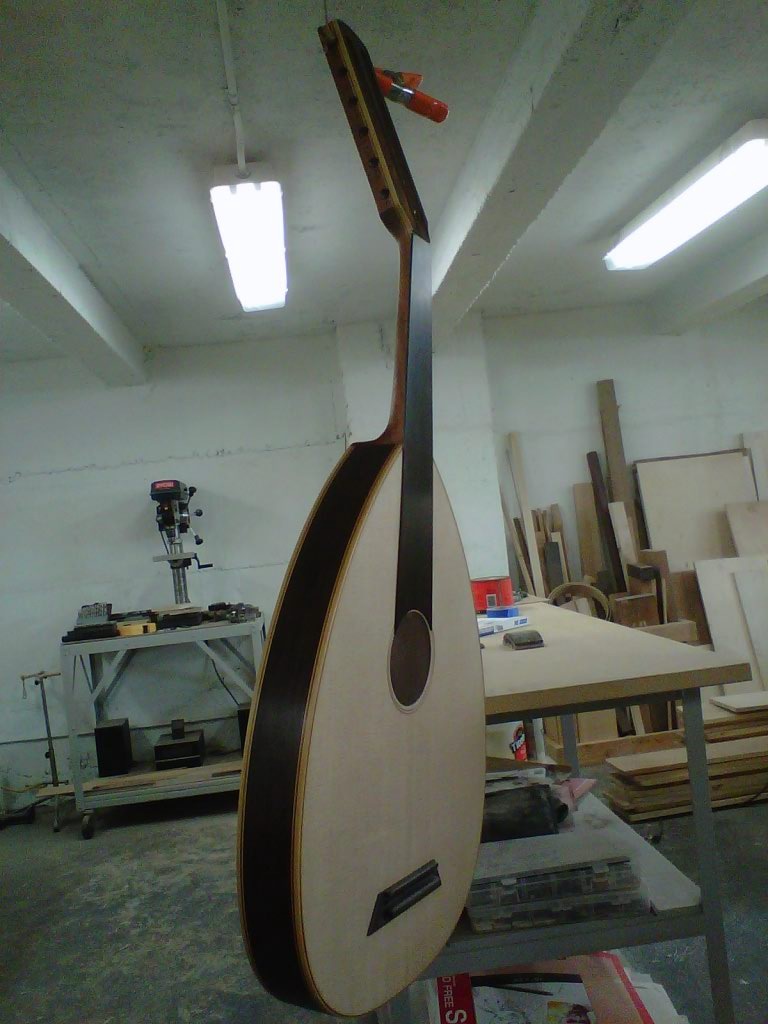

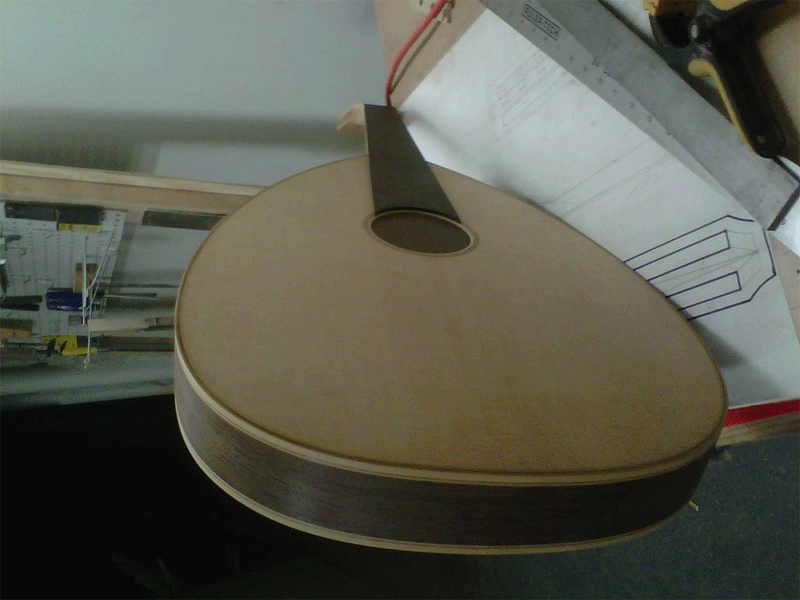

Some more pics from construction and also completed. I really love this oud!
1-first-pieces.gif - 324kB 3-gluing-sides.gif - 327kB 8-coming-along!.gif - 259kB 9-oud-butt-end.gif - 239kB 10-front-assembled.gif - 276kB 11-back-assembled.gif - 264kB 13-Closeup-of-finish.gif - 348kB IMG_4255.gif - 295kB IMG_4256.gif - 273kB IMG_4257.gif - 326kB

Curious how the tuning machines work. more pix and vids?

Hey thanks guys, I'll try and get a sound sample up for you soon. I was plugging it into my little crate amp last night and it is just sounding great - very acoustic, very nice, but I could have the amp turned all the way up with the oud in front of it without feedback. Probably if I had the preamp hooked up that wouldn't be the case, but I thought it was pretty cool.
The tuning machines work great, I got top of the line Schertler machines. Man, it tunes so easily! Really smooth.
That new Mustafa oud design sounds interesting. Is the top really thin?
The electric oud body is practically weightless - the weight is really all in the headstock. Still, it is all in all probably a little less than 3 lbs - it's light! My friend Andrew did just a gorgeous job, I'm really impressed, and it was really nice being a part of the building process, and helping get it set up the day I took it home.
Whether I'm standing or sitting, I use the guitar strap so the weight distribution is perfect, and still wouldn't be that bad without it. I just need the strap either way b/c this body is much thinner than a regular oud, so the strap takes away any awkwardness I have with my posture.
Like I said previously, if for any reason you don't go for the guitar style head stock, you can go for a traditional pegbox - I recommend pegheds if you do that.

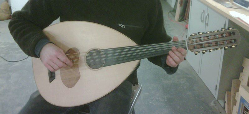

I'll try and get some sound up for you before too long. Here are a few more pics from the night I picked it up 'from the shop.'
Thanks guys!
mav playing bradshaw electric oud.jpg - 48kB
in-the-hands-of-the-maker.gif - 194kB
