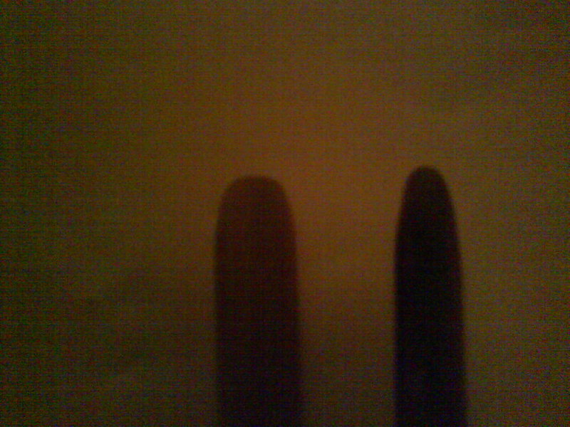

Hi Robert
it's not a very clear picture, sorry...the risha on the left has a more or less squared end with slightly rounded corners; the risha on the right is a regular 'pyramid' shaped end. You can probably make the end even more squared/flat across, it's up to you.
rsz_risha.jpg - 115kB

How wide is your risha? I like squared ends as long as the risha is narrow.

well ameer my widest horn risha is 12mm across, but the end that actually strikes the strings is nearly 7mm across, then it tapers off on each side. My narrower horn risha is about 10mm across, more like a standard pyramid shape, but the end that strikes the strings is actually about nearly 6mm across, then tapers off each side. I use them both now, to get used to all shapes and sizes.;)

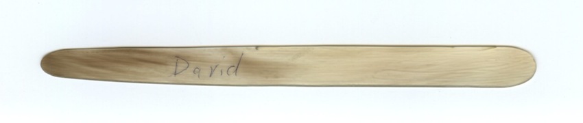

I use 2 rishis made by you John, one with an exaggerated rounded tip profile and one with a regular bullet shaped tip. My favorite is the regular bullet. It gives a clear attack and nice tremolo. The rounded shape mitigates the attack and gives a 'flat' playing, difficult to keep playing tremolo with it. As you told me a few months ago, I maintain the side like the square edge or 'rounded' square edge. To me the biggest problem with the knife like edge are the streaks made by the string where the risha bounces. After a while the knife edge becomes a knife teeth edge, and the teeth scratch on the lower string with an unsightly sound.
exaggerated rounded tip profile.jpg - 21kB

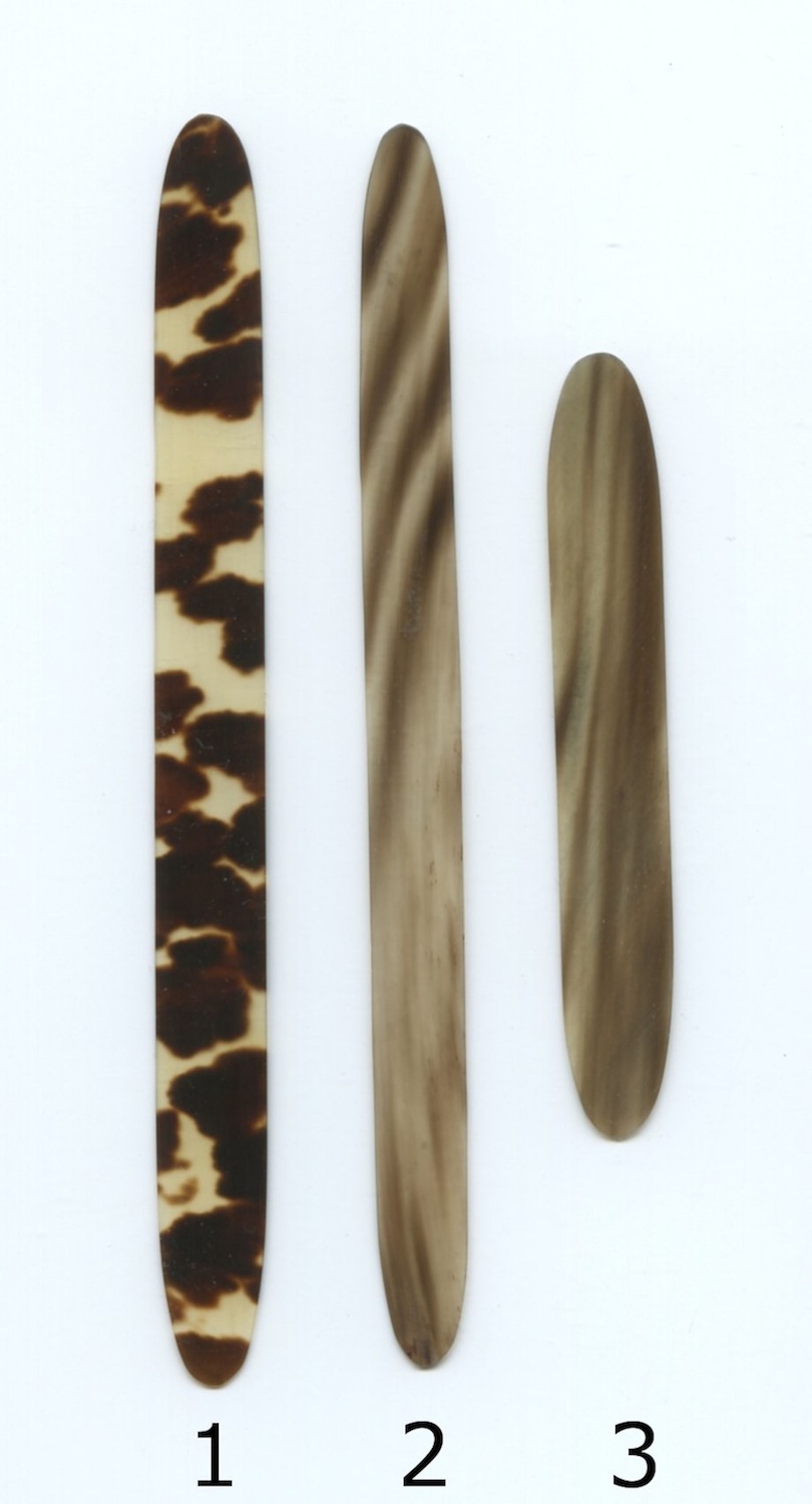

Hi Tony,
Yes I use a nail polisher. Delrin, I haven't try yet ... Could you give me a link where to find it? In fact I've got my perfect risha (number 1), but I prefer not to discuss about the matter (some controversy). It's bright, strong and soft, perfect tremolo, perfect playability with plenty of nuances. But it's a sort of curse, the sound is projected so loud and so dense that it makes my right ear painful after a few hours of playing :(
52272_1609961059772_1558601928_1429312_4420071_o.jpg - 133kB

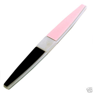

John, I use what you see on the photo : 1- to file, 2- to eliminate, 3- to shine, 4- to satin. It works perfectly well in my opinion :shrug:
!BU1cz7gB2k~$(KGrHgoOKkMEjlLmV,uSBKPk7w,m9g~~_35.JPG - 6kB

This seems suitable David.

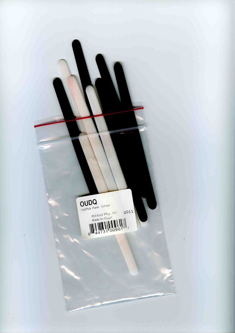

Tony, I bought what you show on this link -> http://www.mid-east.com/itemdesc.asp?ic=OUDQ&eq=&Tp=
Is it what you call delrin? For me it is vulgar plastic picks in the Turkish style ... I think that Mid-East did not send to me the same product as the picture shows.
BTW, I won't run out of these rishi ;)
RISHA001.jpg - 79kB
