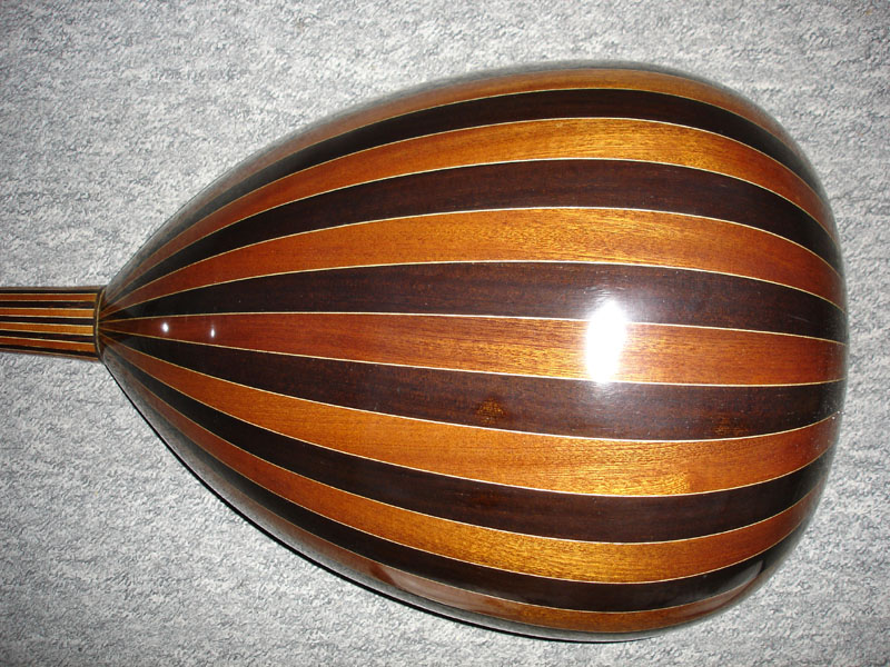

[*] posted on 7-13-2011 at 03:46 AM
This picture of an oud I finshed in Tru-oil may help you to decide.
As far as I can tell, it did not change the color appreciably.
Haluk_Model_3 004.jpg - 165kB

Greg, nice finish. did you use a pore filler?

Great, it seems to be really whar I'm looking for.
Indeed, did you use any pore filler?
How many coats did you apply, and did you polish with steel wool each coat (and if the case which number for steel wool)?

[*] posted on 7-13-2011 at 08:58 PM
This oud was already pore filled when I got it, but not finished.
I applied about six or seven coats and used steel wool Grade 0000 (super fine) between each coat.
