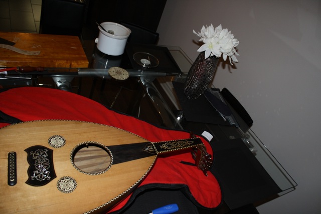

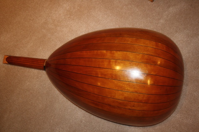

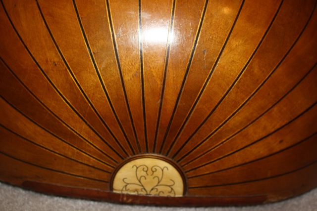

Thanks for all the wishes everyone. The workmanship is unreal, he was a great maker indeed. This oud is really special to me and I hope to cary on the spirit of Gedo Shafik who use to play with it.
I have some pictures here for you to see. I prepared the hide glue tonight for the repairs. I wont be removing the top but I will see what I can do for pictures of the bracing. Maybe I can do Jameel's camera trick.
funny thing is they thought I was suspicious looking when I was staring at the xray machine display in the airport. you could see every detail of the bracing. It didn't look extravagant or out of the extraordinary.

magnificent, looks like the other Laithy ouds I've seen pictures of...I'm speechless...

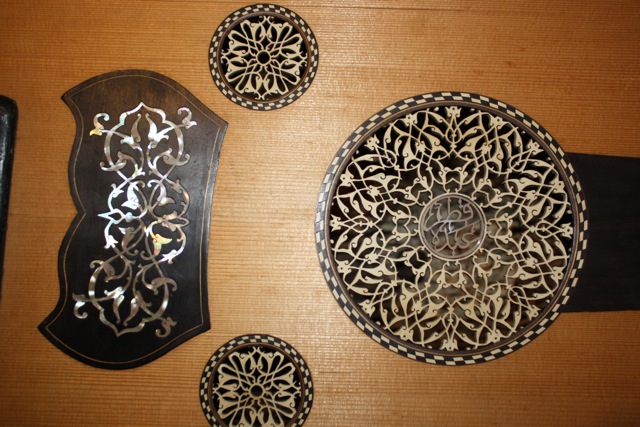

This is a treasure Samir ! How lucky you are !
In the center of the big rosette there's the name of the owner, or at least who used to be the owner or the man whom the oud was built for : Abdo Qatar !

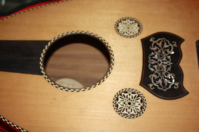

here are some pictures of the repairs I have completed on my wife's grandfather's oud.

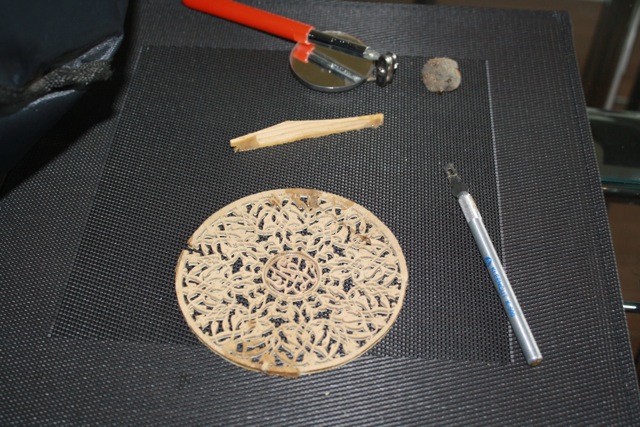

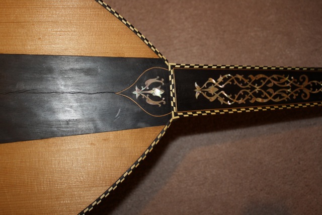

First I glued back pegbox which thankfully was not broken but the previous glue joint had failed. So I made some new hide glue and went to work.
next there was 3 loose braces which were reatached by removing the rosette and using hide glue to reach in the corner.
some details about the construction of this oud. The braces are VERY thin (0.5 cm wide about) and scalloped at the ends where the meet the oud body they are not higher than 0.5 cm.
The number and placement of braces is not unusual other then that.
The rosetted was very tricky to remove because it had been glued before the top was glued to the body and the 2 short braces on either side were notched where they met the rosette so they could act as further support. There was no way to keep those notches when replacing the rosette so I had to file them down.

Beautiful story thanks for the pictures i learned how put the rosette

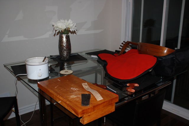

Also, I appologize I didnt have an assistant that day to make pictures while i was working. Because it was detail oriented work I decided to work on my kitchen table where the lighting is better, this of course while my wife was away :)

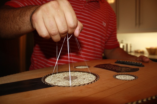

My method to put the rosette back on is not the "traditional" way of puting it on. If you make a search on the forums you will be able to find pictures of the typrical method with of sticks to create the tension.
But in this case, because the rosette is soo small and fragile, i wanted to distribute the pressure eavenly. I used dental floss /for no particular reason, but now there is no gengivitis or decay on the shamsa ;) / and i wove it through the thickest portions of the rosette design. For this method to work, you have to use hide glue which sets pretty much in under 2-3 minutes. Once I brought up the rosette to make contact with the oud face, the glue was reheated with a heat gun to soften it once again. Hide glue is magical... because as it dries and shrinks, it makes the joint tighter and in this case it made the rosette super thight with the top. Modern chemical glues are very strong but they dont have that advantage and need more clamping pressure.
