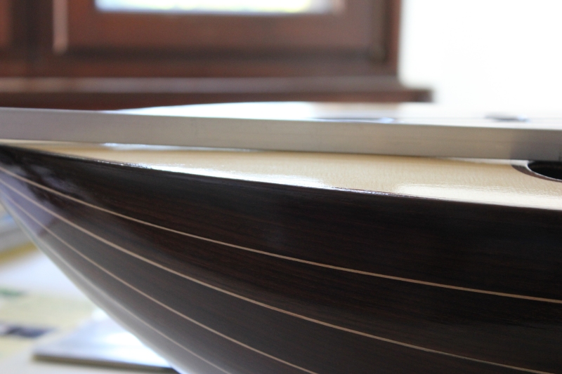

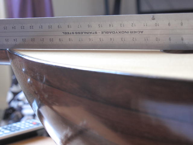

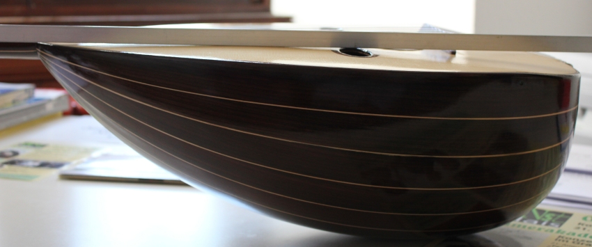

here is some pictures to show the problem
Do you think that is a professional oud?
samircanada and alidaood thanks a lot for your answers

I am neither a specialist, nor a luthier. But I can say that the problem is that the soundboard is convex. And as the fingerboard 'follows' the soundboard, it's impossible to play high on the fingerboard. This oud is ABSOLUTLY UNPLAYABLE.
Maybe Cyril could provide us pictures which show better the convexity of the soundboard. It is not so evident on the first pictures.

From looking at the pictures there is an obvious dip in the top where it usually should be straight. I dont know how that happened or even if it was a "design feature" but technically it shouldnt affect the playing if the fingerboard laying on top of it is straight.
Please Dorado tell us, is the fingerboard resting on top of the face or is it inlayed into the top?
From the pictures and videos, it looks like its inlayed into the top and follows the dip of the face which would make it unplayable.
If that is the case, the best option to fix it I think would be to make a new fingerboard and lay it on top of the old one.
