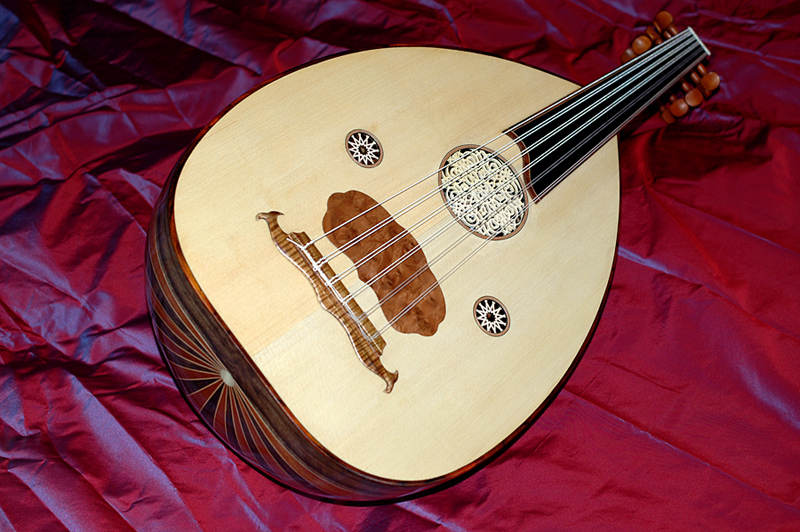

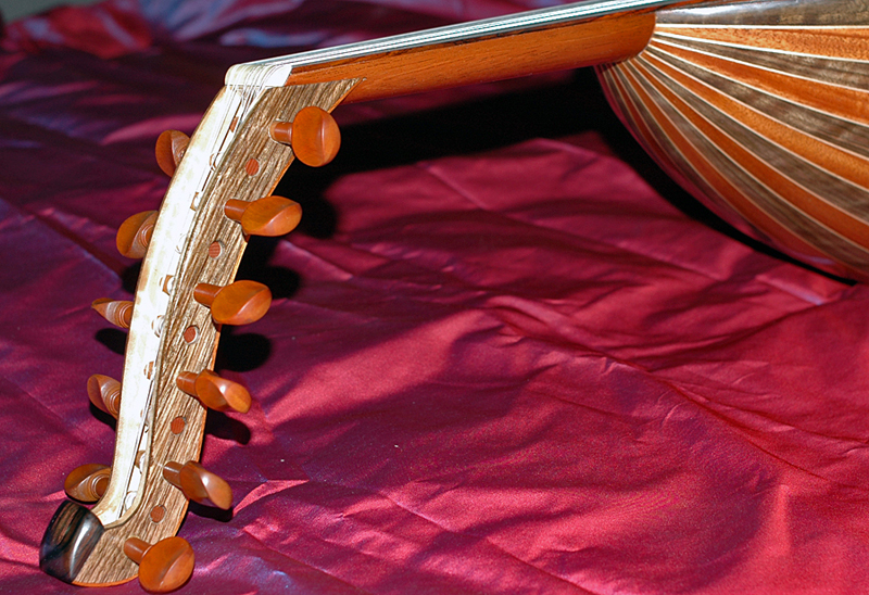

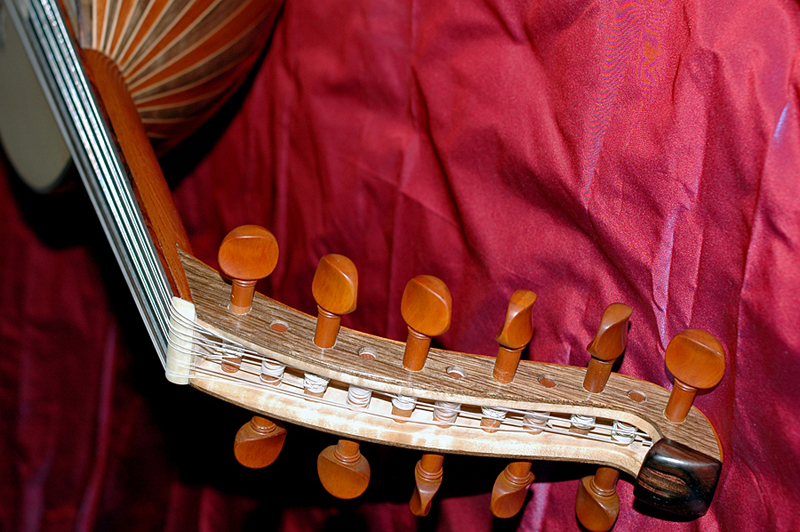

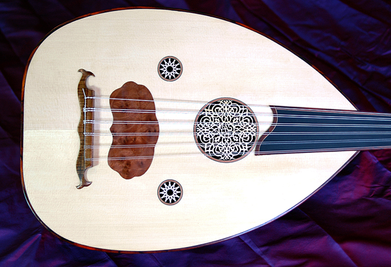

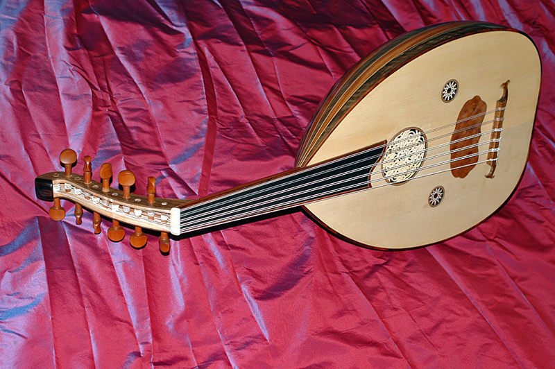

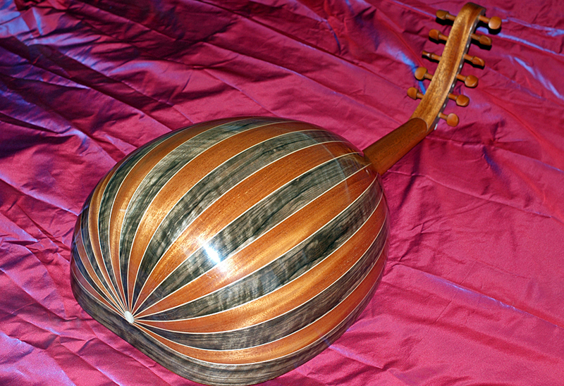

I'd like to share with you the new oud i finished yesterday.
The bowl is made of fine cuban mahogany and moroccan flamed dark walnut with maple purfling in between.
finger board is ebony surrounded with cocobolo and maple purfling.
Spruce top
sound hole strips: pear/maple/sycamore(black)
soundboard strips purfling: cocobolo
bridge is flamed swamp ash
walnut pickguard
Lemon wood Hand made rosette (samir abbassi in arabic inside) Special thanks to Alfaraby for the design.
Boxwood pegs
bone: nut and bowl end.
the bowls is 36x49,5cm
Thanks guys.

How do you inlay the fingerboard at the edge? Its gorgeous.

The fingerboard. I first make the ebony fingerboard to exactly fit the oud as normal. then I remove from the 3 sides exact the same amount of ebony, then I glue the cocobolo and the strip in between using masking tape. I reshape the fingerboard again to the oud and remove the excess cocobolo.
the curvy one is tricky and cocobolo is quickly broken, so I took a big piece and reshape the to curve, glueing and voila. it is lot of precision work, take a while to make exact fit.
