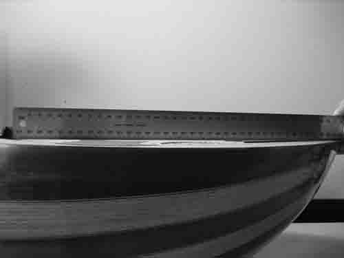

I bought a used oud. I'm new to the world of ouds, and was told by the seller that some soundboard curvature is normal over time.
When I place a straight edge on the soundboard, so that it makes contact near the bridge, and at the place where the neck meets the body, I find that the middle of the soundboard is curved 5mm away from the straight edge.
Is this really typical? If not, how can I repair it?
Any advice would be appreciated.

Hello Alex,
Welcome to the forums. Yes, it is normal for there to be a small distortion. 5mm would be around the maximum I would be comfortable with. But I play a Turkish sized oud and they tend to distort less than some Arabic sized ouds. An important measurement at this stage of proceedings is the height of the strings above the fingerboard, where the neck meets the body. What does that measure?

Concave soundboard is something makers do intentionally, and is also something that may happen over time. I prefer a slight "dip" in the soundboard at the center for a couple reasons. For a fixed bridge, the oud would be under less stress, and its less likely to receive buzzing on the fingerboard past the neck joint. There are a couple ways to makers to render the top convex. You'll have a problem if the opposite geometry occurs.. such as a convex top.. which it bulges UP. That is an oud under stress and a failure in construction of the face.

The face is intentionally built concave to avoid it bulging or bowing up. All Turkish ouds use this feature, but not all Arabic ouds. If the face is built perfectly flat, the torsion of the fixed bridge will twist the face between the braces. The next brace forward then becomes a pivot point, which causes the face to bow upwards between the next braces, just under the center sound hole. This distortion can interfere with the vibration amplitude of the strings causing rattling or buzzing. When the face is built with an depression or concave, this condition is avoided. The concave face can be achieved by either trimming the sides down or shaping the braces.
