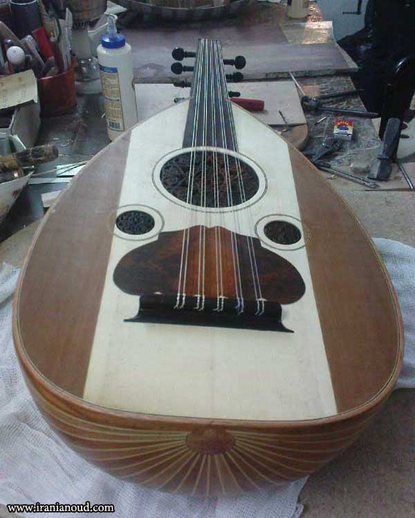

Just thought I would revive this thread as I found an Arafati Oud/Barbat with the same three piece soundboard as pictured (if that is what it is) heres the picture:
arafati_mohammadtaghi17.jpg - 49kB
...and what a beauty. The sound we can only speculate but I imagine there would be a difference to regular 2 piece soundboards.

Consensus in previous forum threads seems to be that multi-piece soundboards and two-piece soundboards sound no more different from each other than various two - piece soundboards of the same wood type sound from each other or different multi-piece sound boards of the same number of pieces sound from each other.
This appears to be photo of an oud with either a four piece or two piece soundboard. It could even be six pieces but I can't see clearly enough. What can be seen ("south" of the bridge) is the division of the light wood into two pieces. I can't tell if the dark part on each side of the light wood of the center represents a different piece of wood or not. The dark wood of the soundboard appears to be stained wood of the same type as the light wood but the light in the photo doesn't make it clear if each dark part is a different piece or not. I don't see any pots of stain on the work bench but I do see a bottle of Titebond II. Uh Oh. Not water-soluble. Can be a bit of a problem for repairs.
