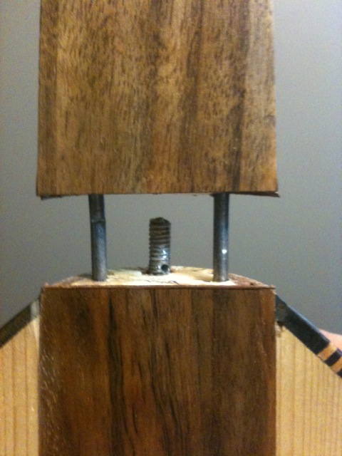

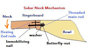

Sukars are known for a clear and loud tone, so it's unusual. But have you adjusted the action? If the action is too low, it will buzz, of course. Your teacher may not know it's adjustable. So let me assume you have not tackled adjustment.
First measure and write down the action at the neck-body junction, the average clearance of the strings above the fingerboard. If you don't have a suitable measuring device, like a small and accurate metric ruler, or a digital caliper, you can use the coins technique, slipping small stacks of coins to see what clears under the strings. If you have US coins, these are the rough equivalents:
Action height under strings:
2 dimes = 2.5mm
1 nickel and a dime = 3mm
1 nickel and 1 quarter = 3.5mm
2 pennies and 1 dime = 4mm
2 Pennies and 1 nickel = 4.5mm
3 dimes and 1 penny = 5mm
If the action is 2.5 mm or less, that could easily cause some buzzing. At 3.5 mm you shouldn't have any, and at 4 mm you get into high action, where the strings should sound very very clean. If your action is already high, and you have buzzing, it could be unrelated to the action, or you could have an uneven fingerboard, but there's probably not much point in raising the action further, except to familiarize yourself with it, or if you happen to love very high actions. If your action is medium to low, you should try raising it.
Reach with you hand into the soundhole by pushing the bass string out of the way, and locate the butterfly nut up against the headblock where the neck attaches. Then while very gently pulling the neck back, loosen the butterfly nut about 1/8 to 1/4 of a turn. You want to be pulling on the neck a little to even out the tension and relieve the stress on the nut. Imagine this: the Sukar neck, if the butterfly is loosened all the way, leans a little forward/up, and it's the butterfly nut tightened on the threaded rod that pulls it back, so it's angled a little back from level, where it should be. So there is always some force against the washer/butterfly nut. Pulling the neck back (gently!) is especially important when you tighten, so the nut isn't doing all the work, but it's best to do this whenever you adjust the butterly nut. Then release the neck, maybe work it gently a bit back and forth, and then let the instrument settle. After 10 minute or so, check the action and see if it has risen. If it has not, go back and loosen the nut all the way, to see what happens. You can experiment with the action to see if it cures your buzz, and you will want to find a good balance for playing anyway.
Just remember that as you tighten, never go past "finger tight", don't use tools.
There's a point past which the neck has "bottomed out", it's when the nut won't tighten any more, and tightening the nut further will only strip the threads or break the little nail you can see on the back of the neck, that serves to immobilize the threaded rod, which otherwise would spin freely and prevent adjusting the nut. If your Sukar action does not go as low as you would like, and with settling that sometimes happens, you (or someone) will have to pull the neck and file the mating surfaces, so the neck can be pulled back further. Look at the diagrams and photo, it's best if you have a clear picture in your mind of how it works before you adjust it.
SukarNeck1b.jpg - 13kB SukarNeck1c.jpg - 17kB SukarNeck_IMG_0192L.jpg - 83kB (threaded rod pulled out)
