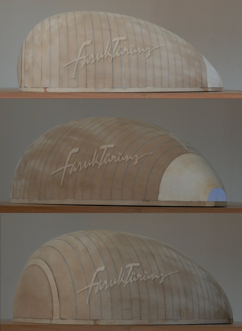

FLOATING BRIDGE OUD PREPARATION
Hi All !
I've just finished the roughly processing of a new mold.
I'll use this mold for constructing the new model: FLOATING BRIDGE OUD.
KALIP2.jpg - 89kB

Dear Greg,
I should have long brought out this model in pursuance of people's ongoing demand.
This project seems to occupy my workshop for a good period since we are planning to organize the whole production process of this model in a new concept:COMPLETELY COMPUTERIZED.
Firstly, the mold which is shown by the picture is a model. I am going to have half of this model (either the right part or the left) scanned and have that data mirrored. Then I will get the real mold made on a CNC router. In this way both sides of the mold will be symmetrical. For the soundboard analyzes on ANSYS I need a true geometry.
Secondly, I will design the soundboard and its braces using ANSYS program.
Warm regards,
Faruk

Faruk,
I understand that the model of the mold will be scanned and the final mold will be made with the CNC router.
The CNC router is excellent for making repetitive items accurately and cost effectively.
So, what I am interested to know - are you planning to make multiple molds for the same oud which are very slightly varied, so that you can minutely customize a clients request?
Will the ribs be laser cut as well, based on the 3-D readings of the mold?

Quote: Originally posted by oudistcamp
Faruk,
Oudistcamp,
Your understanding is of a highly wide perspective...and source of inspiration. Who knows? Maybe one day the oud world widens enough and need for mass production arises, then producing the oud with high-tech comes to order.
My aim is rather related to a childish enthusiasm. My deceased father sometimes used to say to me, whenever I tie up something exceedingly, " Faruk, you have an inessential curiosity to know the essence of everything. World is consisting of things without end... No one has ever accomplished to know everything in that respect!"
It is sad that life drives you to a narrow path where you have no luxury to slum in those districts anymore!
Thankfully my occupation which was my childhood fancy is full of somehow "mysterious" unknowns.
Anyway it was time to follow my father's advise and concentrate on less issue!!! Concentrating on those "unknowns" I came up with the truth that luthiery has a magic scope that takes you to the field of discoveries and innovations, thank goodness...
Recently you have advised me to write a book covering my experiences and experiments on oud craftsmanship. You are right. In order to make it easy for the future readers to fall out of some miss perceptions about the oud making "secrets"; I will show how an oud "works". Such a book must contain many items pertaining to sight, many elucidative graphics, pictures and an effectual CD-ROM. I will show how to design an oud's visible body on the computer. This may not be an unaccomplished renewal, I know, but behavior of an oud's soundboard hasn't been shown so far for all I know.
This project will cover ANSYS analyzes necessarily. Although I made the analyze of one of my soundboards and laid it before the respected followers of these forums; I have an intention to use the ANSYS program as the main instructive material of my book. So I will kill two birds with one stone: I will have an extremely flawless oud mold to make our Floating Bridge Ouds and also a fine digital data taken out of that for the ANSYS probes.
As you see childhood never ends up if you wish:)

I decided to use the model mold for the construction of some pilot products after having it scanned...For now I need to finish the apparatus to cut the oval sound holes neatly...:)
This idea sounds good oudistcamp:) . I have contemplated your question, although at first it seemed to me as a project which might come to my agenda some time later,
I admit that it is a brilliant idea. Yes, I am thinking of making multiple molds for the same model which are very slightly varied, so that I can minutely customize a clients request?
I am greatful, thank you:applause:
