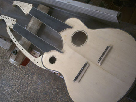

Well, it reminds me of all those wonderful evenings and days we spent together in your workshop - trying to make ragmakamtar #3 which was like a guitar - and therefore we could not take advantage of your brace tuning method...... but now my ragmakamtars are so similar to ouds, that logically it seems that your method should work perfectly on these instruments?
So yes I think now it is time to test out your method on my next ragmakamtar. . . . I wonder if we could do this over the internet or it would be necessary for me to come down to Istanbul (I have been meaning to visit again for a long time).
I think this could also be an ultimate test of your method also (which is obviously working with your ouds) - which so far has not been tested by another luthier, correct?

Yes Eddi, I always remember those times with blessing: During our talks I've gained a good vocabulary thanks to your adequacy in English as a native speaker; also I had the chance to think over on it. As a result I could revise and refine the "Brace tuning and Calculation Method".
So, you may think that the older ouds before this revision and refinement had not been so good...No, they were liked by the oudoists and also I liked them; but they were not exactly like what I had assumed. Tuning Method was working in a different mechanism other than the way I had been considering up to time I fully understood it. It was working but in different intervals: For instance I was hoping to allocate a certain Frequency to a particular area, but either the fourth or the fifth of that frequency was settled there. This allocation choice is critically important to be able to assess the high range fundamental string frequencies around the bridge area and the overtones of the bass strings to the onward parts of the S.B. ( closer to the neck) Thus you feel the wound strings sappier due to their overtones are resonating enough. See my post to this thread:Wrong design of soundboard may cause loose string http://www.mikeouds.com/messageboard/viewthread.php?tid=2945#pid192...
As for your proposal... OK. Why not? You can send me the layout of your new Ragmakamtar's S.B. Together with the eigenfrequencies you "hear" by tapping the central points of the brace locations on the S.B.
I need to know the frequencies of the strings on it as well...
I may propose you some RRF's and we can discuss. Let's go Eddi in that way!
