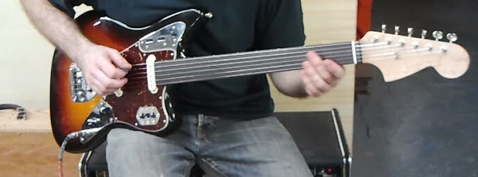

I recommend just having the guitar be fretless. I just got my Fenger Jaguar refitted with a great fretless neck (Drew Bradshaw again), and it works well b/c this guitar has a smaller scale to begin with compared to most other electric guitars.
I use the medium D'Addario flatwound string set (.13-.56) in a typical Turkish tuning, and they work great. I doubt that you would need heavier for Arabic tuning either, should work fine. Don't want to over-stress the neck!
It's fun!!!

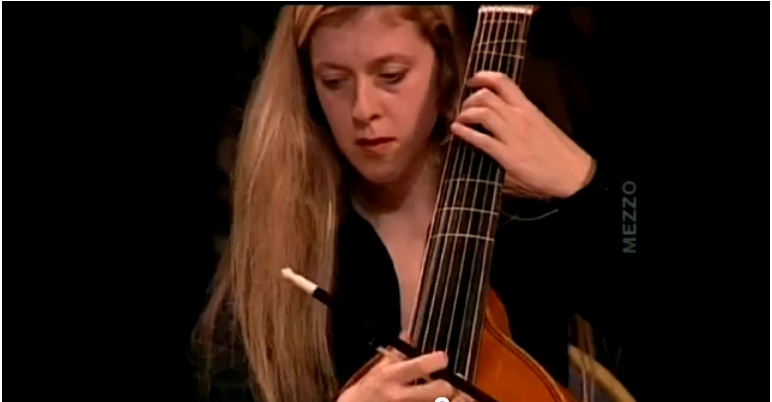

I'd agree that a fretless neck is a better solution, and tying on frets is always possible. Tied-on frets are routinely used on many instruments, including Saz, Lute and Viola da Gamba. Nothing "second-rate" about tied frets. Very versatile. See how this player has staggered the frets for "quarter tones".
