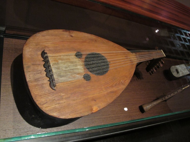

Posts: 3440
[*] posted on 3-4-2013 at 10:44 AM
No better example of wide (and wild) grained oud sound board than the seven course # 0164 oud in the Brussels M.I.M. (image previously posted on this forum by Danielo). This oud probably dates from around the end of the 18th to early 19th C.
Note the multiple piece soundboard (some panels being close to slab cut) and the pin knots! No idea of what it sounds like though.
The characteristics of what potentially makes a good sound board are known well enough (stiffness to weight ratios, low internal damping etc.) and a good luthier should be able to select the best material for a sound board, by experience, from a wide choice of sound board material even if it means joining smaller pieces to make a multiple piece sound board.
Grain width, orientation, degree of grain deviation etc. may or may not make a difference acoustically - it all depends upon the skill of the luthier and the required end result.
Some classical guitar makers today are building sound boards with stiff centre panels and less stiff 'wing' pieces to achieve the acoustic result they are seeking. It is possible that the old oud makers may have done the same thing to vary the cross grain stiffness of their sound boards - for whatever effect.
