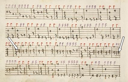

Here is an example of use of a split course from an early 16th C manuscript of lute tablature (the so called Capirola Lute book).
This is Italian tablature notation - the horizontal lines represent the six courses of the lute - treble at the bottom bass at the top - with the fret positions represented by number 0 = open string, 1 = first fret, 2 = second fret, 3 = third fret and so on. The coloured 'flags' above the lines represent the time that a note is to be held - pretty much the same as in modern staff notation.
In this example (where indicated by the arrows) on the treble third course one string of the unison pair is continuously stopped at the third fret, the second string of the pair being alternately sounded open (fret 0) and stopped at the first fret (fret 1).
Is there not a Turkish style of playing where the finger nails are used to stop the strings rather than just the finger tips? This might easily lead to a 'splitting of the courses' style of playing?
