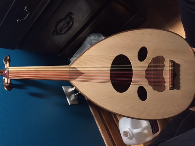

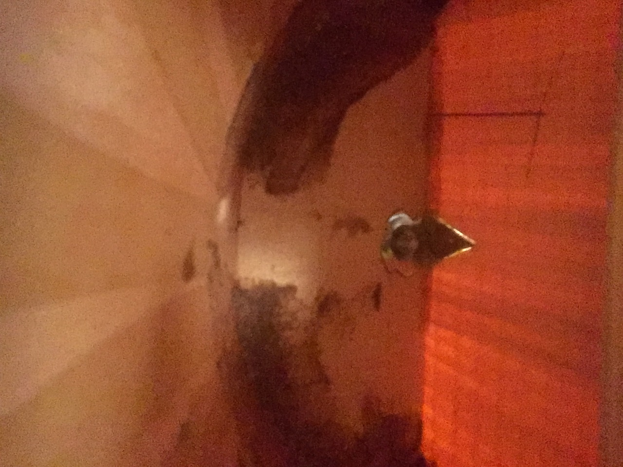

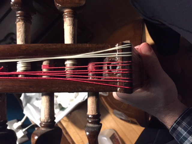

Anybody here have experience with these Syrian Zeryab ouds and their "truss rods"? There's a bolt behind the nut that can be adjusted with an allen key like a guitar. From the inside it looks like a threaded rod coming through the center of the neck and attached to the neck block. I'm assuming that tightening the bolt in the pegbox pulls the neck back a bit and lowers the action but I'm afraid to make any adjustments yet.
I bought this last summer and it sounds great but now with the winter I just noticed my action got a little higher. Possibly also because I was hanging it on a guitar wall hanger :( I realize that's a dumb move now.
Anyone own one of these or worked on one before?

I HAVE JUST EDITED THIS POST, I WAS WRONG WITH MY FIRST INSTRUCTION SO HOPE YOU DIDN'T SEE. I DON'T KNOW IF YOU SHOULD TRY TURN THE ROD This looks like a Sukar oud (are they called Zeryab ouds now?) If it's a Sukar oud there should be a wing nut but it looks like it's missing. I think you will need to replace the nut, find one with the same thread, and tighten it until just firm. Then tighten it about an eighth of a turn at a time until the action lowers. You should not need to turn it more than three quarters of a whole turn. Keep the strings at pitch do not loosen them. You may need to loosen just one course to get your hand in. The action should lower. It is a great system and if it works you will be very pleased with how easy it is to set the action of your choice. Good luck.

Actually alejofar, it may not have had a wingnut as there is access to turn the rod at the neck end. I would therefore guess that this is the same type of truss rod arrangement seen on steel string acoustic and electric guitars. If so then I guess it needs to be turned using an allen key. Same will apply i.e. it only needs be turned a little at a time. You can check out this for info/discussion http://www.seymourduncan.com/forum/showthread.php?212622-Truss-rod-... I wouldn't be too shy to have a go as long as you go slow and easy.

looks like there is some kind of threaded insert. Actually it looks like it has begun imbedding in the neck block from the pressure.
What happens when you tighten or loosen the rod? you can see if it does anything to the action. My guess is it is simply a metal rod which wouldn't change anything to the action.

So I turned the rod just a quarter to the right and it lowered the action perfectly. I was worried that it wouldn't do anything or worse, that it would crack the neck, but the system works great!

Sorry, I've been off the forums for a while and I missed your question. I turned the rod clockwise to lower the action and counter clockwise to raise it. So far haven't had any issues.
