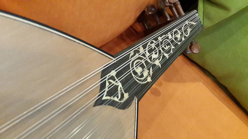

Greetings to this wonderful forum,
i noticed that my sukar oud has an additional unused peg as well as a corresponding hole in the bridge, juxtaposed to the C bass string hole.
Therefore, in principle, one could double the C bass string.
I was wondering if any of the forum members has attempted this in the past and if the sound is pleasing to the ears?
Best regards
The luthier Huosain Sabsaby often makes his fixed bridge oud like that. See the picture. Ans a lot of other picture on his FB.
https://www.facebook.com/huosain/photos?lst=1035023207%3A1521400902%...

I think the double bass on Sabsaby's are FF or GG. His C-cc ouds usually have single C ..
I suppose one can add double C but it might not sound great as both strings are thicker and have low tension which would result in sound that's less
pure!

The oud is actually already quite small to have the low C string. Some people have doubled it, but the results are debatable. If the oud has a
longish scale (61-62cm) you'll have a better shot. Using a heavier string would help.
On thing that you could do is double it up an octave, something like .025-.026in wound string would likely work.

You'd need very heavy strings under high tension to stop them slamming into each other (not an attractive sound). And a specially constructed oud to
stand up to that tension.

it did not work: during the restringing process, i noticed that while there is an extra peg and an extra hole in the bridge, there is no dedicated
path on the nut...

Yep. Did it myself in the past out of curiosity but wasn't overly keen on the result. The C string vibrated better and was more sonorous when it was
single. I understood why it had remained single all throughout the years....apart from rare and notable exceptions....
