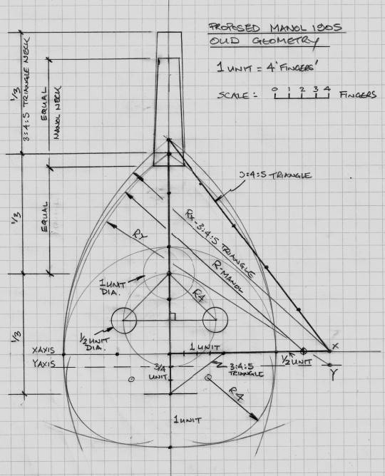

hello every one ,
I have started to make my first oud , I will build it as manol sketch , but I don't have manol brace method, and the measurements of brace to give
turkish oud sound , can anyone help with skitch like this in attachment , thanks .

what do you think is the best shape of braces to give turkish sound

Hello Mohammed
do you have access to Facebook ? In this case, check this. It will give you an idea of the thiness of turkish bracing (manol original or inspirate ? I
dont speak a word of turkish):
https://www.facebook.com/huseyin.aktel.1/posts/10152787795572440
It is tricky and Nothing can over balance experience for thinking the bracing. i recommend you check the flexibility of the soundboard of a lot of
ouds if you can to make an idea on how far you can go. Too stiff you'll kill the sound, too flexible the oud will get old bad under string pressure
(the soundboard may bump and the get unplayable). For positionning the braces you have of course a lot of receipe. But octave braces seems rather
consensual. A good basis also can be positionning the rosette on the classical style you wish (folowing a renowed old master) and position the brace
dependng the rosette, that will give you a good basis though not all the braces. I cannot assume it as truth, just an hypothesis i illustrated
there:
http://www.mikeouds.com/messageboard/viewthread.php?tid=15903
i made three tries. The color of the sound change depending on the receipe of brace positionning for sure but the main will be on your way to think
flexibility of the soundboard. I believe it is good also to make a work on asymetry, you have many way to achieve: on brace height, thickness,
positonning, soundboard thickness also
Just the opinion of an amateur though
Best regards and good luck in your project
