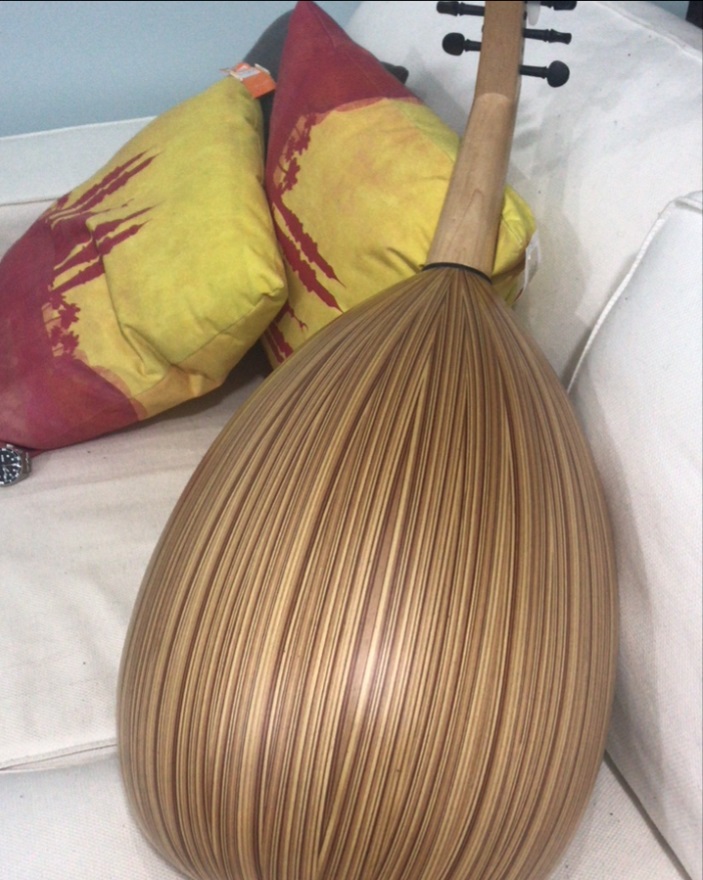

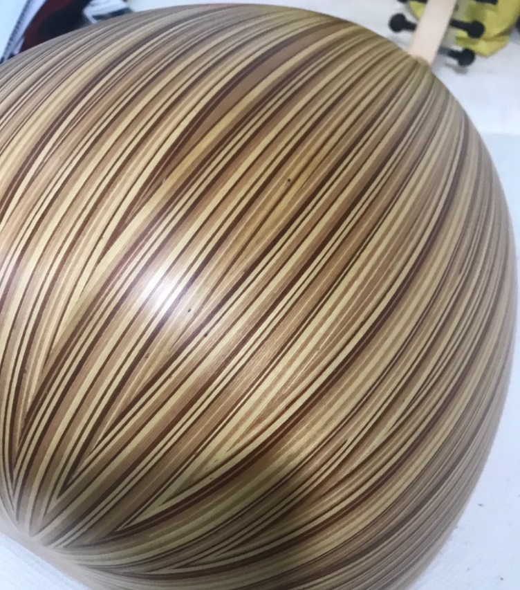

What kind of wood is this?
Hello all,
Last year, I purchased an oud on impluse from "Music Spot" store in Bahrain as I left my oud in the U.S and had an uncontrollable urge to play.
The oud sounds amazing, very crisp, like an excellent moving bridge oud, but I'd like to know what it's made of.
I asked them through instagram about the type of wood, they said it's palisander. It does not look like any palisander I've ever seen.
I also asked an oud maker about it, he said it's most likely an inferior wood from Pakistan but did not know the name of the wood.
Can somebody confirm what type of wood this is?
bhoud2.jpg - 244kB
bhoud.jpg - 177kB
[*] posted on 3-6-2018 at 10:43 AM
my best guess is that is Zebrano wood. Also known as Zebra wood.
but the pattern is too perfect and repetitive. Almost like a printed plastic veneer in that it has no pores and grain variation.
Are you sure it is wood? can you take a picture from the inside of the bowl if there is no rosette, we can see what the other side of the ribs look like.

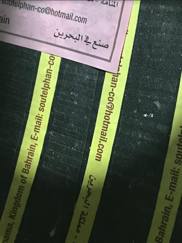

Also, there's something "different" about the inside of the oud.
It seems it has been sprayed with some black plasticy material (feels almost like carbon fiber, but it's not)
I thought it was strange but couldn't make anything of it!
At first, I though maybe they glued 3 different types of sheets of cheap wood randomly and then sliced them from the side and used the slices as ribs which explains the black stuff (to hold the thin slices together?)

This is why the inside of the oud is covered in black, to hide the actual wood used to construct the bowl.

Ha! Yes I thought it looked like plastic veneer. It's actually impressive they were able to make a oud with that. I think it's usually pretty thin... On the flip side it doesn't move with humidity so it could be durable depending on the kind of glue they used.
In the end if you like the sound and it was cheap it's all good. Also chances are the store has no idea it's not real wood.
But one thing for sure it's definitely not cheap wood from Pakistan. Lol some people talk out of their ace.

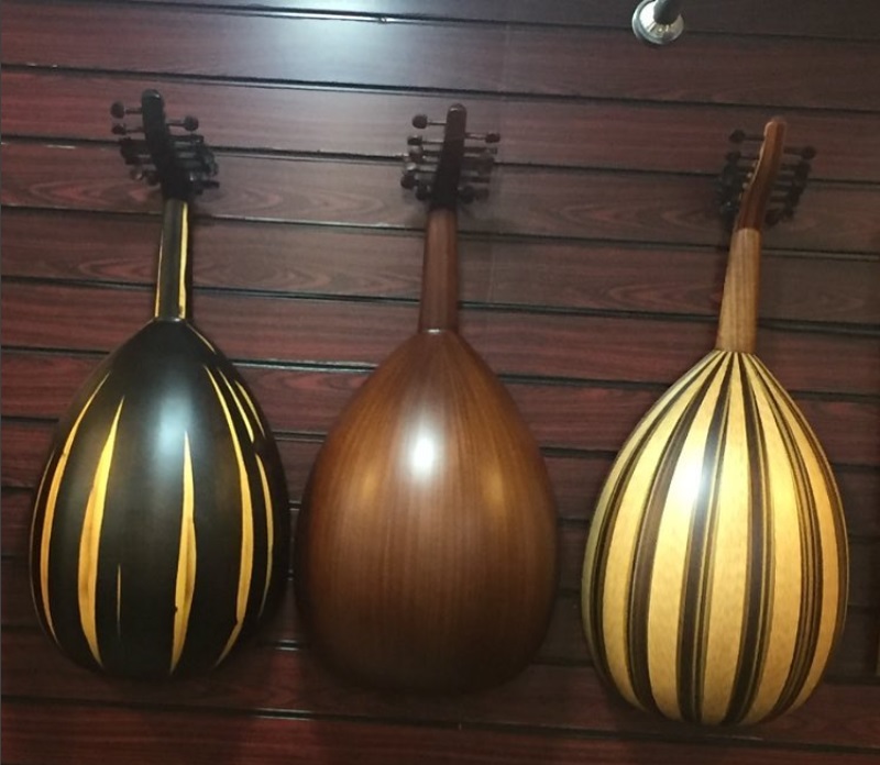

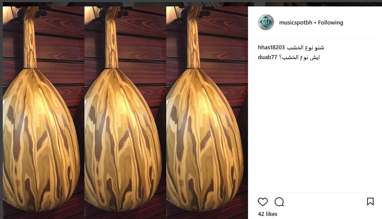

Check this oud out (attached), it's on their instagram.
Unlike my oud, this one looks artificial but people are asking about the type of wood with no response..
They should at least say it's not real wood and claim "innovation" instead of not saying a word at all.
They also sell ouds covered with veneers that look exactly like real ebony, rosewood, etc.. (Attached)
I hate to say it, but this is unethical unless they state clearly that they're only covered with veneer.

Nothing wrong with reconstituted wood veneer. However, due to the absence of grain variation and wood pores, I actually think this is plastic like a formica type of material.
In the end if it sounds good...
