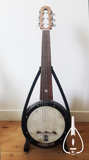

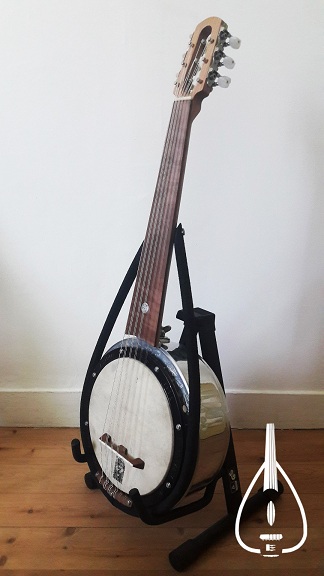

I am glad to show you my new acoustic instrument ! Here the prototype called "Cümbüş SBD" I work a lot to mix the turkish Cümbüş and the
classic oud in order to make an instrument with many advantages : comfort of playing, balanced instrument, high sustain, adjustable action, nylon set
strings, steel keys for tuning, french wood, foldable and robust to travel ... In my opinion, a perfectly adapted instrument for oud players
Please use headphones to listen the high natural sustain

That sounds really really beautiful Sylvain!
I am always amazed at what you are accomplishing.
I don't know much about the cumbus yet, but I really like this!
Is the white soundboard made of skin, like a banjo?
Great stuff!

Thanks a lot Mattoud,
That is a natural skin. I tried a plastic model but balance is different. Natural = hot bass, nice balance, long sustain. Plastic = high treble, hard
medium, very long sustain !
Me too I appreciate the sound a lot. Also I feel it more ergonomic than traditionnal oud. Body is a bit low deep than oud ...

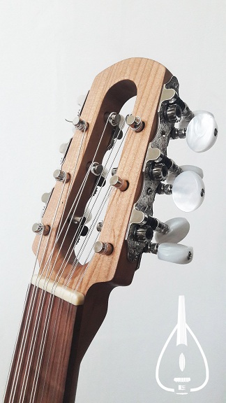

I didn t take precaution for skin because I don't have this problem of tuning. Do you try to change for another skin ?
Other thing Keys on my instrument are very different than classical cumbus keys. I have another cumbus with olastic skin and the tuning is difficult
and change a lot because keys are cheap and bad.
Maybe you could put better quality here.

I bought the body and made neck, bridge, tailspiece, and bows my self. Furthermore the head is a special compact designed that i drawn on CAD
software. Hard to make it !
