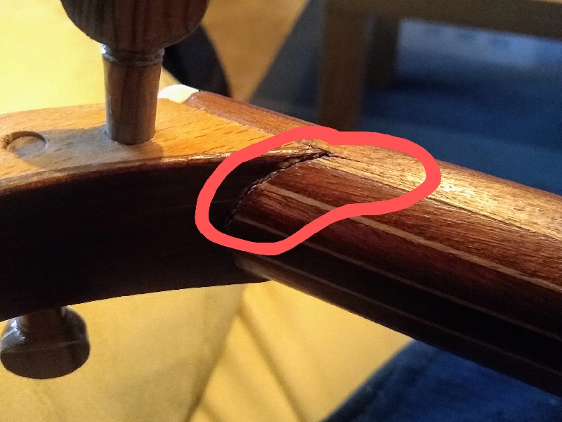

I was recently able to purchase a cheap second-hand Tharwat Saber oud made in 2004, probably a very basic model. It doesn't look like it's been maintained particularly well, but there doesn't seem to be any warping of other "big" problems.
The oud itself sounds OK and seems to hold its tuning reasonably well but there are a few problems.
The first problem (pics attached) is there is a small crack on the neck, and another similar 'crack' along a rib join. I can't tell if these are mostly just cosmetic and I can more or less ignore it, or if this is likely to develop into a bigger problem which I should deal with?

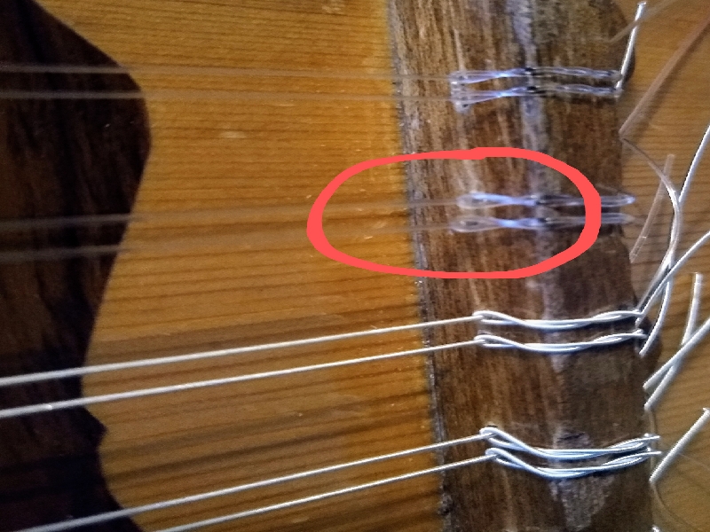

The second, and the most annoying, is that the holes for G course on the bridge are not evenly aligned - one is slightly higher up than the other, and is very noticeable when playing.
Any advice on how I might fix this problem? Would the whole bridge need replacing?

1/ the peghead joint has indeed broken, most probably with a crack going along the neck. May have happen during shipping, rather common under pressure of others parcel.
take off the string and check how much it has open, and glue it back in place.
The shape of the wood block should make it fit easily and perfectly. If a bit loose, find your way to hold it in place the time the glue to dry.
I had the problem, it is very stable crack once glue back, thank to the direction of string pressure, it will not move once glue again
2/ you can fill with glue to which you can ad some wood dust , from sanding a piece of wood of an approcahing color. To work clean you can put some tape along the crack..Which not really a crack, most probably the ribs which were not perfectly fitting when the oud was build.
Or you can also leave it as it is
3/ the bridge, i think to be neglected iof you are talking of stringlength.
If there is a noticeable difference of string height under the risha you can level string height at the bridge, using pressure of you fingers to lower or higher the node of the string at the bridge, from where the string get out of the bridge
If a matter of string length, try working on the node. But i think it is so small it should be unnoticeable

Sorry point 2/ I missed you say it is noticeable while playing. In sound you mean or just the difference of height ? If the problem of height only you can work the node higher or lower at the neck. If only this and you don't find the way send me mp with whatsapp number I will make you a video explaining in how to make this

Regarding the bridge problem: it is string height which is the problem, and it is making trilling very difficult and also very noticeable under the risha. The two holes for the string are at different heights (this is visible in the photo if you can see where the strings come out). I'm not exactly sure what you mean by the "node"? Are you referring to the "loop" which the string passes through at the bridge-hole, or the "notch" on the nut which the string sits in?

I think to understand the issue, the bridge picture was unclear for me
Yes I'm talking about the loop at the bridge.
It is very useful to know this tip. When you have an action which is too low, or unequal fingerboard making buzzing you can proceed on the loop at the bridge to give more height to the strings.
Taking the strings you pull on it at the bridge and get it higher. It will be easier to do loosening a little the strings. You can make it also full tuning . I think this way you can settle them at the same height.
I will try to make a video showing this, not sure though if it will be easy to show it clearly. I'll try

This way
https://youtu.be/ttersa9DsGo
. If you don't make it the strings will go more or less from the level of the bridge hole it is coming out through. But you can pull this way to get it higher...or just push it back
Only one you cannot get is lower than the bridge hole of course :)
I make it extreme way. It dont think it is desirable to have the strings too high at the bridge because of the torsion it will give to the bridge
Can you solve the issue this way ?

For the action, yes maybe the neck has work or the neck body joint is broken so you will have to think of a neck reset.
But first really check the joint of the peghead to the neck.
You can get very surprise, I mean under string tension it can hold perfectly in place. But when you will get off the string you will see it moves easily i...or even you might take the whole peghead off !
Obviously the peghead joint to the neck is broken and this might explain the high action
