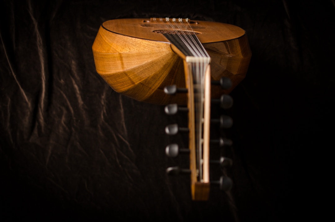

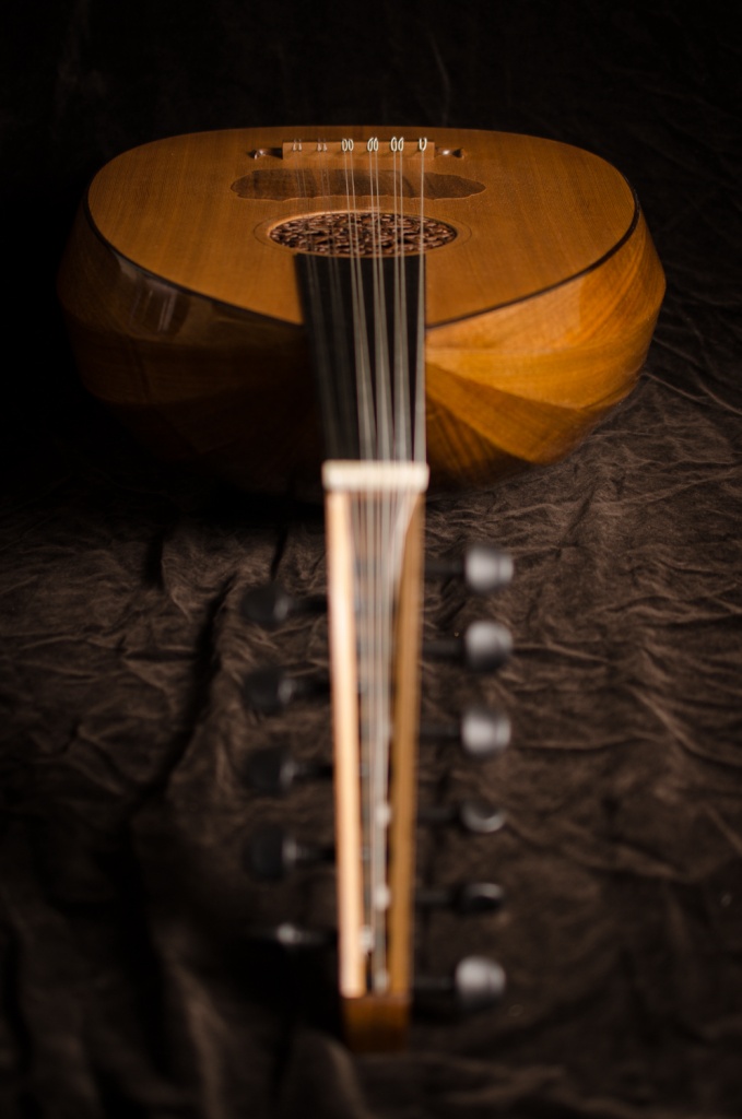

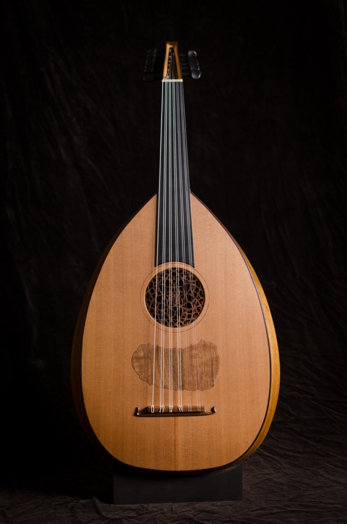

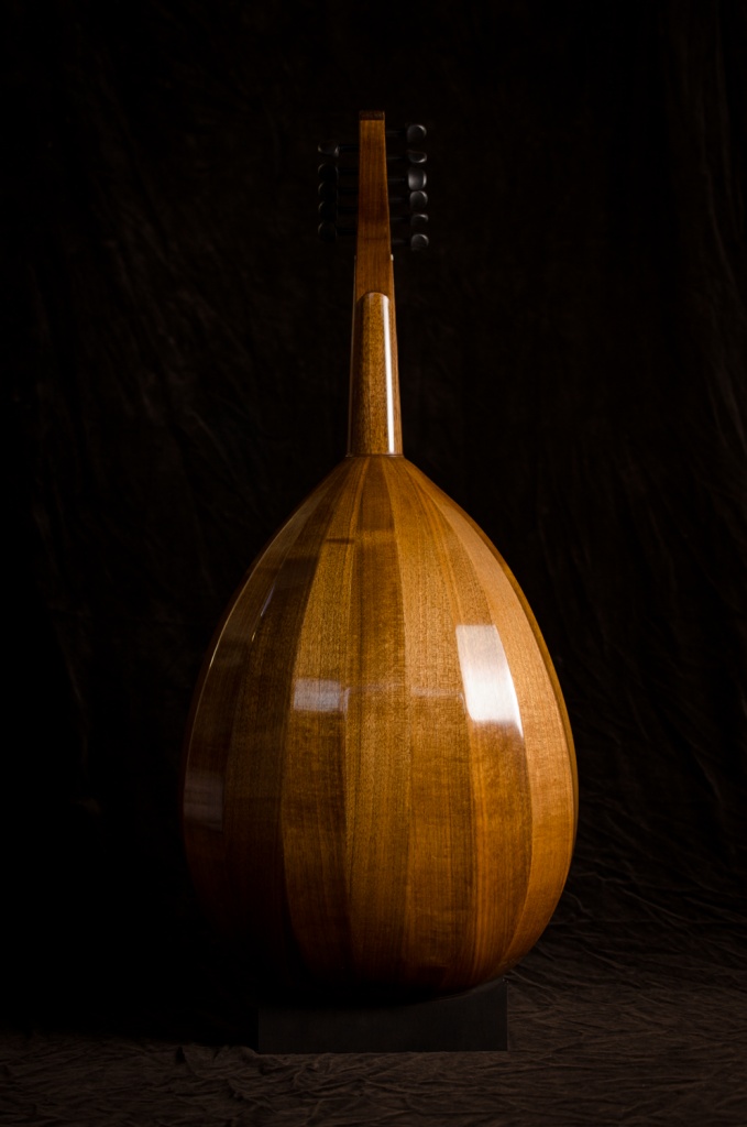

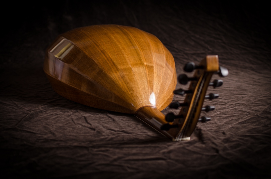

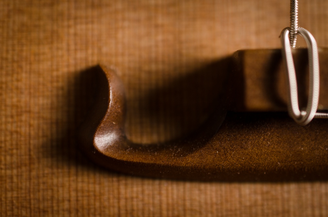

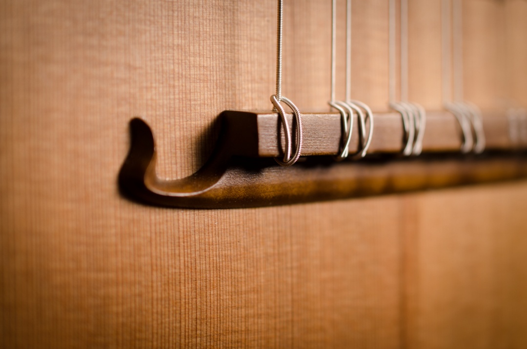

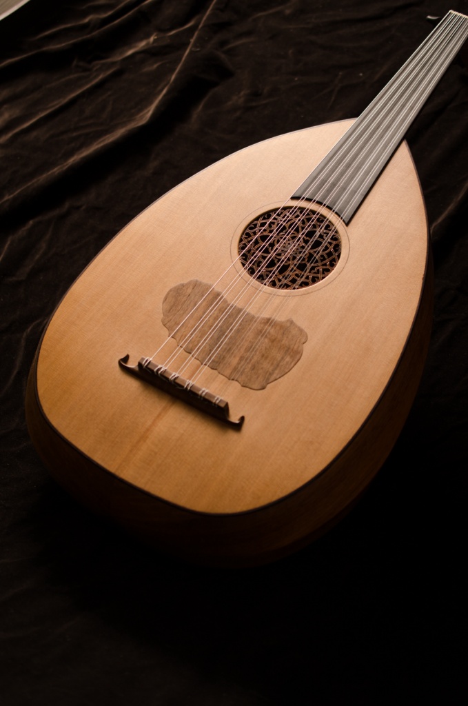

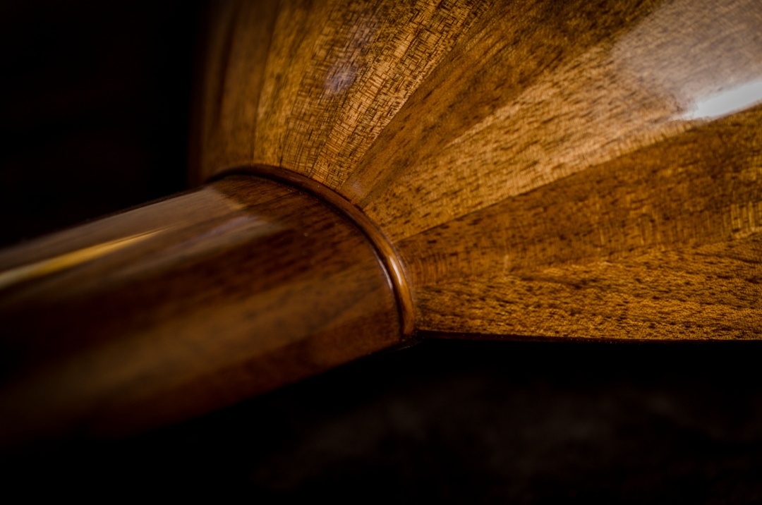

I just received a brand newly made oud, equipped for the first time with the Enhanced Wood type of top construction.
This construction has been described recently in an article by Sebastian Stenzel:
http://stenzel-guitars.de/resources/pdf/Enhanced_Wood_2020.pdf
This oud again has a cedar Enhanced Wood top and walnut ribs, black walnut neck and a sorbus domestica bridge in one of the renaissance styles. It is
sparsly ornamented upon my request; wanting to keep the price as low as possible. It has Wittner violin geared pegs (which are the way to go for a
stable and secure tuning with absolutely no adventures with slipping pegs etc.). They are finely geared and allow for a very precise tuning without
guessing.
At the same time the oud has obtained a new shape (so again it is a prototype - I have a standing tradition with Sebastian to inspire prototypes:
Enhanced Wood classical guitar, oud(*), Enhanced Wood oud). It has a bigger body volume with at the same time narrower top improving projection and
treble response. At the same time the bowl is much flatter than usual and the side ribs are strongly slanted towards the middle, so that holding the
oud becomes soooooo much more ergonomic than with the traditional design.
As to the sound: one of my first reactions was to tell Sebastian "If I was a more sentimental person, I would have cried of joy".
