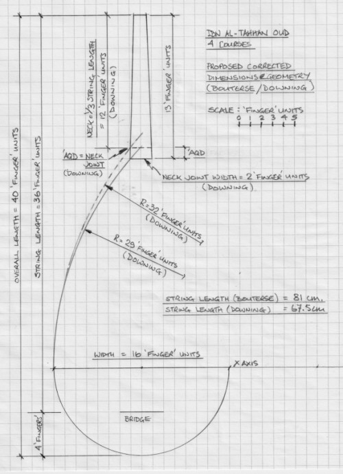

[*] posted on 3-4-2011 at 08:35 AM
What is wrong with this Oud?
The attached image is a scale drawing of an oud described by 14th C writer Ibn al-Tahhan al-Musiqi according to the translation/interpretation of the sole surviving manuscript by Dr H.G. Farmer.
Farmer was puzzled about the low placement of the bridge (which he thought odd) but was not otherwise concerned about the size of the oud which he described as being of "considerable dimensions" and a "real archlute". He was obviously not an oud or lute player!
It is not always clear and now impossible to determine - without access to the original manuscript - what Farmer has translated word for word from the original and what is his interpretation of the text.
Farmer gives Arabic linear measurements as 'isba' = 2.25 cm and 'isba madmum' = 4.5 cm as well as 'shibr' = 27 cm but does not give the source for these assumed metric equivalents. He then goes on to give the measurements of the oud in terms of 'asabi' and 'asabi madmuma' - presumably as written in the original manuscript(?). Farmer also (strangely) gives the neck length as "= 1 shibr + 1 'aqd" giving the metric equivalent as 29.25 cm - again without clarification - from which it might be assumed that 1 shibr = 12 isba and that the neck length is then equivalent to 13 isba.
Something is not quite right here!

[*] posted on 3-4-2011 at 11:13 AM
Note that in creating the geometry of the oud according to the dimensions given I have assumed that the lower sound board profile below the widest point (the X axis) is a semi circle, that the upper sound board profile is described by a circular arc of radius R with its centre on the X axis, and that the width of the neck joint is 2 isba (or 4.5 cm using Farmer's metric equivalent). R in this case works out to be exactly 48 'asabi madmuma' units (or 96 'isba')
Curtis Bouterse, writing in The Galpin Society Journal #32, May 1979, proposes that the odd proportions of the oud are a result of scribal error - the scribe mixing up the 'isba' and 'isba madmum' in defining the length, width and bridge placement. This gives a more reasonable result proportionally but may not be the complete solution. Bouterse reasonably assumes that the lower sound board profile is a semi circle but makes no attempt to define a profile for the upper sound board. He also accepts Farmer's metric conversions for the linear units as well as the 'strange' neck dimension which, if valid, does not result in what turns out to be a more elegant solution to the final geometry (in my opinion).
Farmer assumes that 'aqd is a linear unit of measurement but what was his source? - he does not say.
ALAMI gives the meaning of 'aqd as 'knot' earlier in this thread. Several Arabic-English dictionaries give 'knot' as a definition as well as related meanings such as ' bound' or 'tied tightly' or 'knitted together' or 'joined' or 'a binding agreement or contract'. One sole dictionary source also includes 'inch' among these definitions.
So did Farmer or his linguist advisors know of some, now obscure, alternative definition of 'aqd - a linear measurement of value 2.25 cm or equivalent to an 'isba' unit? There may be one possibility.

Hey John, this oud-zilla cannot be real, we are getting something wrong!
May be when they used "asabi' madmouma" they were still counting in ones.
I mean that when they say 20 isba' madmouma they don't mean 20 X (4 fingers), they may be still mean 20 x one finger.
Another thing, the famous novel "Tom Thumb" is translated in French "Le petit poucet" and in Arabic "iqdat al isba'", literally the finger knot.
A finger knot in common spoken Arabic means the finger middle joint, what if the aqd is the upper half of the thumb? It is around 2.5 cm.
[*] posted on 3-5-2011 at 08:11 AM
Thanks ALAMI. Interesting as my thumb measures pretty close to 2.3 cm at the middle joint so perhaps this is the answer to Farmer's source of unit size?
My proposed solution follows a more complicated argument and - with no knowledge of Arabic on my part - may turn out to be completely invalid. Nevertheless, let's go through the arguments just to see where it might lead.
OK, OK! to avoid confusion due to potential problems in interpretation/comprehension I shall now stick to the term 'finger' unit as the basic unit of linear measurement this being the width of a finger at the middle joint (but not including the thumb). So, for example an 'isba' will be one finger unit, an 'isba madmouma' will be 2 finger units, 8 'asabi' will be 8 finger units, 20 'isba' will be 20 finger units ... and so on.
On my hand, four fingers (madmouma) measures 7.5 cm across giving an average value of 1.875 cm for a finger unit - this value, as it happens, agrees with the 'standard' finger unit of ancient times it would seem.

[*] posted on 3-7-2011 at 11:46 AM
Interesting to note that the Romans considered an inch to be the width of a thumb whereas the rest of the ancient world used the width of a finger. A Roman foot was equivalent to 29.6 cm (80:81 of an Egyptian foot of 30 cm) and it was divided into 12 'inches' equal to 2.46 cm.
So this presumably is the origin of ALAMI's thumb 'knot'.
However, I do not intuitively believe that 'aqd' in the Ibn al-Tahan manuscript refers to a linear measurement. After all why would the scribe when recording measurements (albeit in error) in the standard units of 'isba', 'isba madmoum' and 'shibr' suddenly decide to introduce another, more obscure, unit of measure? It just doesn't make sense.
Although the original manuscript copy would need to be re-examined to verify this - I suspect that 'aqd, used in this context, means the point at which the neck joins with the bowl i.e. the neck joint - emphasising that the length of the finger board (1 'shibr' or 12 'isba') terminates at the neck joint.
Let's see how this concept works in practice with the proposed corrected dimensions and geometry.
[*] posted on 3-7-2011 at 12:21 PM
The Revised Ibn al-Tahhan Geometry
The attached image is the proposed geometry of the Ibn al-Tahan oud - drawn to scale in 'finger' units - according to the corrected dimensions proposed by Curtis Bouterse and my proposed upper sound board profile, revised neck length. and assumed neck joint width of 2 'finger' units.
With the shorter neck length of 12 'finger' units (as opposed to 13 'finger' units given by Farmer) it can be seen that the neck length is then 1/3 of the string length which is the classic proportion found on ouds to this day. The radius of the arc describing the upper sound board profile increases from R = 29 'finger' units to R = 32 'finger' units. The significance of R = 32 'finger' units will become more apparent later.
It is useful, for purposes of comparison between oud/lute geometric profiles to express R in non dimensional (ND) units where the width of a sound board is divided into 4 equal parts. In this case each part is 4 'finger' units and R becomes 32/4 or 8 in ND units.
Another point to note is that if Farmer's value of 'finger' unit, equal to 2.25 cm, is applied the string length becomes 81 cm. Ibn al-Tahhan mentions that he no longer used frets on his oud which implies that a finger unit of 2.25 cm is incorrect the string length of 81 cm being practically unmanageable for a fretless oud - or even for one that is fretted.
On the other hand using a 'finger' unit of value
1.875 cm gives a string length of 67.5 cm - another significant measurement as it turns out.
Ibn al-Tahhan Finger (500 x 690).jpg - 80kB
