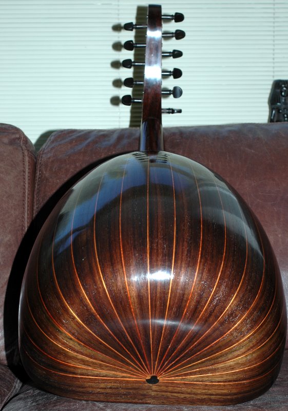

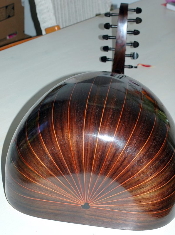

sabbassi - 4-26-2010 at 12:10 AM
Mav,
this is your oud at his final stage. I will try to ship it this week. it is light weight one , less than 1 kilogram.
the bridge is from Walnut and the the pickguard is pear, both stained black.
the soundboard is Canadian bearclaw spruce, not varnished but waxed for minimal wood protection.
soundhole purfling: pear, berk and wenge
soundboard purfling, rosewood
strings: Labella Arabic Tuning .
(will be shipped this week.)
hope you will enjoy it,.
DSC_8671.JPG - 85kB DSC_8673.JPG - 300kB
DSC_8661.JPG - 93kB

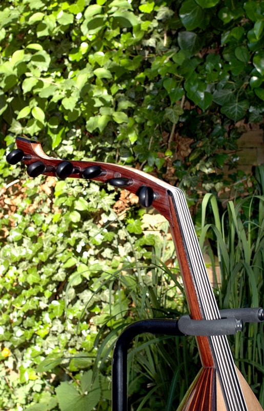

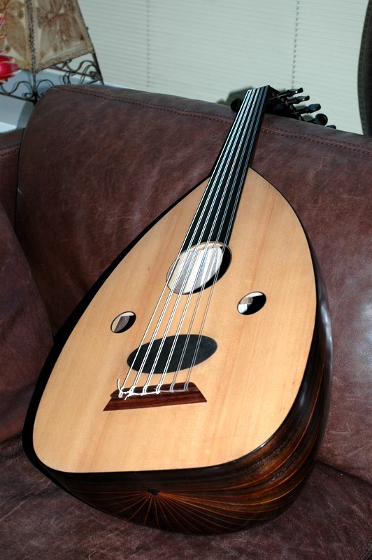

sabbassi - 5-30-2010 at 12:59 PM
And here is number 3, the indian rosewood.
the oud has high grade indian rosewood ribs, for the bowl with solomon paduk purlfling in between. Epecia soundboad with Eeony purfling around it.
the neck is solid rosewood,
I will try to mound the peg box and the bridge this days.
the bridge is will be Rio rosewood or , Indian Rosewood. I'm not sure yet.
enjoy
Reg
Samir
DSC_8811.jpg - 352kB DSC_8817.jpg - 340kB

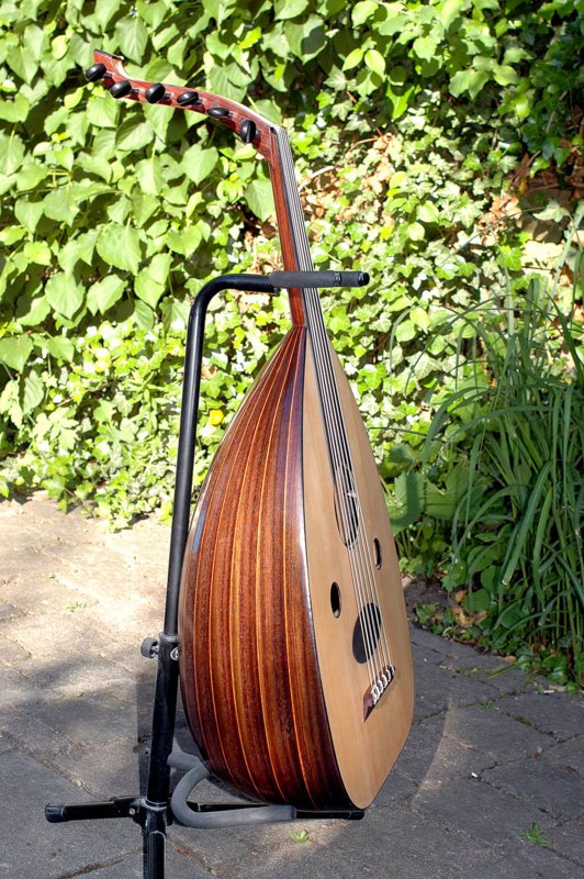

the oud is finished
sabbassi - 6-3-2010 at 04:14 AM
here are some pictures of the final oud.
No Frensh polish this time, light coat of tung oil thined and waxed.
DSC_8876.JPG - 160kB DSC_8878.JPG - 133kB DSC_8888.JPG - 98kB DSC_8893.JPG - 90kB DSC_8895.JPG - 96kB

sabbassi - 6-6-2010 at 10:16 AM
Hi chris
Wel only on the soundboard, very little. the bowl is french polished.
here is a sound file, it is crispy and very mature.
Attachment: Indian rosewood.mp3 (863kB)
This file has been downloaded 264 times
Aymara - 6-6-2010 at 10:52 AM
Hi Samir!
Aah ... I wondered how an oiled body could be that shiny ;)
I think the oil/wax will prevent the soundboard from darkening by skin contact?
This combination of indian rosewood body and spruce soundboard is absolutely fantastic ... I have it on my oud too as you know, but also on my 12-string western guitar. This wood combination rocks!
If I ever should buy a second oud, it must be of the same woods.
