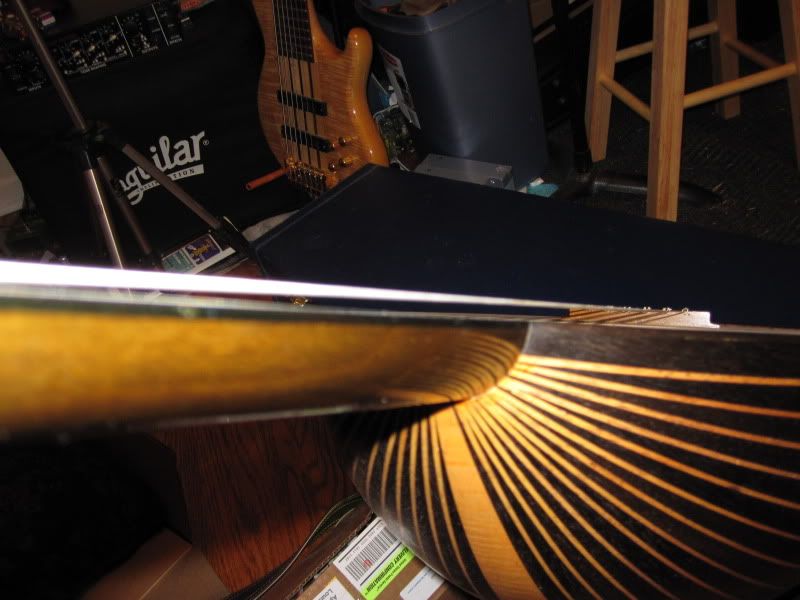

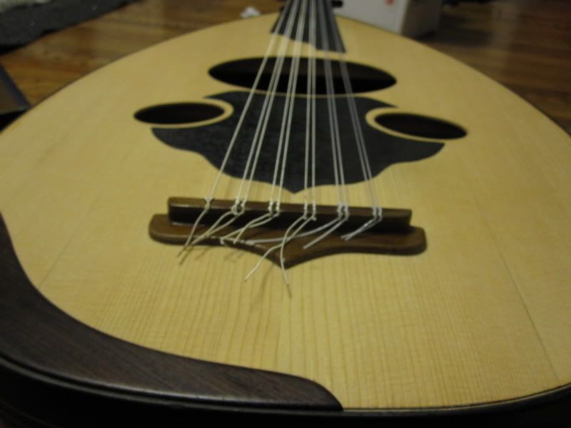

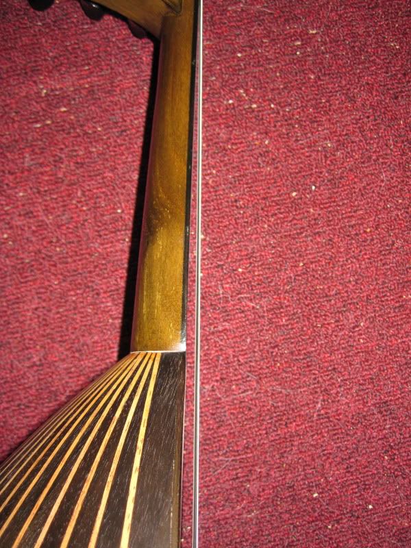

Problem 1) The action has become unplayable. As a large Arabic oud the action has always been what I would call medium-high but something has gone
wrong over the last year or two. I do have the wingnut hand-tightened all the way but it doesn't seem to help. The strings are actually extremely
far off of the face even before they meet the neck joint. What's the usual course of action in fixing this? It would seem as though a new set of
holes could be drilled lower on the bridge.

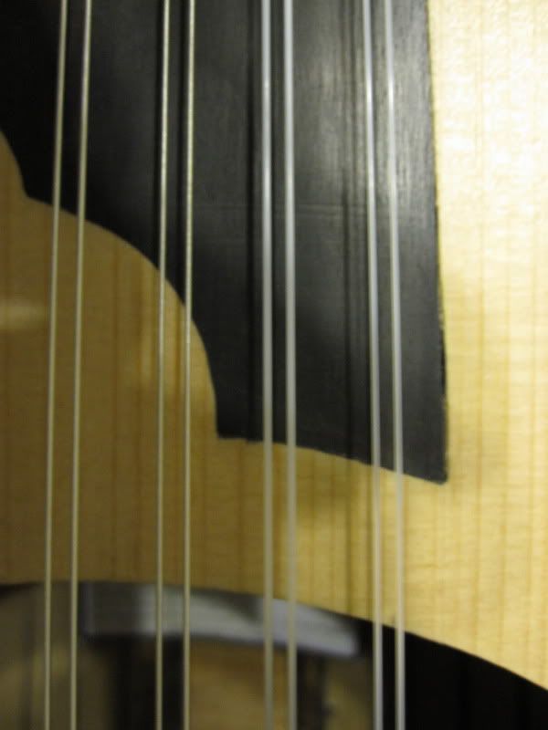

Problem 2) One of the things Jameel did was reinforce the top. It's a three piece top and the pieces seem to be separating at the seams as well as at
the extended fingerboard. Jameel installed butterfly joints to hold them together and I assume that's what is keeping it from getting any worse. I
just worry that the splitting will continue.
I have considered looking for someone to build a new face for the oud with a new bridge. Any idea on what something like this would cost? I really
like the sound of this oud when it's in good health but it's not doing me much good right now.

Also, that little separation in the top near the fingerboard is quite normal. It can easily be filled with some ebony. There doesnt seem to be a
structural problem from that. It happens as a result of the drastic changes in humidity (winter vs summer) spruce absorbs more humidity and thus moves
more then the adjacent ebony.
Jason, I have to run now, but look up the posts dealing with the neck adjustment mechanism, including photos. Fixing an action that has drifted beyond
the available adjustment range should be pretty simple. It involves removing the wingnut and pulling out the neck on its pins, then re-leveling the
faces where the adjustment is made to extend the range of adjustment, and putting it back together. I plan to do it on one of mine that is still fine
but at the limit of adjustment. Maybe we can do it together". Once you get that solved, the oud will be playable and you might decide the face doesn't
actually need to be rebuilt, except for aesthetic/perfectionist reasons, and if it's playing well, maybe just leave it alone. It does seem like
there's a humidity issue, maybe you can make a bucket humidifier (folded newspapers as a wick in a bucket) to keep a room at steady himidity.
As I look at the the photos it seems the neck is a bit warped-concave, so when you pull out the neck you might want to level the fingerboard too, you
can take it a couple of millimeters down I think. It doesn't seem to me like the soundboard needs replacing. Is there anything loose or rattling? You
could insert a sliver of spruce in the two "cracks", it's not all that difficult, but if it's not at all audible i'm not sure it's necessary, and
maybe with humidity changes it needs to have that "slack". You need to see if the "cracks" close up at times, because if you wedge in some wood it
might stress it if it closes up e.g. at higher humidity. And BTW it looks like a beautiful & cherishable older Sukar; I wouldn't butcher it. What
model does it say it is, and what date? Hopefully the neck will just pull out without a lot of ungluing horse-play. You can probably do all of the
work on the neck in a couple of evenings.

Well this is a very old thread but I finally got around to looking at this oud again. With the strings slack when I apply light pressure to the
pegbox pulling backwards I can see the neck separating from the neck block. Obviously with the neck pulled back the action lowers quite a bit.
At this point I'm not sure if the nail is broken but that is a very good possibility. Is the neck actually glued in or is it only held to the body by
the bolt and flexing rods? Should I try tightening the bolt now that all of the strings are loose?
Hey Jason,
nice to see you around again.
So yeah, now that the strings are loose, try to push down on the top of fingerboard lightly to make the action go down and tighten the bolt while
holding the pressure down on the neck.
not very much glue is used and I have seen the glue they use fail very often. If you want to see if the nail is broken, try to loosen the wing nut
completely and then grap the rod itself and see if you can rotate it by hand or pull it out. the nail breaks when the bolt is overly tightened with
too much pressure. In the repair I did, the guy had snuck in a wrench to tighten it as hard as possible and felt it pop.
