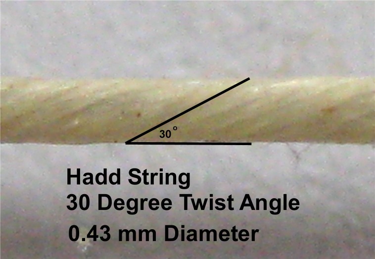

[*] posted on 9-6-2010 at 12:44 PM
The broken pieces of the Hadd strings have been subject to testing to determine the breaking load and stress - useful information in order to establish optimum string design.
The broken string pieces were subject to a straight pull using a simple spring balance to apply a loading. The spring balance is not a very precise piece of equipment so was calibrated (approximately) using standard weights from a commercial grocer's scale.
After several tests, the average breaking load was established at about 5 Kg (11 lbs).
The string diameter is 0.43 mm which gives a calculated breaking stress of about 35 Kg/sq. mm. (49,000 p.s.i.)
Interestingly this is about the same as the breaking stress for gut trebles of the 16th and 17th C (average value
34 Kg/ sq. mm. - source Mimmo Peruffo, 'The Lute in its Historical Reality').
Using the Mersenne-Taylor Law, if the strings were raised to a pitch of a' sharp @ A440 (frequency 466 Hz) the strings would be above breaking load (5.24 Kg). Practically (historical experience), the pitch of the trebles should be set at about
2 -3 semitones below this theoretical value (for gut strings at least) in order to avoid frequent string breakage. This practical rule of thumb would bring the maximum working pitch of the Hadd strings to a bit less than g' @ A440 (392 Hz).
So f' sharp @ A440 (370 Hz) should also be about the optimum pitch for the silk Hadd strings.
The degree of twist of the silk filaments in string construction affects the ultimate strength of a string - the smaller the angle of twist (low twist) the greater the breaking load and ultimate breaking stress. The attached macro image of the Hadd strings indicates a twist angle of about 30 degrees. Further reduction of this degree of twist (consistent with producing a uniform cylindrical string) would produce a string of higher tensile strength.
String durability will also depend upon the abrasion resistance of a string - as individual filament are broken by the action of a mizrab or risha - or by localised wear on a fret - then the strength of a string is reduced accordingly.
Hadd String Twist (758 x 523).jpg - 69kB
