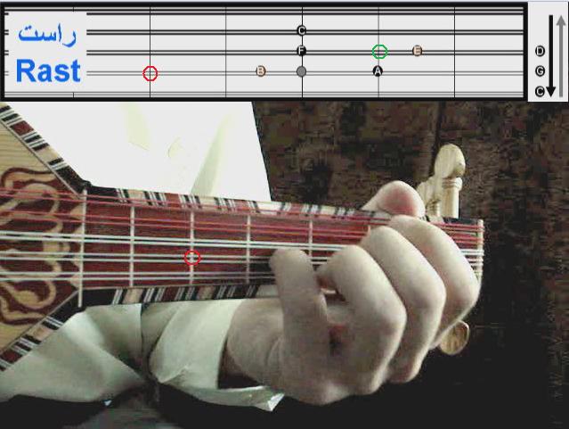

First of all, almost every maqam is like a western scale in that it consists of 7 notes plus the octave note, so it's convenient to consider it 8 notes total, where Rast starts on C and ends on the c an octave up. May as well play it that way.
Arabian tradition has a different name for what western tradition calls the same note an octave up, they call the base C "Rast" and the high c "Kardan", but it's an octave, C to c.
You're playing it like a major scale. Rast is not a C major scale. There are two main departures from a major scale:
- the E, the third note, is flattened a quarter tone, not quite down to E flat that we would consider a minor third, but lower than a major third.
- the B right below the C is flattened a quarter tone (to B half-flat) when playing on the way up and flattened a half tone (to B Flat) on the way down. If you end the scale on the high c, instead of on the B the way you did, you can nicely play the B differently on the up and down.
You can hear it very clearly here:
http://www.maqamworld.com/realaudio/maqamat/buzuq/maqam_rast_C.rm
This is not all that unusual, in western music the minor scale is often handled differently in ascending and descending melody lines, look up "melodic minor".
If you are not marking the neck or the strings, I think it's worth doing for a while, as it's a good way to see how the half flats lie between the "natural" notes.
The screen capture below is from OudProf's DVD. You can see how the B half-flat he is fingering is between the B natural and the B Flat, and the diagram shows how the B half-flat is played when ascending, and the B Flat when descending. The position of the c Kardan on the 2nd string I circled in red and the E natural( that is not used in Rast) I circled on the diagram in green.
RastOnOud2.jpg - 47kB
