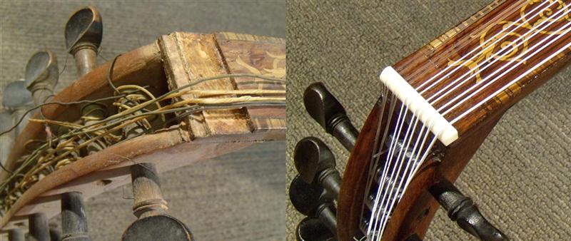

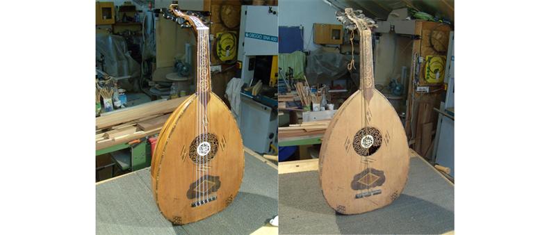

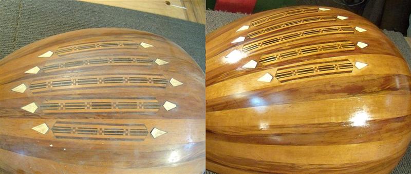

Just to emphesize... (-:
2 (Medium).jpg - 67kB 3 (Medium).jpg - 56kB 4 (Medium).jpg - 43kB

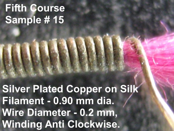

Yaron has found another two string fragments from the oud that he has mailed to me for examination. These are both silver plated copper wire wound on silk filament measuring 0.9 mm diameter.
The first fragment (#14) wire diameter is 0.16 mm, winding clockwise, filament dyed red - so this is the same as fifth course fragments #03 and #04 listed in the previously posted inspection report.
The second fragment (# 15) on the other hand has a wire diameter of 0.2 mm wound anti clockwise on silk filament dyed purple - so is likely to be from the same manufacturer as the fourth course strings.
Note that the silk filament of the core is dyed so the silk has been 'degummed' (i.e. the sericin of the raw silk has been removed reducing the density of the silk to about 1.35 gm/cc.) The silk otherwise has not been 'weighted' to increase its density by the addition of metallic salts - verified by the burn test)
For overspun strings it is possible to calculate an equivalent string diameter of the core material. This is an approximate calculation giving an equivalent solid silk string diameter of 1.3 mm for the fourth course and 1.7 mm for the fifth course. Fragment #15 has a calculated equivalent diameter of 1.8 mm. Solid silk strings of these diameters (like gut) would be pretty dull sounding but - theoretically - the fourth course would sound at about A#, the fifth at F and fragment #15 a tone lower at F (all at A440). So these calculated figures are close enough to confirm that these fragments are from the fourth and fifth courses for Arabic tuning CEAdgc'.
Unfortunately no fragments of the first and sixth courses survive.
Note that the images of the fourth and fifth courses in the inspection report incorrectly give wire diameters of 1.0 mm and 1.6 mm (!). They should of course be 0.1 and 0.16 mm.

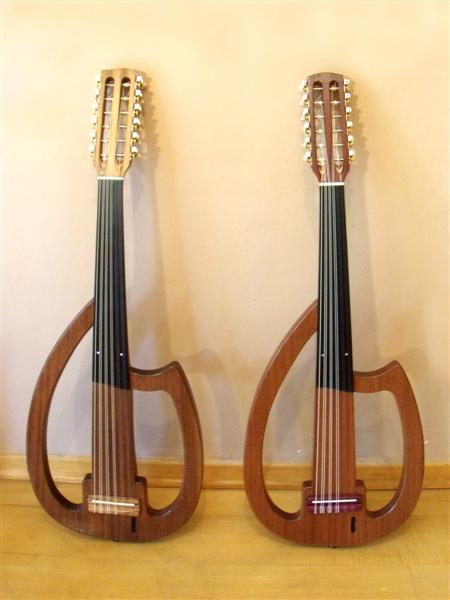

Yaron,
I saw on youtube one of your creations, the mandolaoud. It is beautiful. I just wanted to ask you if you build electric ouds and how much are they.
Thanks in advance

Quote: Originally posted by Giorgioud
Yaron,
Thanks in advance
Yes, I build electric ouds... I will send you a U2U
Thank you all
