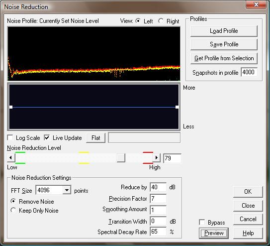

Here is the beginning of the piezo recording, with the native noise (whose spectrum is shown also) and then after reducing it. Where it came from in the first place was likely the noise of the PC fans picked up by the oud right next to the PC, with too much gain in some stage. Semiconductor and resistor noise are as inevitable as life, it's just a matter of when it becomes noticeable. The mic recording was done far from the PC and the mics were driven hard, so the gain could be kept lower.
Easy to cut noise down with today's technology. But notice that reducing that noise also affected the audio a bit, and the decision has to be made in the context of the total purpose. You would NEVER notice that noise in a mix, but you MIGHT notice some artifacts of vigorous noise reduction, so I would defer the decision until much later, not attack the noise at the outset.
Noise at the threshold of perceptibility is very useful to mask some problems, just as signal in turn masks noise. Whenever you decimate a recording from 24 bit down to CD 16 bit you HAVE to add a touch of noise called "dither" so you don't hear the artifacts of this reduction.
All the traditional analog systems of noise reduction rely on the fact that you only hear noise when it's naked, that's where the noise reduction operates. When the music is loud enough, nothing need be done. Modern digital algorithms take a snapshot of the noise, compute a FFT, and add its inverse to the material, with or without taking the total level into account. By storing the sound data in a "look ahead buffer", they can also "predict" clicks and transients and subtract them out precisely when they occur. If you really work at it, you can restore music from wax cylinders almost to perfection. And that's when you realize that going too far is a mistake, it sounds better with some of its original noise.
There is also something in the air of the quietest rooms that is audible as a sort of white noise. Of course you can completely muffle and soundproof the room until it is dead. A recording that is completely stripped of noise sounds dead and unnatural. As usual, things are complicated.
The bass of piezos is generally very good, but you often have to equalize if the treble is too strong.

Noise spectrum: SuzNoisePiezo1.jpg - 48kB
