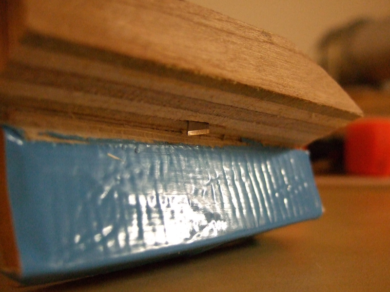

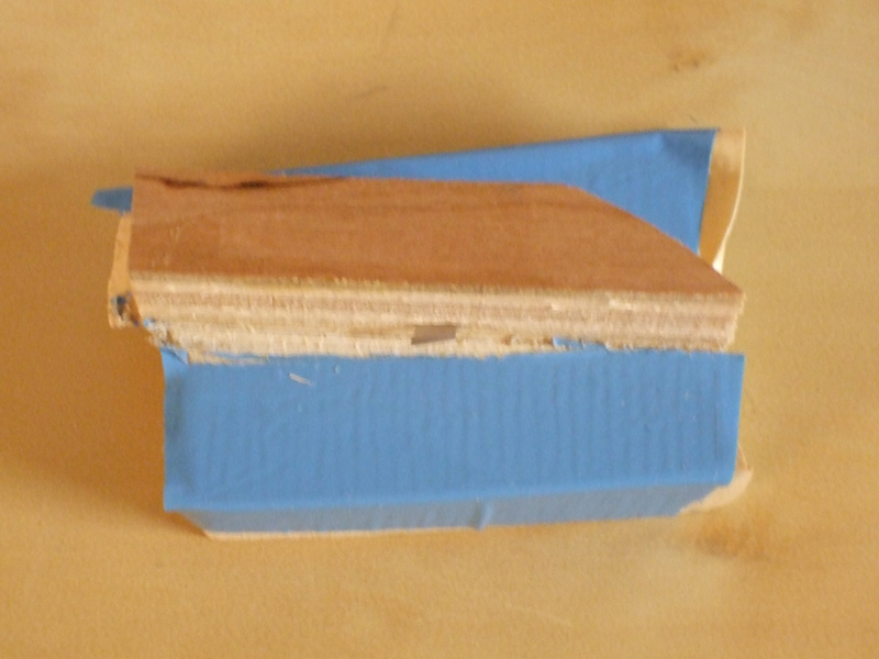

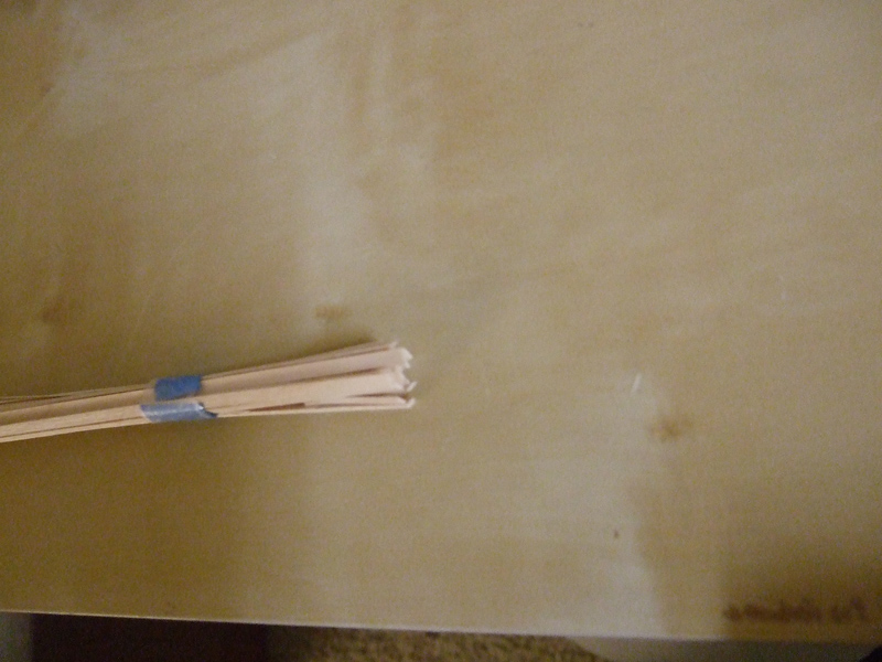

here is what I have done. I bought a thin veneer sheet (10"x48"x0.05") from Rockler for about $5 each (Rockler has a good selection of veneer with no backing) and cut the purfling myself using the tool I made (pictured below), its not fancy, but does a good job.
Basically, I used two pieces of scrap plywood. I inserted a thin blade at about 3mm from the edge of one of the pieces (3mm is the width of the purfling I wanted). I attached the other piece to side as a guide. The blue stuff you see in the picture is a tape that I used to smooth the plywood so that it glides against the edge of the table which I was using as a guide for cutting.
With this setup I was able to get about 30 purfling strips in about 40-50minutes. I can make it faster by spending more time making a better jig, but all I needed was like 30 strips and it wasn't worth the effort. Its pretty simple.
The purfling is pretty basic, but I could have done the same with layered sheets of white/black/white or something like that.
DSCF4193.JPG - 193kB DSCF4195.JPG - 238kB DSCF4198.JPG - 222kB
