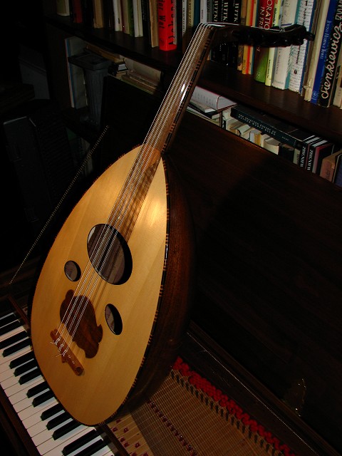

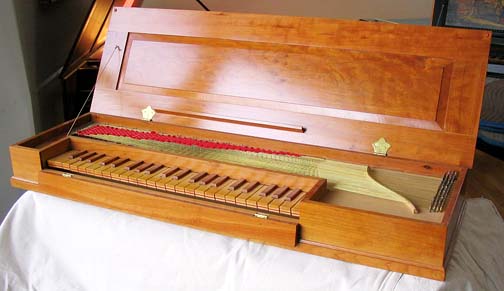

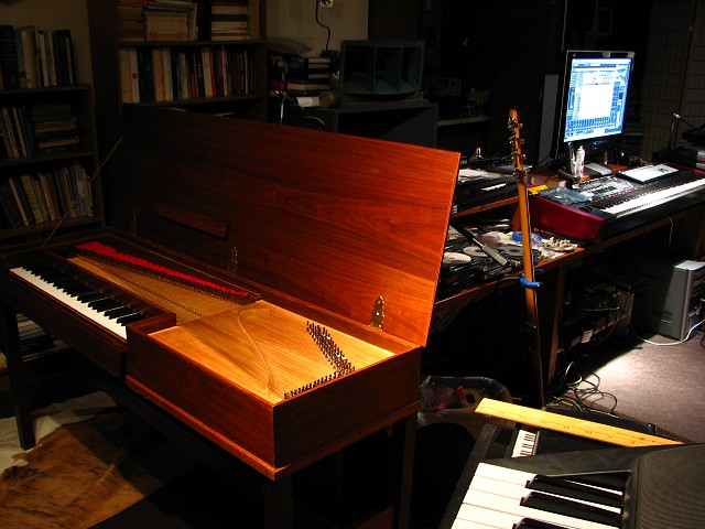

Ok, here is an example. There are two instruments on this clip: a Sukar oud on the right of the soundstage and a large Zuckermann unfretted clavichord center-left.
-- The Sukar is mic'ed about 12 inches from the soundhole with a Beyer 740 in omni mode and a tube Oktava MKL 2500 cardioid.
-- The clavichord has the Beyer 740 in cardioid mode on the treble strings and the Oktava on the bass strings, both about 3 inches from the bridge.
-- FET Preamps from a small Behringer mixer. The DAW is Steinberg, Record-time limiter is Steinberg magneto. Mixdown EQ is native Steinberg. Reverb is Oxford Sonnox.

Zuckermann full-sized unfretted clavichord.
Similar to Bach's and Mozart's Silbermanns.
59 keys. A double brass course is used per key.
Img_0067m.jpg - 81kB
Smaller Zuckermann travel fretted clavichord.
A double brass course is shared between
2 adjacent notes.
ZuckermannFrettedClav_2617clav.jpg - 54kB
My pampered Model 1 Sukar with
Belgian Polished Soundboard and
Tung Oil coating on fingerboard
Img_5351rm.jpg - 75kB
