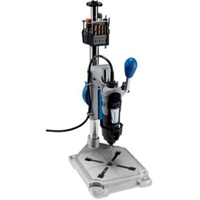

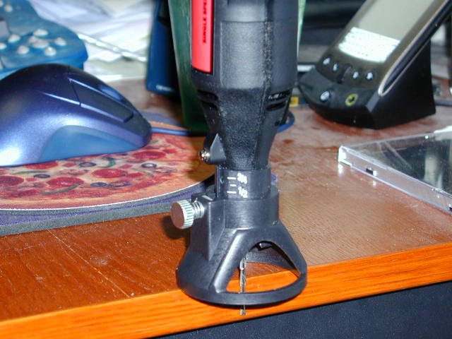

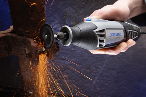

As far as tools go, probably the best thing for this job is a Dremel Tool using either a cutting wheel or a cutting bit. I have both. The cutting bit is like your brill idea, but you continue the whole cut starting from the hole. The cutting wheel I think would put less stress on the ribs. That would be a lot like slicing the top off an egg.
BTW for people here who don't have a lot of tools but want to make mods/repairs, the Dremel is a versatile power tool with inexpensive accessories. As soon as I get the $2 diamond coated bit I ordered, I'm trying making a rose with the Dremel drill press, the way I saw on a video, with the guy wailing on a funny drill-press-like tool with a belt drive.

well you didnt say you had a dremel... laser sword and dremels are pretty much interchangeable.
