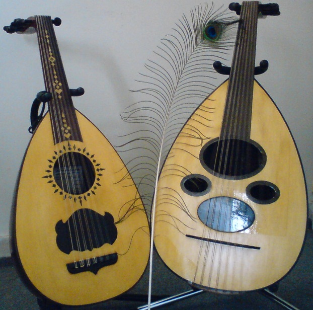

[*] posted on 3-29-2010 at 01:48 AM
do u mean this?(the left instrument)
if so, ive been playing that instrument for about a year n there was no problem(its made by sukar)

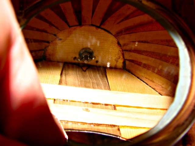

[*] posted on 3-29-2010 at 02:04 AM
No, Chris, the Sukar long fingerboard has a small space at the junction. The motion of the neck when making adjustments is so small that it looks like most fingerboards, no crevasse!
Oh and BTW, the long fingerbaords are rather loosely mounted in the soundboard. They are acoustically decoupled to a degree. You can see that in the photo along with the adjustment butterfly-nut. The whole point is so you don't mute the soundboard as you play the high notes. The floating fingerboard might be the next evolution.
Personally I don't like improvements that radically change the instrument, like saddles, floating bridge, machine-pegs(except those invisible planetaries). We know by now that the floating bridge and the saddle DO change the timbre quite a bit.
Img_4848m.jpg - 66kB
