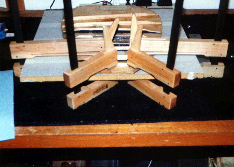

I guess. I'll leave such complicated woodwork to you experts. Me, I'm working on an adjustable neck, you can see it in prototype form below. The astute observer will note the microcontroller circuit board between the Formica resonator and the neck pull-rods. The fingerboard will be reinstalled as soon as we can find a place for it.
BrokenLute_38.jpg - 95kB

[*] posted on 4-12-2010 at 01:46 AM
:D Does that control the onboard mic simulator and octave divider as well?:D
:D
Just replace it with an accelerometer-controled note generator and a ribbon controller...:cool::D
