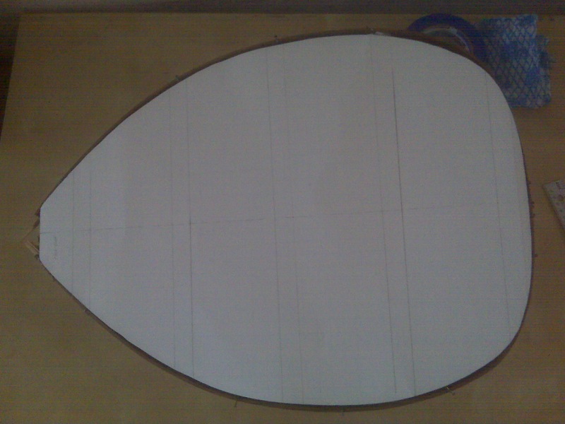

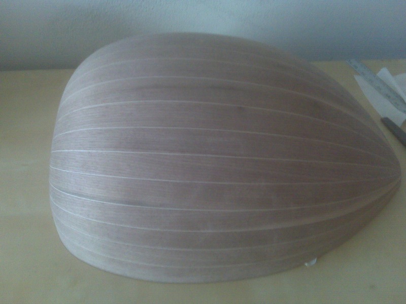

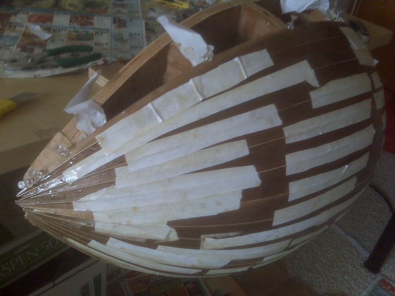

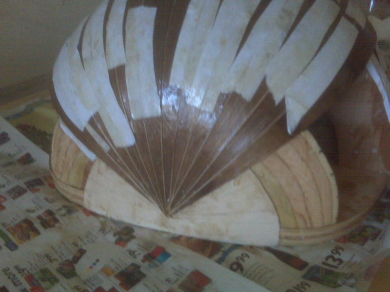

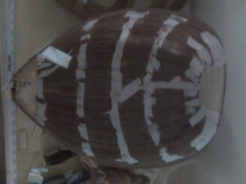

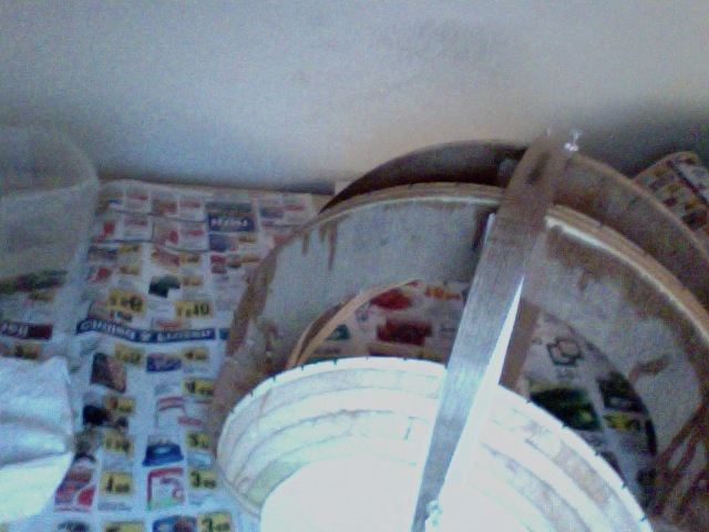

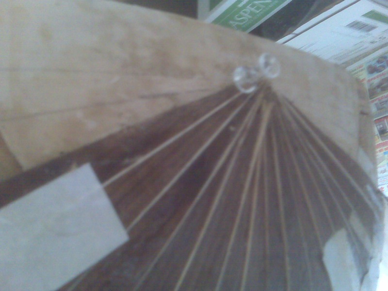

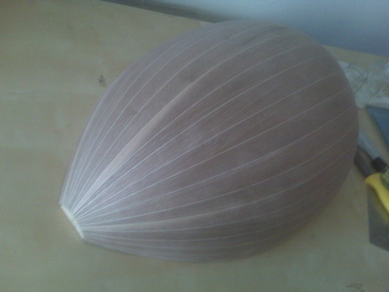

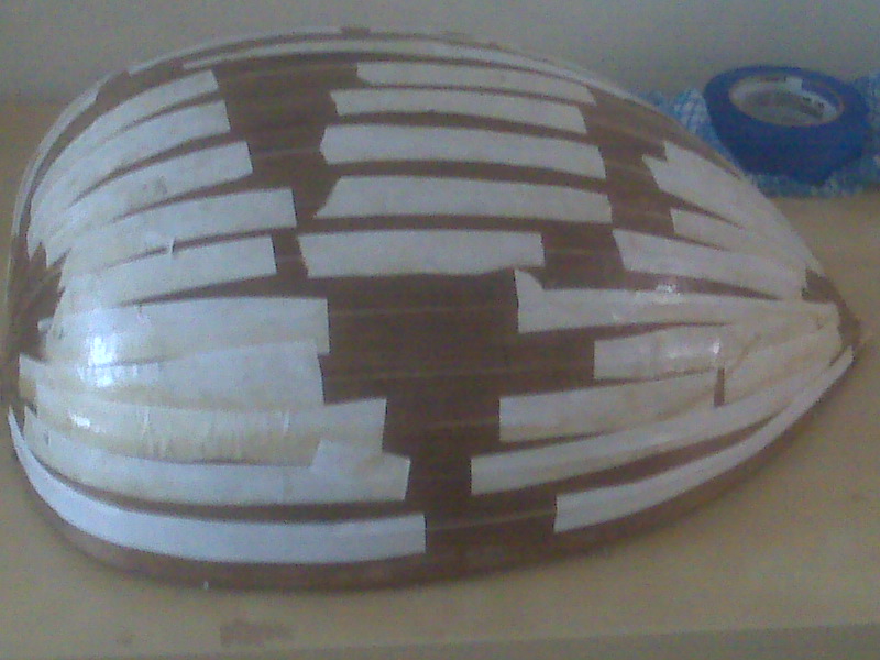

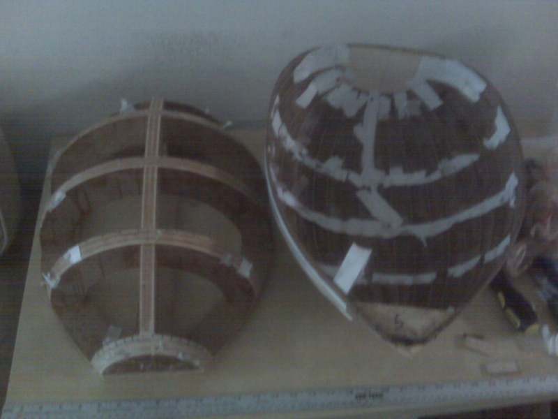

This past Sunday I finished the back of my first oud. It is made of 21 ribs of walnut with maple purfling
It was quite a bit of work. The result is satisfactory overall. The width ended up being 8mm more than what I wanted but it is acceptable. The width will be 37.8cm rather than 37cm.
Below are some pictures. The image quality isn't high as I only have a phone camera at the moment.
Two ribs were slightly off curve and as I assembled them they protrude up a bit by about 1-1.5mm. As I finish the bowl, the scraping and sanding will take care of that. The only thing is my ribs were 2.5-3mm in thickness and I am worried that the back will be too thin in these area.
I don't know what to do, I don't want to disassemble them and assemble them again as it is a lot of work. I am thinking of gluing some rib shavings to the inside to increase the thickness on the inside. I also thought about wood powder and glue.
The oud also came off the mould with no problems.

Looks great. It could be my eyes, but I can't see the problem that you are talking about.
I have made about 7 bowls so far, and I have never had the ribs line up just perfectly--the sanding can take care of that. I would try to keep the glue joint at about 1.5 mm, and let the sanding do the rest. It would seem, from the numbers that you mentioned, that that could get you pretty close to perfect.
As for the rib shavings vs wood powder and glue--I would go with the sawdust and glue, if you think that is necessary. It can be extremely strong. Just make sure that it does not give you a false sense of security, and you sand right thru to the sawdust/glue mixture in an effort to make the bowl perfectly smooth. It just doesn't look good. Also, if the surrounding wood is just paper thin, I would worry that the mixture might just knock out.
The sawdust/glue mix is also good, of course, if you have any gaps (small) between the ribs.
Congratulations on your oud. It looks great.

I think your eyes are fine, but what you are probably seeing is the purfling sticking out. The pictures are not that high quality and the offending areas are not showing. The purfling is slightly thicker than the ribs. It is quite hard to see even when looking at the bowl directly. They are just a couple of small areas around the tightest curve.
Two other solutions that I thought of are:
1- Glueing a thin piece of walnut veneer to the inside of the protruding rib and scrape/sand smooth. The veneer is thicker (about 0.6-0.8mm). This also won't look good and might not be smooth enough.
2. Pressing the rib against a hot bender to try and correct the curvature. I am only worried about burning the glue between the ribs and being unable to glue them properly.
Overall I am quite pleased with the bowl. I think it came out better than I expected given the primitive tools I used.
Using Hide glue was also pretty friendly, except for the "sticky hand syndrome" that you get once you start inserting the perfling between the ribs. For that, I kept a small container of water nearby that I used to soak my hand in to get the glue off.
I can't say how much I am grateful for the comments and guides here on this forum and on youtube. Your first oud thread has also tons of useful information.
I will start working on the neck, and pegbox in the coming week. But for now, I have a weekend of scraping ahead of me :)

I think that idea number 1 just wont work. It's going to be tough to get it absolutely flush with the rib it is going to be attached to. And, in the end, I don't think it will help. If you are putting it there because you think you are going to completely sand thru the rib/purfling and are going to rely on the veneer, then you have made the rib so incredibly thin at that spot that it is just not going to hold up.
As for number 2: Don't know. Maybe. You used hide glue, which is a plus. I think it is going to be tough to do, but I can't see how it is going to cause any problems.
But, really--an oud bowl is never really perfect. Especially older bowls (even Manols, for that matter). Personally, I would just make it as smooth as you can without comprising strength or making it ridiculously thin, put on some sawdust and glue in the back, and then call it a day.
Finally, one last thought--if you happen to sand the rib down to a very thin level, you can also reinforce it by cutting out a piece of fabric (silk, or some synthetic), cut it to the shape of the rib, and glue it on the inside. It's not going to solve your problem, but it's something you can keep in the back of your mind if you make the rib just too thin. It's not great, but it doesn't add any significant weight, and it is of some help.

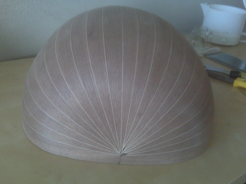

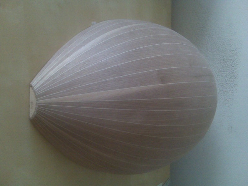

Finally managed to get the back scraped and sanded to 120. Looks good, it came out much better than I thought.
Here are some more pics...

That's some beautiful walnut, fantastic light grain streaks, just amazing. Can't wait to see it with the finish on. Way to go man !

Beautiful. I love the fact that you used some ribs with a bit of sapwood included. It really gives it some depth and visual interest. Beautiful work.
Did the problem you mentioned above resolve?

I didn't scrape it all the way down. I am worried it will get too thin. there is still about 0.3mm difference between the adjacent ribs. I am hoping that it will be smoothed out as I put the paper on the inside.

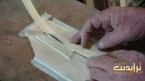

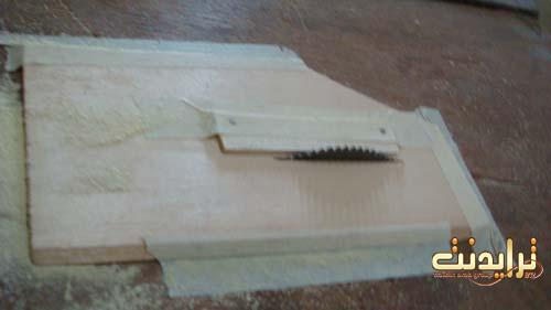

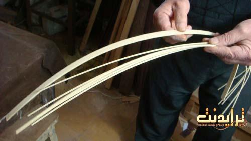

In the past, I saw an interesting way for which I am attaching the pictures taken from another website. This is how Thabet Albsry does it and it is quite interesting. The purfling is made from a bent piece of rib stock that is sawn using a small table saw with a thin kerf blade and a piece of wood taped to the side as a fence. If I had such a saw I would have probably done it that way. But either way it works.
