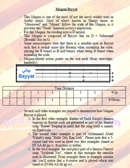

Going over maqamworld material I realize that there is certain numbers under each note of the maqam and I wonder how do you actually treat these
numbers, are these the comparative time one needs to take to let each note play before playing the next or is it the pitch playing each tome ?
Thanks for the clarification

there are just the intervals between adjacent notes (counted in fractions of a tone).

His Maqam Analyzer is a program (a spreadsheet actually) that allows you to enter info like root and dominant note, and the intervals (in quarter
tones). It then shows all the maqamat that fit the data you've supplied so far. You can use it to identify maqamat in existing music, but also to help
you "plan" improvisations.

Then as you study a maqam (there are about 100), video clips show the fingering and then examples of how the seyir or "path" is worked. A typical
maqam will include 3-4 good example taqasim.
