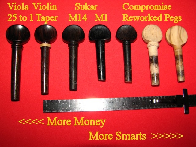

[*] posted on 6-5-2010 at 05:13 PM
I'm not sure how people manage with violin pegs, as they are short. Carpenter, I agree with you. Near the nut, with the pegbox at its widest, it doesn't look good to have those heads so close to the pegbox wall. It looks like missionaries in quicksand.
Lute and Oud pegs tend to have a steeper taper than violins and violas. It's "appropriate technology". Like other lower cost ouds, the Sukar Model 1's olivewood pegs use a taper around 15:1. Sukar's ebony pegs, on his high-end ouds, are 30:1, and look like modern pegs, longer than violin pegs, thinner than off the shelf viola pegs. They probably come from Turkey, where oud pegs grow on trees and are traded for produce. Edward Powell is revered there as "the man with SO MANY PEGS". :bowdown:
Anyway, in (theoretical) oud-making, there are two distinct approaches to pegs. The first approach, in which the village idiot is handed blunt garden tools, the proverbial square pegs, and told to "go make some holes for them", seems like a good way to waste some wood, until you realize that it's a compassionate "public works" program that's designed to fill the world with 100 quid ouds. The second, in which the village idiot is handed some heavy bags full of sticky brown cakes, pointed north and told to "walk until the people speak Turkish and trade the bags for Oud Pegs and Tools, then come home", has more complex objectives. Suffice it to say that method 2 involves shavers, reamers and other "dual use" goods that are sometimes difficult to obtain without some enterprising barter. Ouds made in connection with method 2 are easier to tune.
Tip: One thing I've found is that if you have a 30:1 (meaning ~ 25 to 30) reamer and adjustable shaver, there are other options. Rather than buy all new pegs and take a "tabula rasa" approach, you resign yourself to the notion that "if all else fails", you can always do that, so "who cares?". It takes that kind of attitude. You start gingerly burnishing and reaming (the holes) and shaving (the pegs), until you reach a compromise taper, not 15:1, not 30:1. This is where the yin and the yang equilibrate with your patience and your wallet, and the old pegs work "pretty good" :D
The important thing is to gently use the reamer, mostly in burnish mode, i.e. turn it counter-clockwise. It is a sharp and aggressive device. If you start out vigorously cranking the reamer, you will surely understand why the village idiot is never handed one, and you may remember the dreaded words of (I think) JDowning, something like "making a new pegbox is easier".
Img_8109mL4.jpg - 87kB
The available 12th pegs from a working oud are of course not as long as the virgin Viola and Violin pegs.
