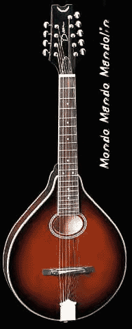

Convert 9-string mandola to fretted oud? Opinions, please
I have a 9-string mandola (sort of) thing sitting around that I'm not using. I was thinking of putting on a new nut and bridge to allow it to have 4 doubled courses and one single drone string. All nylon strings. I own a pretty nice Turkish oud and a cumbus, but thought this might make an interesting toy as I can stand up and play it with a strap. It has a 20" scale, approximately. It also has a flat back (no bowl).
Any thoughts or predictions as to how this will turn out?

I doubt it will work very well with nylon strings, mandolas are designed to resonate properly at rather higher string tensions than nylon will provide.
That said, it is an interesting experiment, unlikely to do any harm, and you won't know unless you try it.

I would prefer to make it with single strings and metal strings.
I also would do it fretless....
Where did you find this mandola?I am looking for something like that....
All the best
Spyros

Fretted Oud???
I think the essential part of the sound production of the oud is in the fact of beeing fretless
Of course you'll get another sound with nylon strings and that might be interesting in itself ... this you should of course find out for yourself.
But I don't think you'll come anywhere near to the sound and character of the oud
Why don't you get yourself a nice simple oud?

I found it used in a music store in Austin. It's called a "Mondo Mando" by Dean and goes for about $280 new. It's meant to be tuned like a guitar EADGBE with three courses and three single strings. The build quality isn't bad but I don't find it's tone to be that great. I don't feel like I'm risking much by converting it. At the very least, It could be a way to practice right-hand picking technique while standing up and walking around. It's quite comfortable with a strap.

I agree with Brian about the sound you'll obtain with low tension ( nylon strings ). Mandolin, mandola, mandocello, citterns are built to resonate under high pression of metallic strings. Braces are very strong ( often crossed under the table ) and spruce top is thick. I already tried to do the same with a greek bouzouk , after I shorted the neck: The result wasn't absolutely bad but the sound was poor and with no sustain or projection . However bouzouk body is more close to the oud than mandola.
It can be rich with a banjo, because it's possible to have an action on the skin....
Just my experience ....
