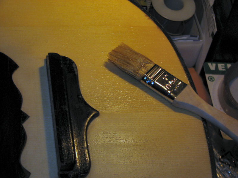

Anyway, egg white sounded good. I was especially drawn to Dr Oud's description as "almost invisible". You can't botch the invisible. You would be surprised. See photo 1, entitled "idiot at work". This is how not to do it, in the mistaken belief that it will all ... evaporate? Well, of course it doesn't.
If your oud face looks like baby's head in the tub, you are foaming it too much. A brush is not the ideal tool. What happens next is that all those soft streaks dry into hard streaks. The surprising thing is how resilient the stuff is. Oh, sure, you can remove it. Hope you didn't forget to put masking tape around the periphery.

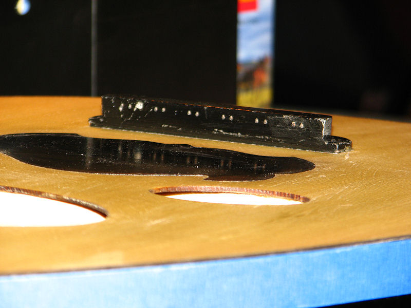

The first coat is sucked up by the wood. As you blow dry it, remember you are not making an omelet, or trying to unglue the braces. Keep the hair dryer far enough away to simulate warm desert air and not cook the oud. If you want to let it dry overnight, be my guest. When it turns crunchy you sand it with that 600 wet/dry type black stuff. Then slather on another coat. Be careful that the pick-guard or bridge doesn't bleed color into the light colored wood. Dry it. It's getting shinier. Sand it. Another coat. Dry it. Maybe another.
Now comes the part where you have "options". You can finish it more or less glossy. Or, as in my case, a bit of both. The easiest result to achieve is camouflage glossy: islands of shine with isthmuses of matte. This is where you wonder if you shouldn't have kept the yolk in with it and made an abstract oud. This is also when you ask yourself why you started on the whole stupid project in the first place. Do not despair. You can always drive down to Home Depot and buy a cheap sander, and thin your soundboard. You can then return the sander by saying the cat's fur kept clogging the mechanism (but you cleaned it), and get your money back.
Or you can show a little manly patience, sand it lightly one last time with the black stuff, then apply a lot of so-called "elbow-grease" with something like a "plastic steel wool". It's not all that slow. I've been able to do one oud an evening. Here is where you come to appreciate what the chicken wrought. The albumen has saturated the wood and turned it crunchier. A tiny step towards the famous petrified forest. It's actually a decent sealer, and not as absent as one might think. You can polish it to a lovely satin. If you are very very patient, who knows? maybe even a lovely gloss. If you are lazy, just sand it evenly to an "almost invisible" matte, forget it and move on with your life. Photo 3 shows the satin look. I think it's cool. Now I won't have to worry so much about drooling while I play.
It's not as effective as Scotch Guard, but it's easier to keep clean than virgin spruce. A drop of water turns the finish matte, but a little rubbing with the plastic steel wool brings back the shine. I had intended this as a first step, to be followed later by French Polishing, but I will leave it this way for a while, knowing full well that "for a while" can easily turn permanent. Still, I know this is not sufficient protection against stains. I'm hoping it will make French Polishing easier. Fortunately it looks nice for now ...
