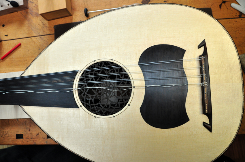

I'm trying to figure out, which string would suite as a single deep A medium tension bass string for my new Sebastian Stenzel 7-course oud.
I tuned a Daniel Mari C- String down, and it works somehow, but is to flabby.
Any suggestion appreciated; best wishes
Robert
